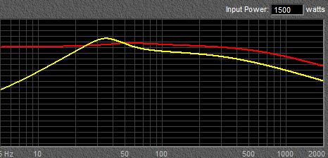

2x 12W7 driven at 750rms each or 4 Old School circular 15" Kicker solo barics driven with 375rms??
the Solos by design would have to be in sealed enclosures, the JLs could go either way in my application depending.

Red - 4 solobaric S15C (round solobaric from mid 2000s) in a 6 cubic feet net sealed box, D4 subs coils in series subs in parallel. Final load 2 ohm.
Yellow - 2 JL Audio 12W7 in a 4.5 cubic feet net box tuned to 33Hz 3 ohms single coli subs wired in parallel. Final load 1.5 ohm.
For a constant power amplifier such as Rockford  Fosgate HDCP amplifiers:
For a non constant power amplifier the lower final load option will be at an advantage.
As ti stands the 12W7s are louder in the relevant range, say 28-45Hz.
