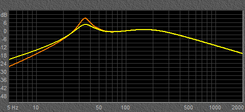

Here is the U12 v1 in orange without damping and in yellow with heavy damping:
Box is 2 cubic feet net per driver @ 35Hz.
As you can see you get a sharp drop in the peak and a somewhat softer rolloff, additionally it doesn't change (up) your tuning as cutting volume would do.
If you are not listening to lower frequencies enough then just tune lower as needed..
