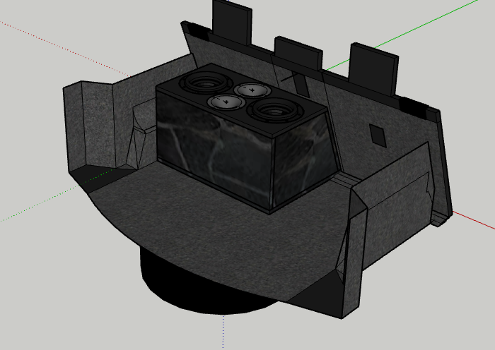

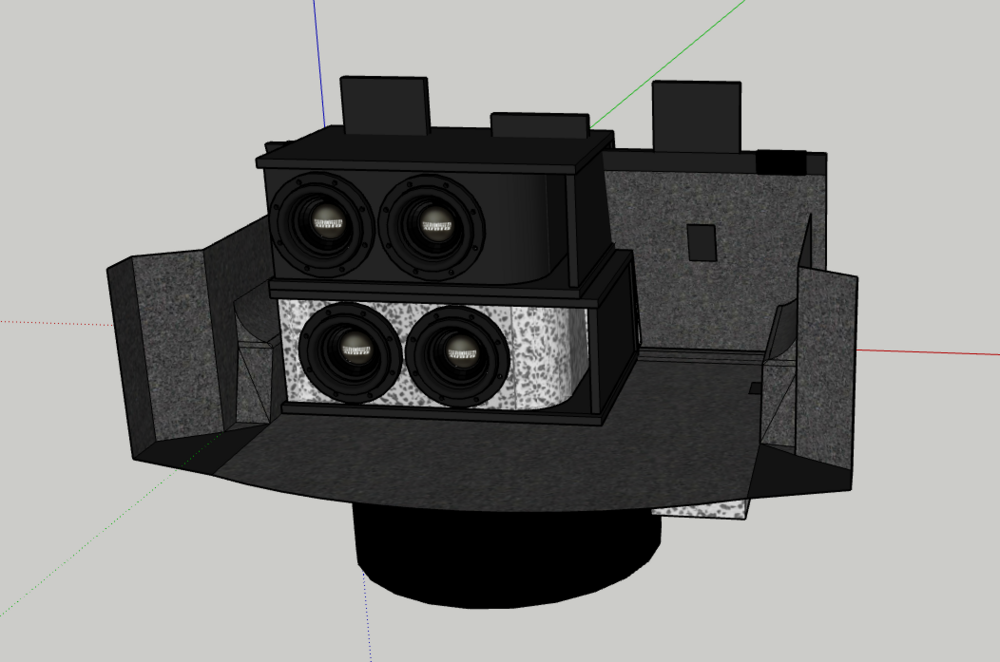

Hey Guys, I appreciate everyone sending me Subbox pro Designs using the specs from the website. That's essentially where I started and the Box was taking up too much space in my rig.
By adding a wedged back to for to the seats, I gain 2-3inches of trunk space, and add .13cuft (the displacement of one driver) back to the box.
So I've made a few compromises!

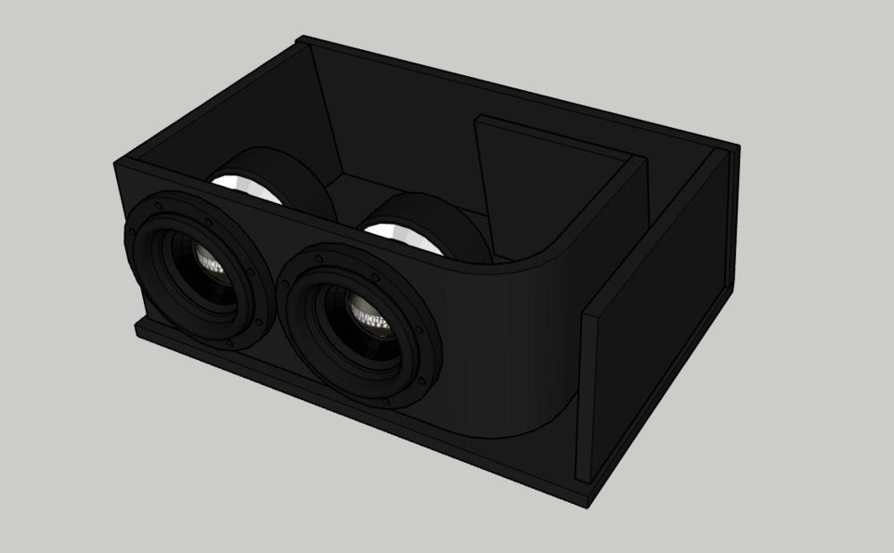

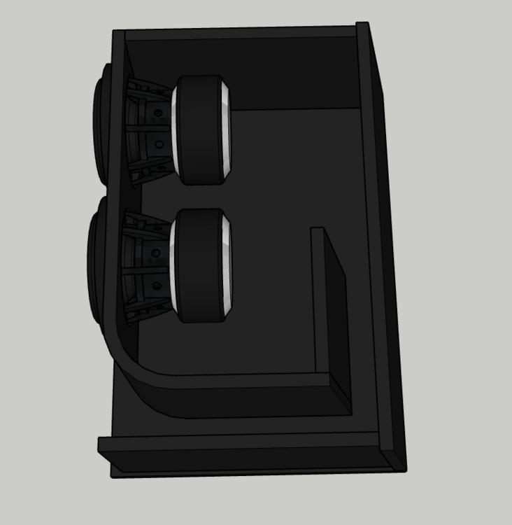

I'm only going with 2 subs. My buddy wants the third for his truck, and a 2ohm load of 2000w is a more Ideal match for my amp. So here are my newest renders.
At the Bottom is a 32hz option with all factors the same excepts size and a couple disclaimers. Any Pro's and cons of 39hz vs 32hz would be appreciated.
1.88CuFt Gross (1.62cu Net ) or .81cuFt per sub
3/4in MDF With Kerfed Port
Tuning - 39Hz
Port Length - 28.02"
Port Area - 24sqIn
Port Width - 2.52"
Kerf Fold Length - 4"
Kerf Fold Width - 2.50"
Thinking I will round the hard edge of the port on the right as well as the opposite corner, since kerfing on an angle is impossible, at least I think it is.

Whatever happens with your car audio project you will end up a sketchup expert!
As for the question, high tuning makes you louder but less able to play properly certain types of music like rap and such, more so with small woofers which usually struggle a bit more with the lower notes BUT if you play madonna or classic rock you are not affected by higher tuning.
If you listen to all types of music you want a tuning in the lower 30s, when space is concern I always suggest 34Hz, it plays very much like 32Hz but saves a lot of box volume due to the shorter port length.
You should also factor in what is the proper port area for the power you are using which seems to be above rated now that you left one sub out, Maybe 12 square inches per sub will be enough or maybe not, one needs to see with modeling software, sure enough with that kerf you will avoid most port noise but overall port efficiency gets impacted by port area.
Really when you are trying to do a small box is when a design becomes challenging, One needs to pick the right compromises, sometimes it's better to lose some space, I say a wider box doesn't hurt the usability of the trunk. As always this is just food for the thought.

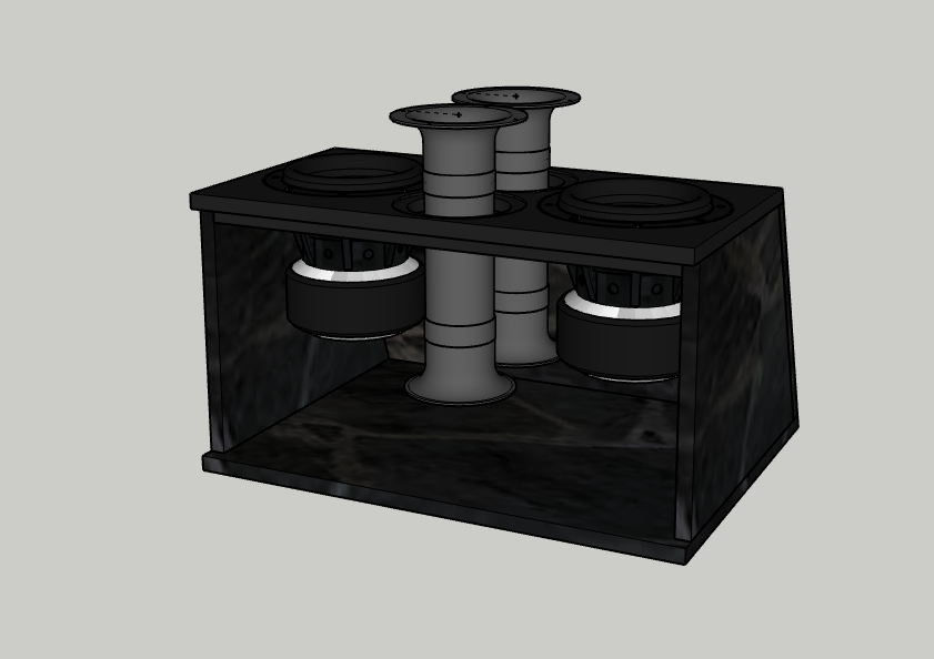

Another Idea I had involving Aero ports
I honestly have no Idea how to calculate aero ports, so I copied this box from ebay and modified it into a wedge.
The only Issue I have it that the ports are too close to the bottom of the box.
I'm thinking about either throwing some 45deg adapters in or running the ports out the right side
The other issue is that I am trusting an ebay seller, hoping that dual 3" ports @ 13" each tunes the box to 32hz.

The problem with that is that two 3" ports have 14.1 square inches of port area, not nearly enough for two subs so you will likely get port noise when pushing more power.
looks like I would need 2- 4" ports then. Thank you everyone for your input and help. I think my next post will be a new thread in the project log section. I'm still a long way from installing anything into the car, but I'll be doing the
