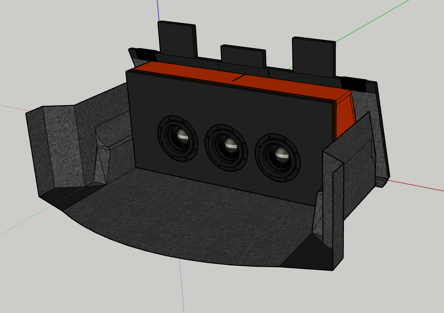

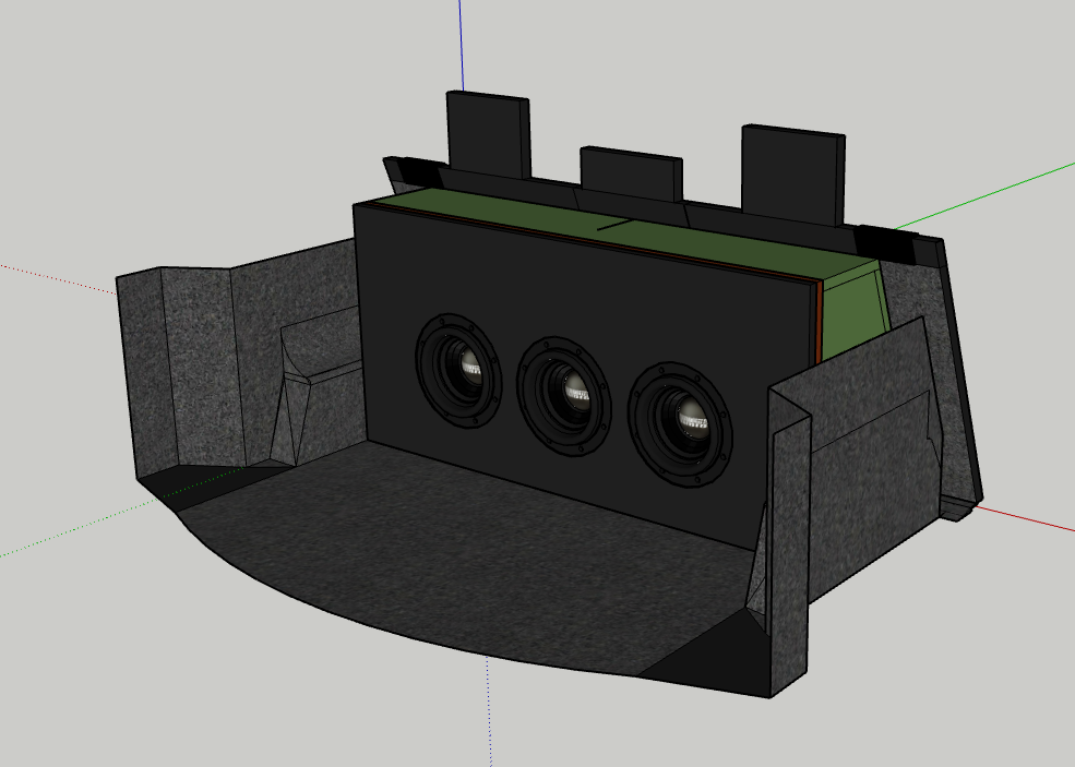

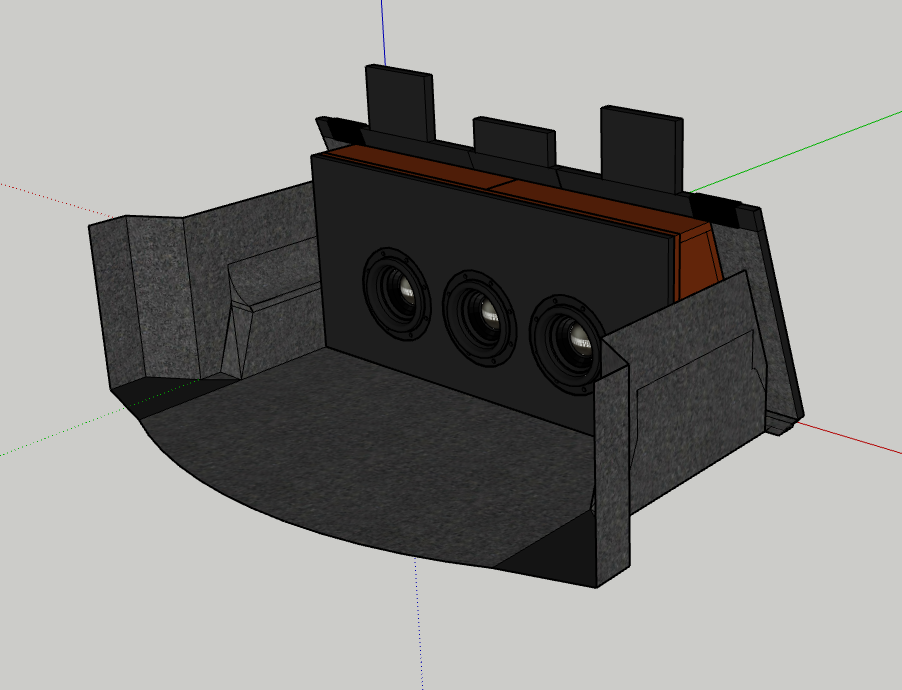

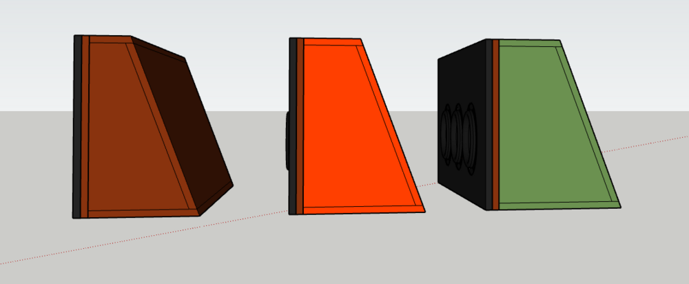

Did Some work on sketch-up and did a little math.
Came up with three wedges, All measure 19" (H) X 41" (W)
3/4 " Plywood and double baffle but no ports yet
The Smallest -
12.75" deep / 2.74cubes (2.35 with displacement)
Obviously I haven't factored in bracing or port either. Hoping to find out how much i need and adjust the design
Medium:
14.75" deep / 3.52 cubes (3.13 with displacement)
getting closer i think
Large:
15.75" deep / 3.97cu (3.58 after displacement)
what are your guy's thoughts?

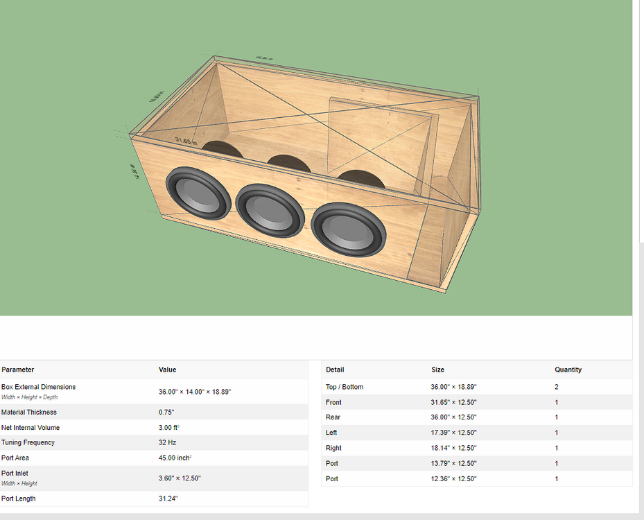

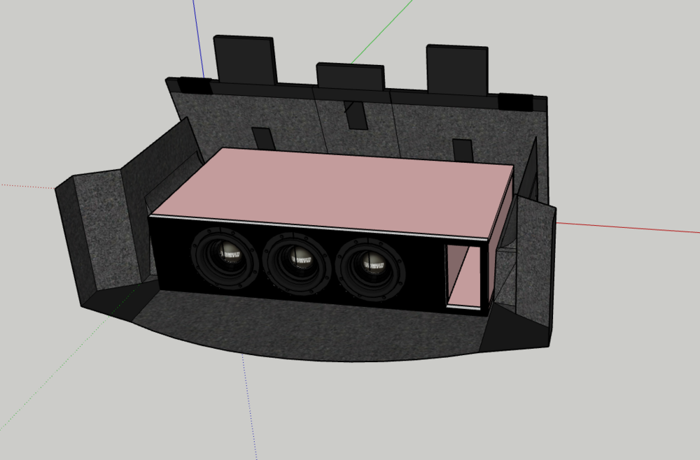

Decided to make one more "conventional" box before I call it a night.
41" L x 10" H x 22.85" D
NET 3 cu ft
36 sq in of port
tuned to 32Hz
port inlet 4.23" x 8.50 " x 24.22 Inches Long
This box just feel like it takes up so much more of my trunk, although I haven't accounted for port area on the other models
Nice sketches, in my opinion:
1) use the last box style as it will be louder due to the subs being closer to the rear end of the vehicle, use double layer baffle and a lot of bracing as these are higher end 8s.
2) use a constant power amp of the power you intend to run including the Sundown SIA series or just get a more powerful amp so that you can still get your desired power at 1.3 ohm, power is cheap these days so that shouldn't be a problem.
3) call Sundown for box specs or wait for them to come out before building anything so that you don't have to rebuild a box.
Great work, hopefully you will build log and review those subs, should be interesting.
i also vote for last box design
3x x8's should be p retty dang loud i ran 4x e8 v6's for a while on 2 x 1200w amps and they got loud if i had to guess id say a solid 145ish in my car i never did get that setup  metered before i went to 3x 12's in the trunk and then 5 12's in a flatwall int he same car
my e8's were in a 4cft net box with 36inch of port area tunned to 32hz
bassed on v3 specs im going to guess ur going to want 3cft net and about 46sqinch of port , though u have room to play with port area , less sqinch of port = less port lenght so u can use that to play with ur box design to get it to fit int he car nicely , i would stay within the 36-50sqinch's of port though andthing smaller then 36sqinch is likley to have port noise
Ok cool, I’ll mess around a little bit with the design. If I can get the box slightly shorter to line up with the wheel wells I might do that.
