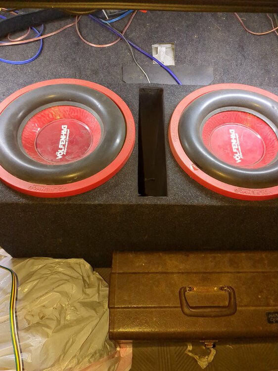

 My current setup is ported as you can see from the attached picture
 But the boxes rather flimsy. You know it's just a typical cheapo a trend standard ported box that is all over the internet and sold on the many different names made with the cheap particle board like material and If you ever heard of or seeing the old school subs that I have. They are fairly heavy so you can't really turn the box sideways because they will blow right out of the box in no time and be falling out of it. So that's why I have it facing upwards. But it still seems like they've gotten loose from the box already and it's only three or four months old. I've already replaced the box three times for those same subs.

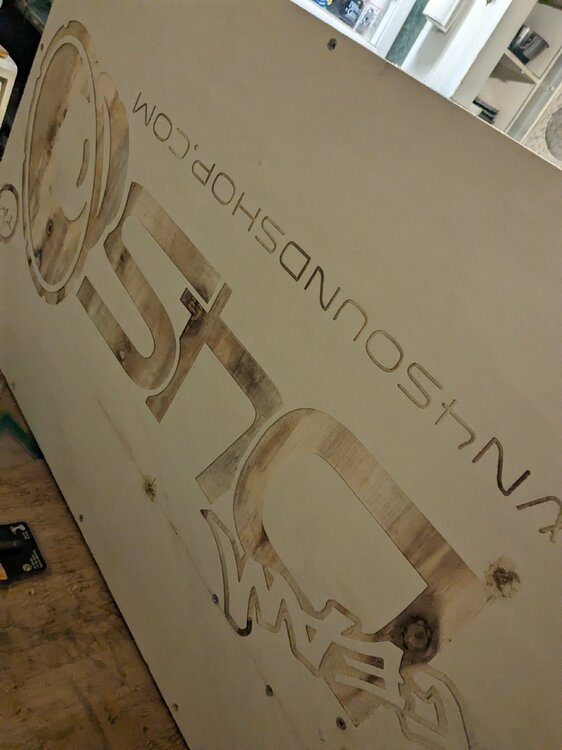

Also went with a Birchwood cabinet that I will be putting together myself now it's not quite the setup that The guy with the custom Vicks does, but I figure air should still escape and it will sound a lot louder than previously. And the trunk will be able to breathe which hopefully less rattling.
As far as the amp, I have not upgraded yet, but my plan is to get a 2400 watt RMS monoblock at some point I figure right now the 1500 should be enough during the break-in to play the speakers without really damaging them.
The only thing I'm unsure of about the birch kit is the fact that the hole might not be cut exactly so I might have to trim. But I figure real Birchwood should be far superior to the a trend. MDF that's out there and I shouldn't have any problems with The woofers rattling loose or the screws becoming loose that hold them down

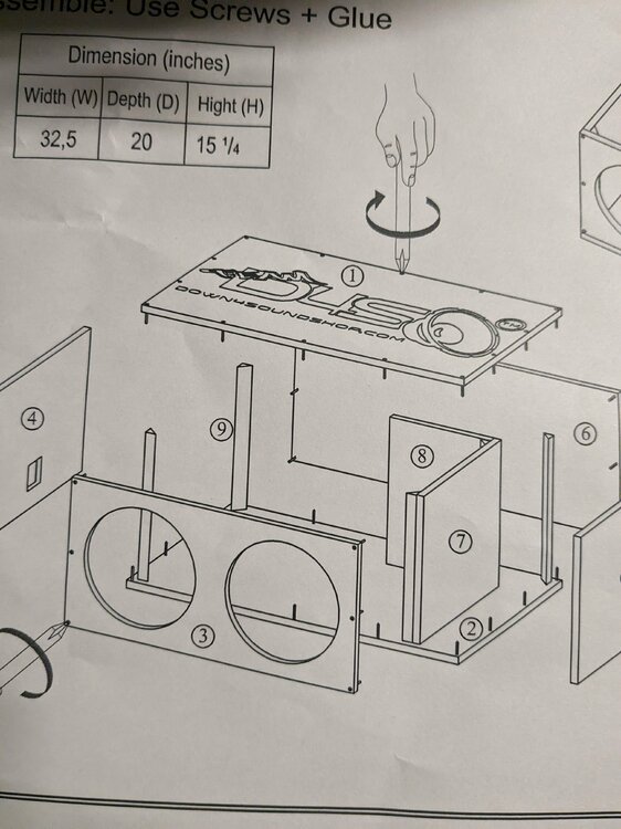

The only thing I don't understand is the plans for the box which is a flat pack kit kind of a show when the images what looks like pieces of molding that appear to go into the corners probably for extra stability and strength. However, the kid didn't come with any.
Now should I be going out and getting some type of bracing? Whatever I can find at the local store possibly pine trim and gluing it to the corners for extra support or is that not really needed.
I wonder if that would ruin the sound quality of the Birchwood by adding a couple strips of pine to the mix or whatever they sell at the local hardware store to the corners like the image shows Or is the difference neglible because it's just a couple of strips.
As you can see from the schematic in the image, it looks like small pieces of trim go in the corners for extra  support of the box
Also wondering if at the very least I should add some silicone caulking in all the seams in the inside  corners before I seal it up

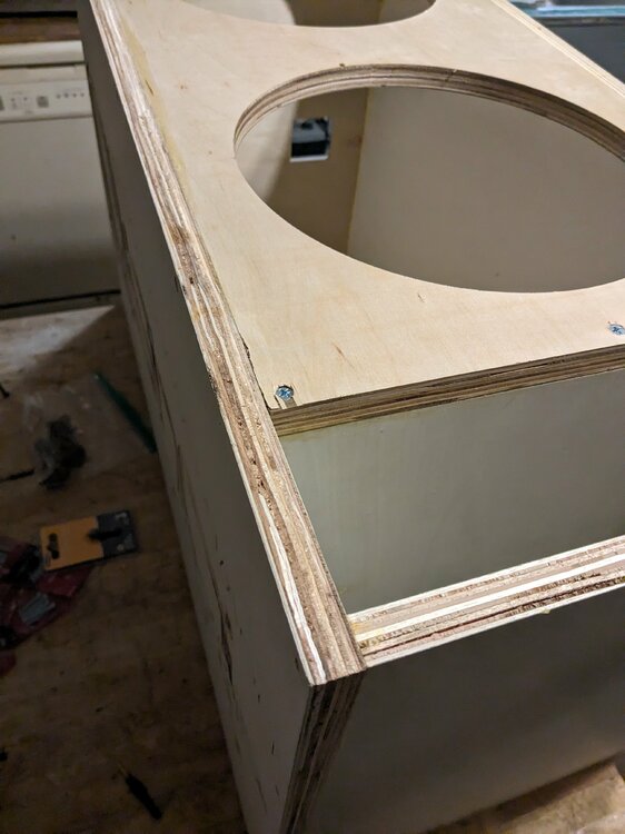

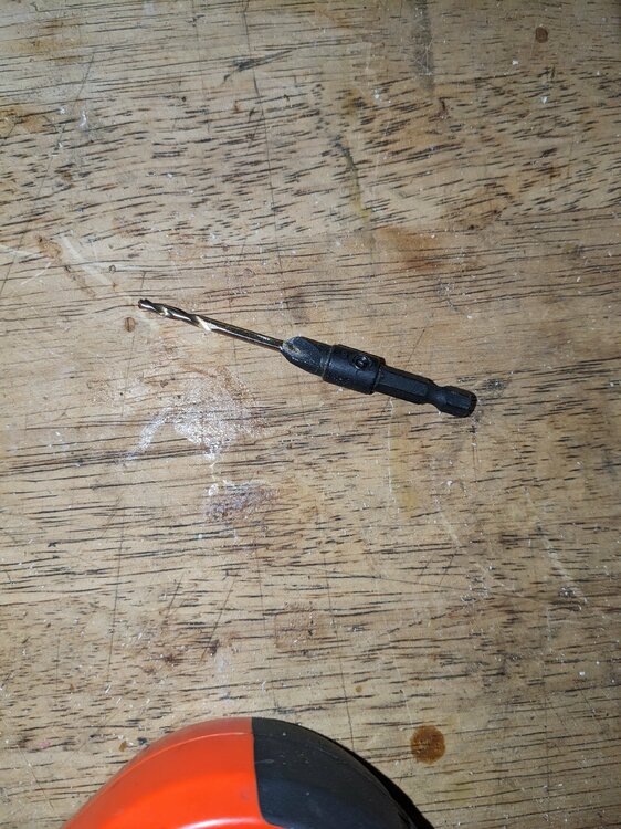

Well I completed the project of building the box. I am almost upgraded. I have to install the subs tomorrow and I got the box mostly together and solid and everything seemed to line up pretty good. I don't think anything will rattle loose I'll attach a picture.
All in all, the flat pack went together pretty smooth.
You got a couple of factory pre-drilled holes that get in the way other screw holes which are on the corners where they meet. So you pretty much have to drill your own hole off to the side a little  so it doesn't intersect with another screw from a different side of the box.
Also, there was a review on the flat pack box kit where someone said that most standard subs wouldn't fit into the holes that were pre-cut that you would have to trim. While I can assure everybody that the EVLs fit in perfect, no cutting required or extra fitting. The guy in the video might have had an off-size sub or they remedy the problem and revised the kit from the factory.

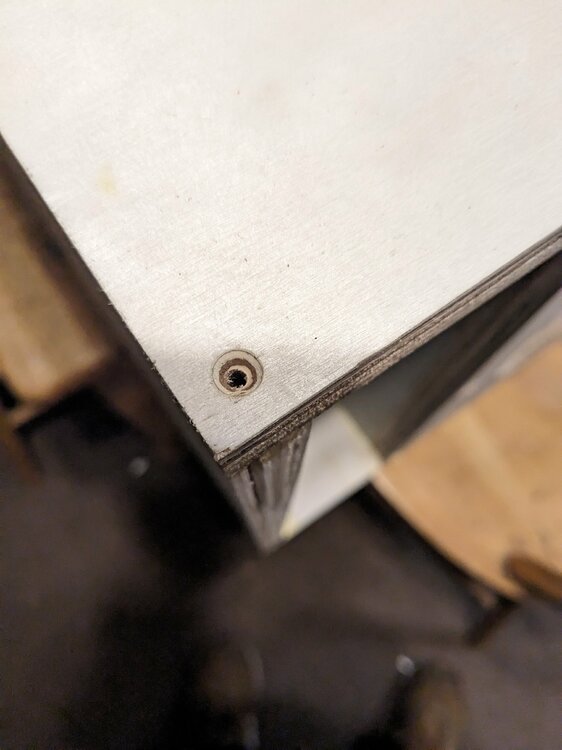

Also, countersinking is important pre-drilling holes along with the pre drilled holes that they have because they don't go deep enough into the other piece of wood they did not add holes to the side pieces . Can't stress that if anyone's trying to put a box together. If you don't pre-drill the holes to completion, you will crack the wood.
I managed to only crack two areas with a screw because I forgot to pre-drill one hole and the other hole it missed because when you install the port when you put the top over the box and screw that down you can't see the l shape of the port that good so it's harder to line up the screw holes. You want to measure, check then remeasure double check. Make sure any hole that you're going to drill is lined up in the right spot so you don't have that problem You want to avoid any cracking.
I could have just glued all the joints together but I also used screws.
For this kit you probably want to use a #8  1-1/2 flat head Phillips screw The one I used was from the typical big box hardware store and it was zinc coated I ended up getting a box of 100 because that's all they had and that size they didn't have a box of 50 but you need at least a box of 50 of these.
Now all is that's left for me to do is to get some ring terminals for the speaker wires and to install the speaker box terminal to the side of it. Then I just have to install the subs which I got number 10 screws for that and I got 1 and 1/2 and also 1 in. I think one inch seems more appropriate and not too long  so I am going to  use those to secure the subs panhead Phillips sheet metal those are also, zinc coated.

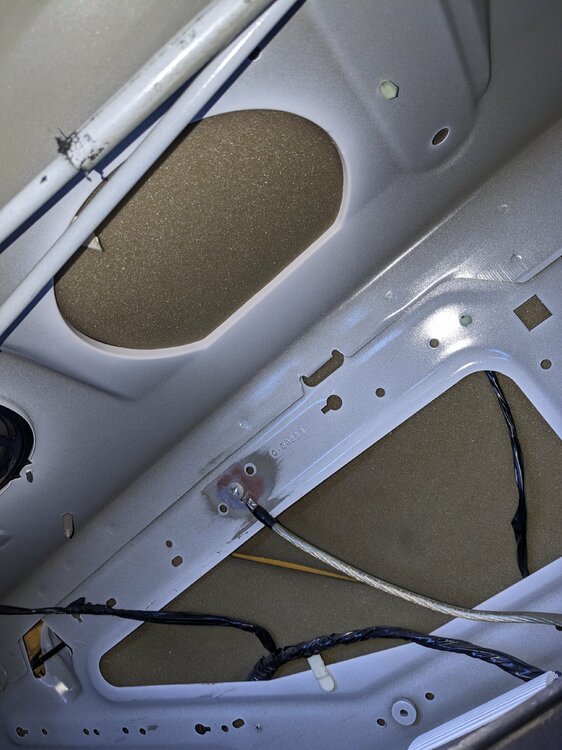

Can't wait to see how they sound tomorrow. I also have to cut a hole in the upper trunk deck to let some air out into the cabin
As long as you have used glue rather abundantly and left the box alone enough time for the glue to dry completely you should be fine, the parts come already cut so caulk or other stuff to patch up holes should not be necessary.
EVLs motor is not that powerful or the subs need that much port area so I say that even if the box is prefab it should do fine, 4 cubic feet net and about 50 square inches of port area should be enough.
You should leave the 6x8 speaker slots in the rear deck open and open a big hole in the center and hope for the best.
