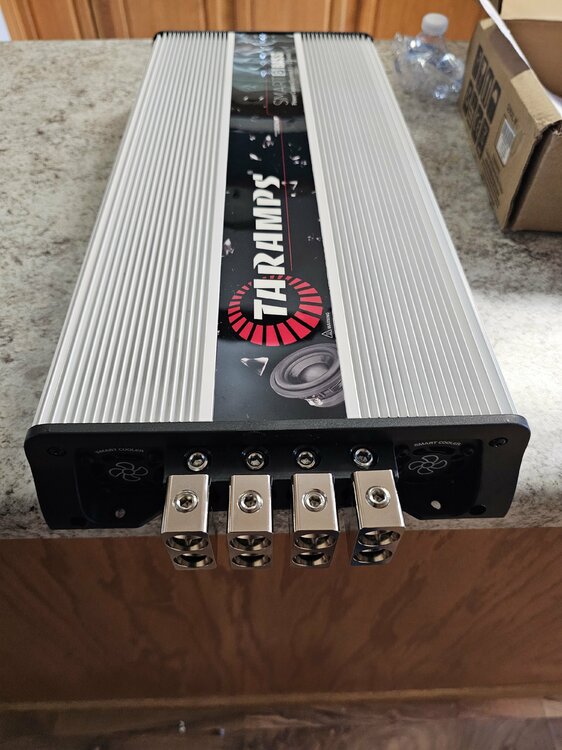

I will be running a Taramps Bass 8k on them, with solid electrical. I listen to rap/rebassed music alot and I love the lows.

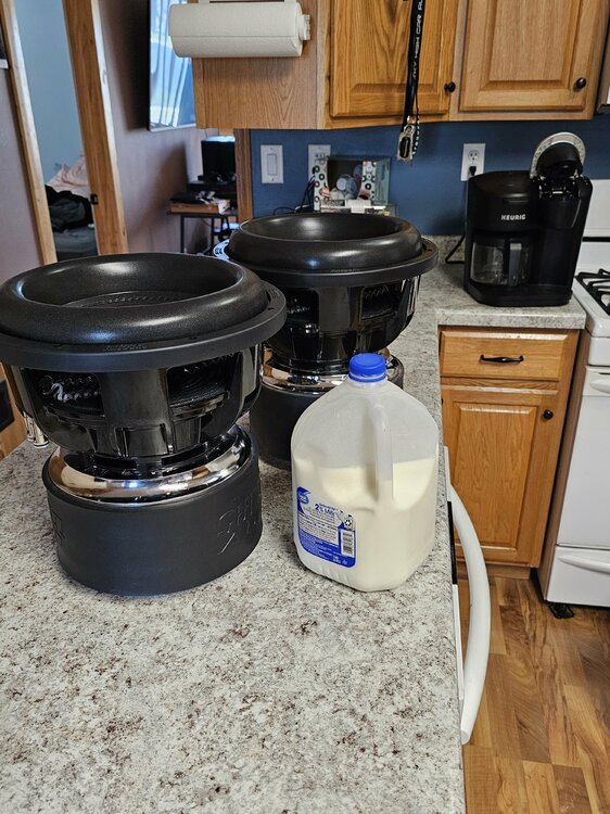

I ended up going with Sundown ZV6 12s d1s. Still on the Taramps Smart Bass 8k.  The Subs should be here within the week.

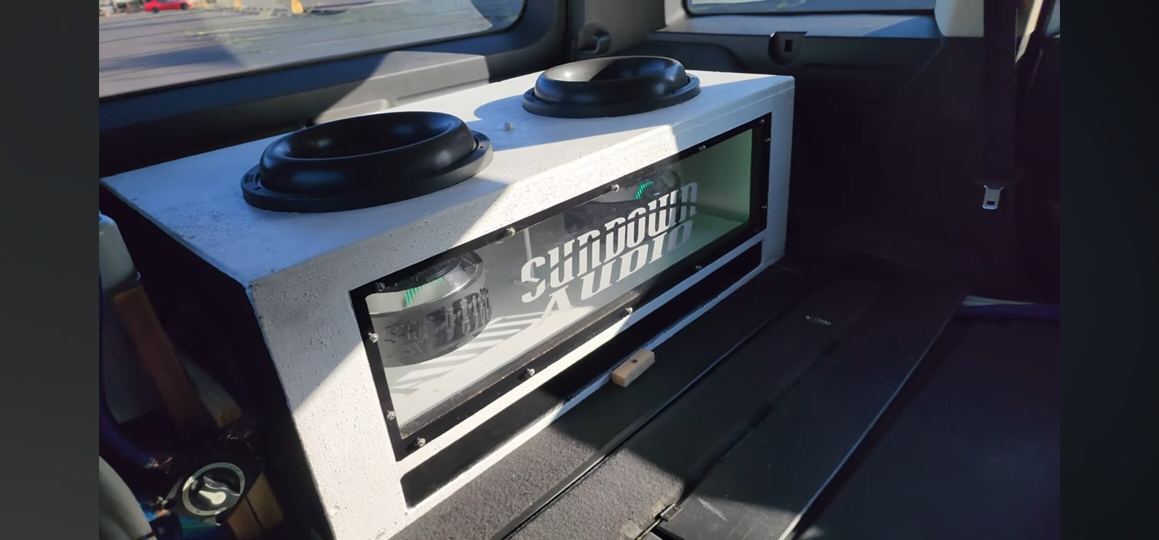

Still looking to make a box, I found a box a guy has on YT, just don't know the dimensions and his box was for xv3s. I wanted to make a simulator box, I just need someone with more know how than I have to design it, since ports aren't my strong set, so I can build it. I'll attach. A picture of the guys box. I have 38" Wide, 21" depth and up to 24" height I can work with, I have more depth available but wanted to leave some space between the port and rear hatch door so the port has space to do it's thing.. I'd like to have a box that is 5-5.5ft^3 with the recommended port area of 38sq in per sub. Tuned to 32hz.

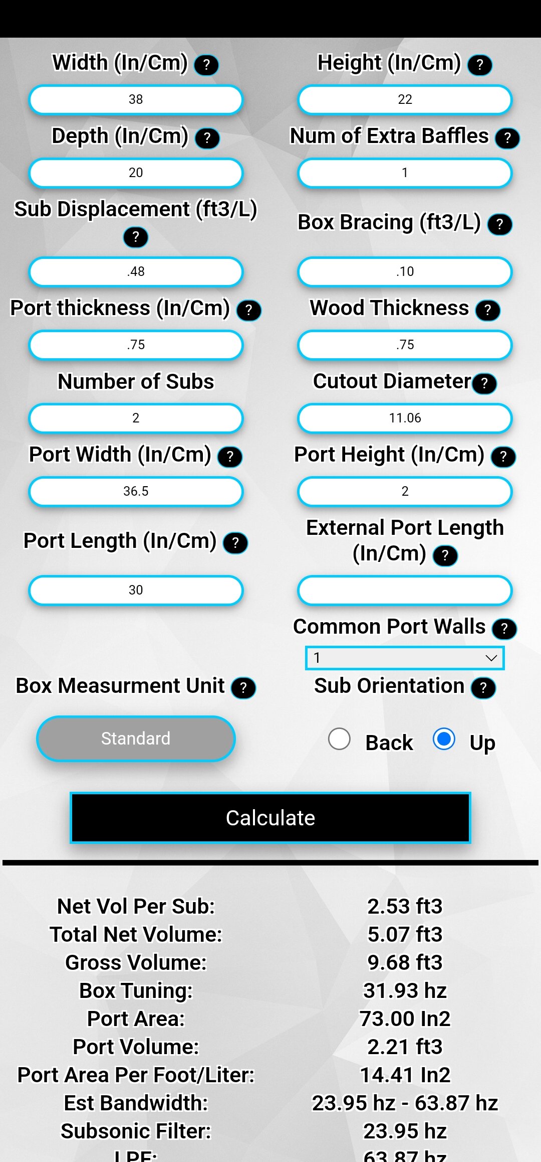

I used an app on my phone to get a rough idea of a box, I'm just not 100% sure, I did the port part right. I'll attach a screen shot of that as well, if you'd be so generous as to give some insite please.  In the app, I only accounted for a double baffle, not sure if I should make the entire box 1.5" thick or just the baffle.

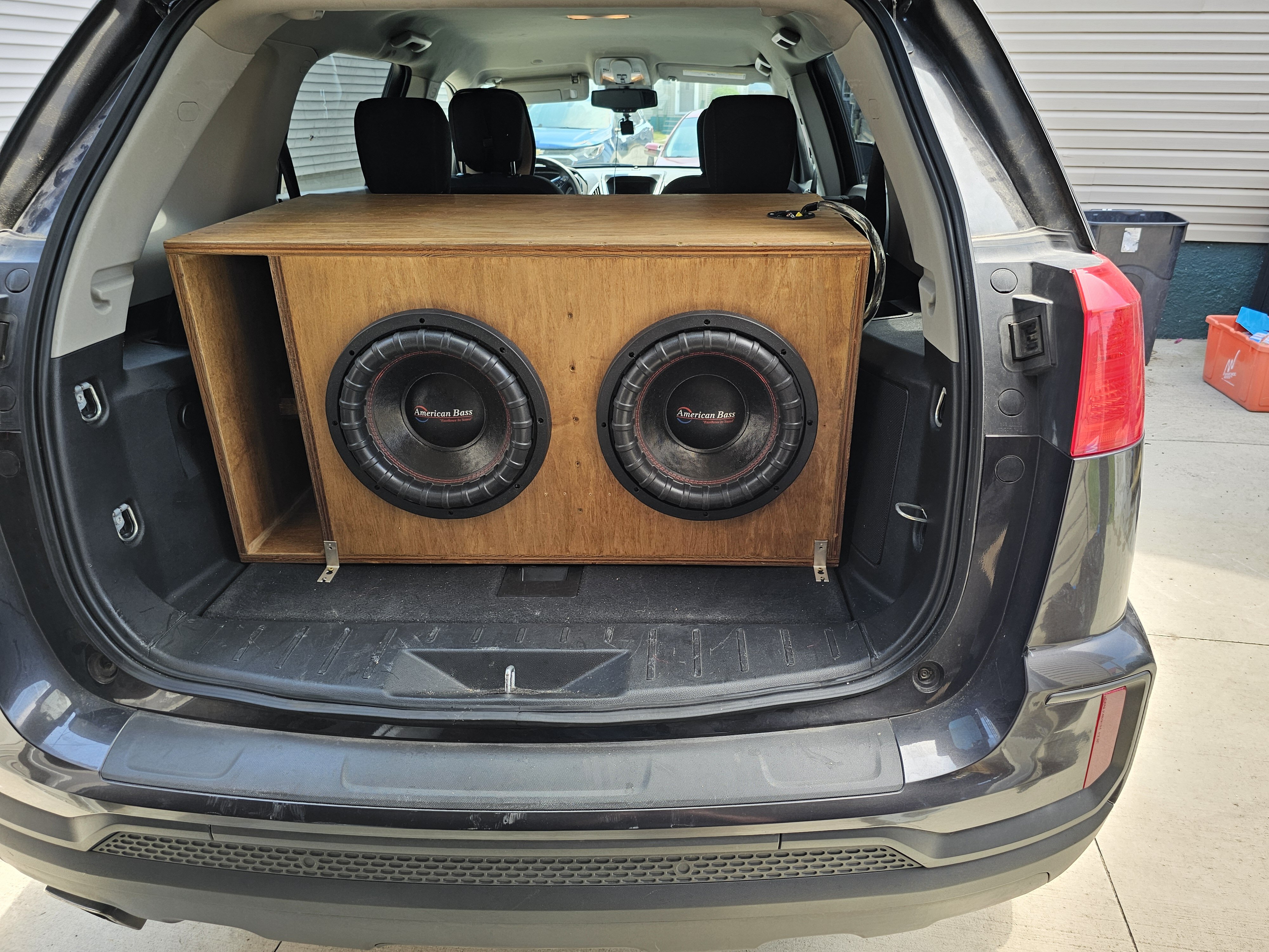

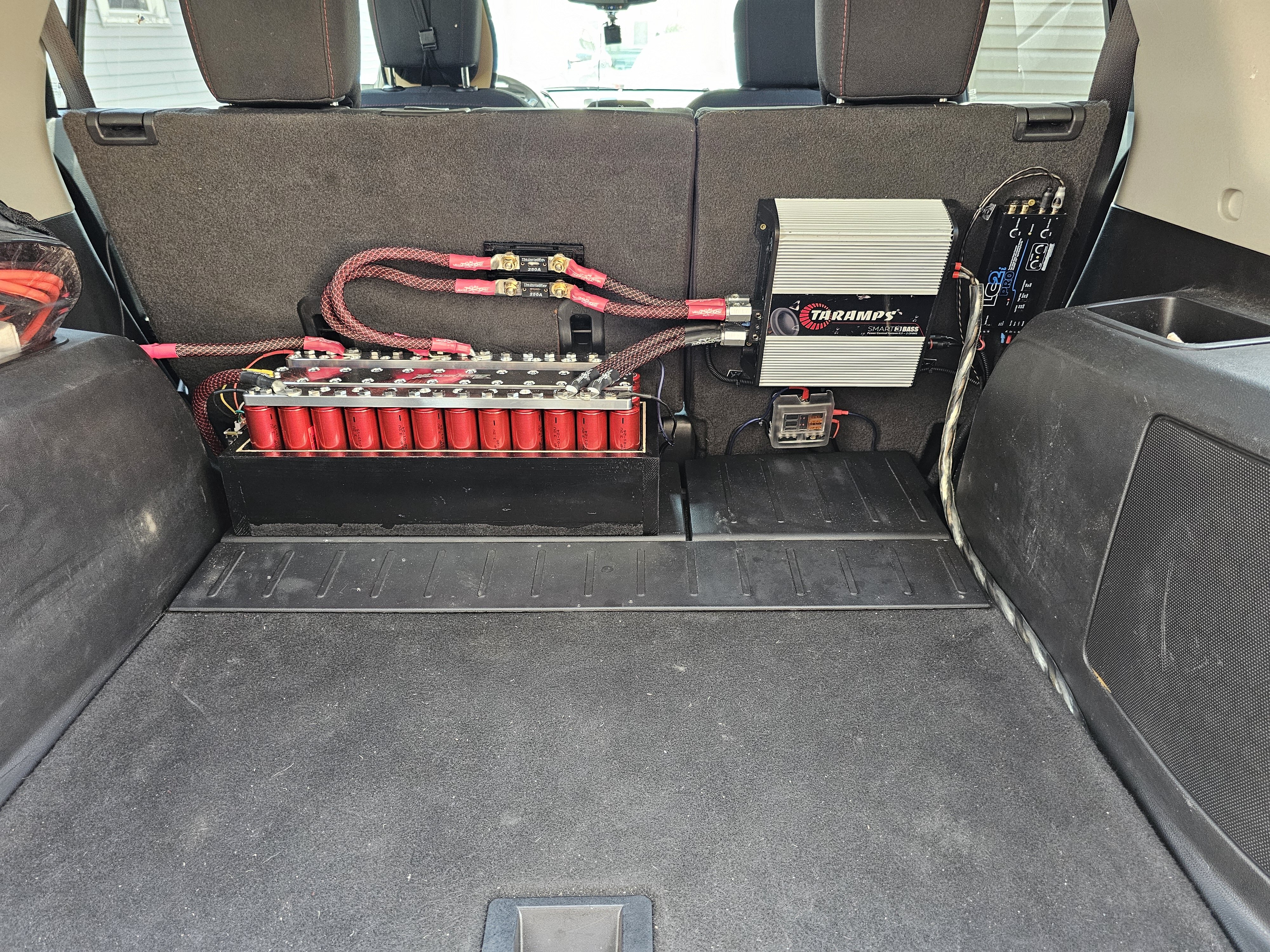

This is my current box and subs, box is 38x20x20.  Just wasn't enough lows for me. I Made the box out of some maple plywood.. The amp is mounted to the rear seats behind the box as well as the lithium bank being behind the box. These XFL 12s, I only had on a Taramps Smart Bass 3k and 96ah Headway bank, the bank is now a 128ah, my Alternator is a Singer 300ish amp.
