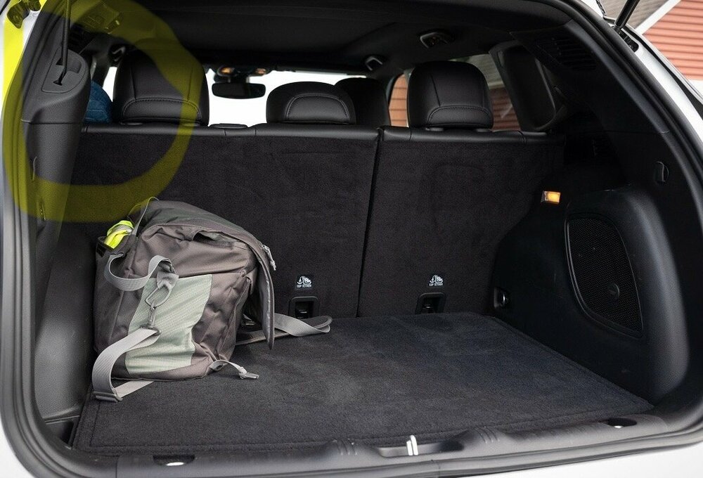

Vehicle: 2023 jeep compass trunk

Sub up, port back on passenger side of vehicle
Max space available
Width 35”
Height 19”
Depth 21”

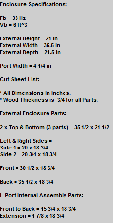

7 cubes net not possible on those dimensions, I am sure you can go wider and taller in that vehicle, preliminary calculations shoe a maximum of 5 cubic feet net is possible for a double layer box and about 6 net for a single layer with double layer baffle is possible (heavy bracing).
They added this plastic piece on interior for 22+ model that interferes starting at 17” height if width exceeds 35.5” can’t squeeze any more out of it. 35” width clears it though. Single layer double baffle around 6 would be great. Thank you!

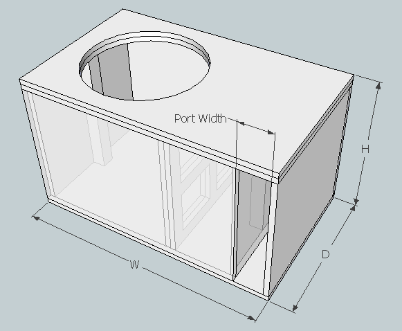

So here is a suggestion, power: to sub rated, amp subsonic filter to 28Hz, minimum port clearance 4 1/4", figure is just an assembly guide:
