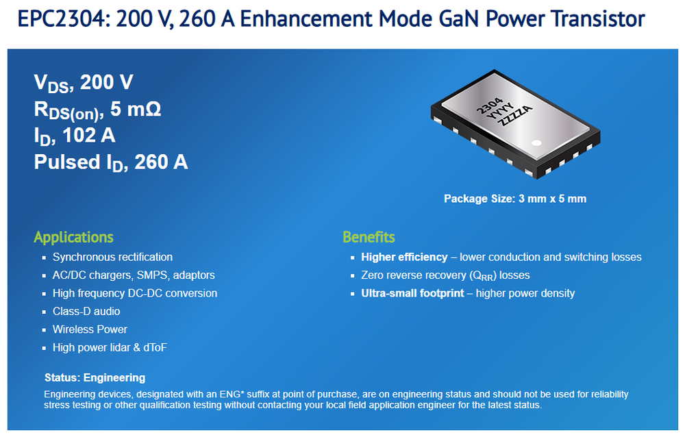

JasonRichardCraig Posted September 23, 2024 Report Posted September 23, 2024 Has anyone thought of developing an amp using GaN? Gallium Nitride’s exceptionally high electron mobility and low temperature coefficient allows very low RDS(on), while its lateral device structure and majority carrier diode provide exceptionally low QG and zero QRR. The end result is a device that can handle tasks where very high switching frequency, and low on-time are beneficial as well as those where on-state losses dominate. It is a HEMT (High Electron Mobility Transistor) that can Switch at 10MHZ 200V/ 260A (each transistor).... https://epc-co.com/epc/products/gan-fets-and-ics/epc2304
JasonRichardCraig Posted September 23, 2024 Author Report Posted September 23, 2024 26 minutes ago, JasonRichardCraig said: Has anyone thought of developing an amp using GaN? Gallium Nitride’s exceptionally high electron mobility and low temperature coefficient allows very low RDS(on), while its lateral device structure and majority carrier diode provide exceptionally low QG and zero QRR. The end result is a device that can handle tasks where very high switching frequency, and low on-time are beneficial as well as those where on-state losses dominate. It is a HEMT (High Electron Mobility Transistor) that can Switch at 10MHZ 200V/ 260A (each transistor).... https://epc-co.com/epc/products/gan-fets-and-ics/epc2304 @SteveMeade Just one of these (3mm x 5mm) can put out over 20000 Watts from DC to 400,000Hz.
