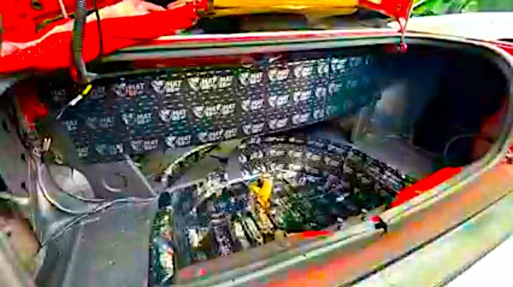

Since this photo, the trunk has fully been covered, first with second skin, then with 80mm sound deadening mat.
