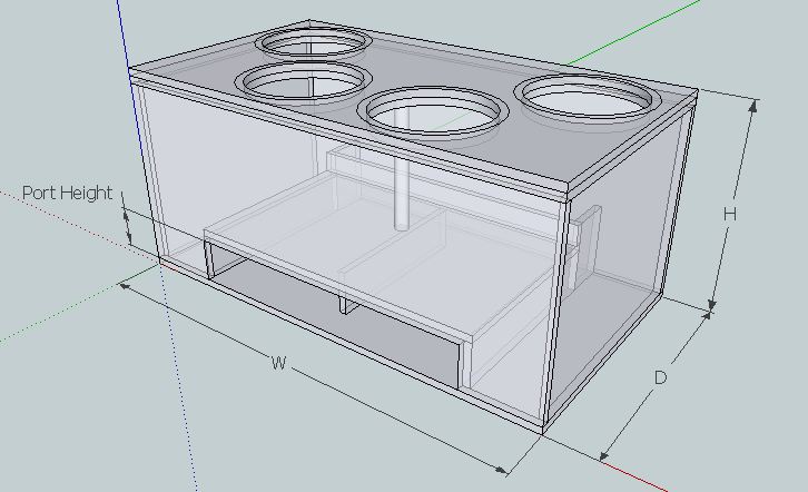

lionfamlee Posted October 18, 2024 Report Posted October 18, 2024 Hello, several years ago, I built a really nice sub box with the help of forum member Joe X. He created a box for 3 15-M3MOJO12's (12's). That box he created was excellent. Below is the discussion. I am trying to build another box. This time for 4 of these same subs. My only limitation is the width needs to say within 48 to 49 inches in length (2008 Chevy Suburban). MI don't want to spend all of the money on prefab box. Thanks in advance, Michael
Joe X Posted October 19, 2024 Report Posted October 19, 2024 That was a little while ago! A few reminders: If you are adding a new sub to 3 old ones you need to break in the new one before using all 4 in the same box. You need at least 5 1/4 inches of port clearance to the rear gate for the box to work properly. So here is a suggestion, power: to sub(s) rated, amp subsonic filter to 28Hz, minimum port clearance 5 1/4", figure is just an assembly guide:

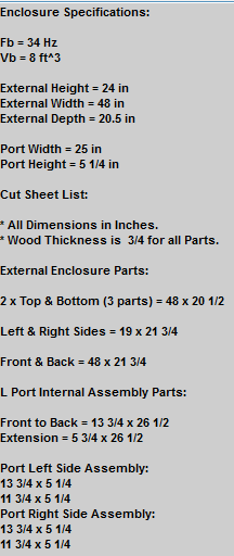

lionfamlee Posted October 21, 2024 Author Report Posted October 21, 2024 Joe X, is it possible for me to adjust the the box height from 20 inches to 24 inches? What other adjustments would I meed to make. It doesn't look like I can subtract the 4 inch difference from the depth, because there wouldn't be enough surface space to fit 4 subs. My amp and accessories wall is 24 inches high. So that's why I am asking. I plan to mount the wall in front of the box. That way they would both be flush.
Joe X Posted October 21, 2024 Report Posted October 21, 2024 Check out the new cutlist on my last post, height to 24", the baffle being 48x20.5 gives you enough room to place your 4 12" subs. Let us know how it went.
