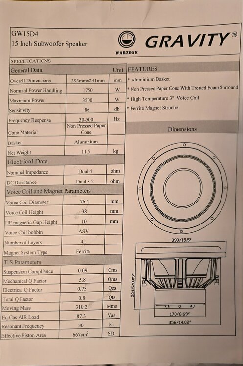

Daryl_89 Posted February 8, 2025 Author Report Posted February 8, 2025 Thanks for the response Joe I'm aware of the box being smaller than ideal and far as bigger box i could go taller an possibly wider slightly but not deeper (battery box with 2 batteries in the way) on a new box but was keeping it hidden beneath a cargo cover in the back of my 96 ford explorer(has all 2ga wires and 200amp ho alt) with the current sealed box. Was wanting to toy with externally porting the current box being the speakers probably aren't the greatest but do well in the seal box with my 3k amp pushing them. Also here is the info that came with the speakers (tried my best but can't find anything else for them) you guessed it Amazon specials lol so no manufacturer to get any additional info or atleast I couldn't find anyone to contact.
Joe X Posted February 10, 2025 Report Posted February 10, 2025 Actually there's enough information in that sheet to model the sub and the result is that those subs are specifically designed for sealed, the have a very high Q and an EBP of 41 which indicates sealed use strongly. However the response curves do not rule out ported use in this case, 2.8 to 3 cubic feet per driver is indicated but tuned low, I suggest 32Hz and not much higher and a port area of 45 square inches per driver, that spec should let you play significantly louder while still sounding pleasing to the ear, porting your current box would result in losing the benefits of ported and the port itself would need to be very long to achieve low tuning and keep port area of adequate size. Your vehicle can support the box size needed and you can even build it yourself to the dimensions you like.
Daryl_89 Posted February 10, 2025 Author Report Posted February 10, 2025 Thanks again Joe, I'm gonna do some investigation on vehicle/box dimensions and see what i come up with. But also with you telling me sealed is highly recommended i might be better off leaving well enough alone if the box isn't too small. Also what did you use to model the subs with the provided info cause I tried winisd an couldn't get it to accept what I put in for some reason. Thanks again, Daryl
