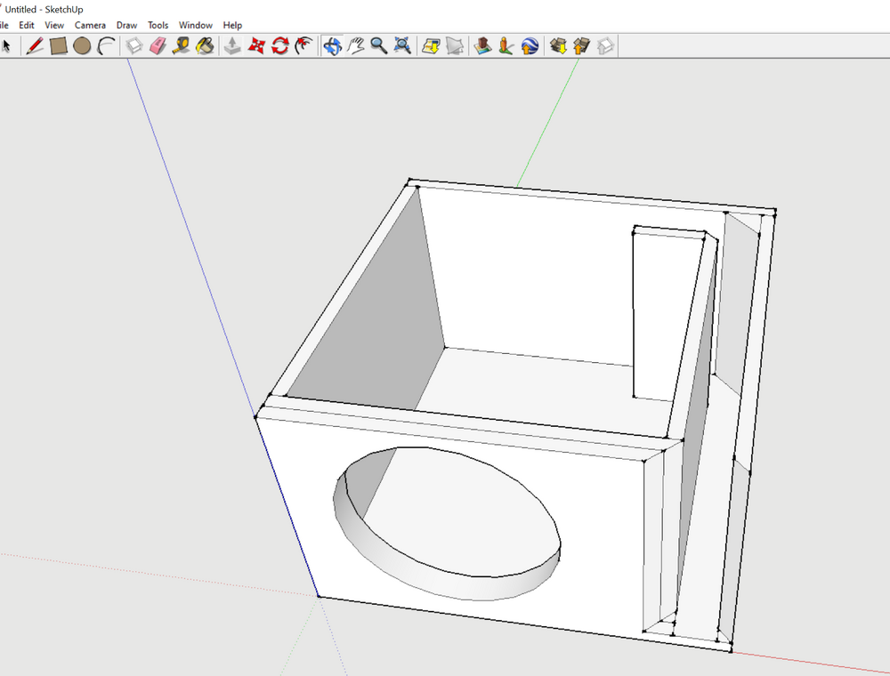

Jessica Posted April 5, 2025 Report Posted April 5, 2025 hey joe! i know you have been deisgning boxes for a long time and would appreciate the 2nd set of eyes on this design just to check for anything i missed. subwoofer will be a AA mayhem 12 d1 on a skar 2500 at .5. Listen to a fair amount of heavy bas music and sometimes bass boosted tracks. car is a 96 dodge stratus. Im not dead set on the port flares since they are so small the may not matter, just trying to reduce a bit of turbulence around the exit. I guessed on the speaker physical displacement but its fairly close. Only thing i am concerend with is port length but it probably isnt a big issue. Thanks for looking Rest in peace, walled 87 accord build log 03' Corolla build with AA Mayhem inside. My super random youtube channel and terrible camera work. Wiring comparison by CaptainzPlanetz Wire and fuse guide by Guest SyKo13
Joe X Posted April 5, 2025 Report Posted April 5, 2025 Some feedback: The driver displacement should be around 0.15 cubic feet for a higher power 12 inch sub. Your port area is definitely low and should be around 40-43 square inches to keep maximum port airspeed around 25 m/s, Also because the amount of power you should have a bracing plan like cross braces, a window brace or such. That's about it.

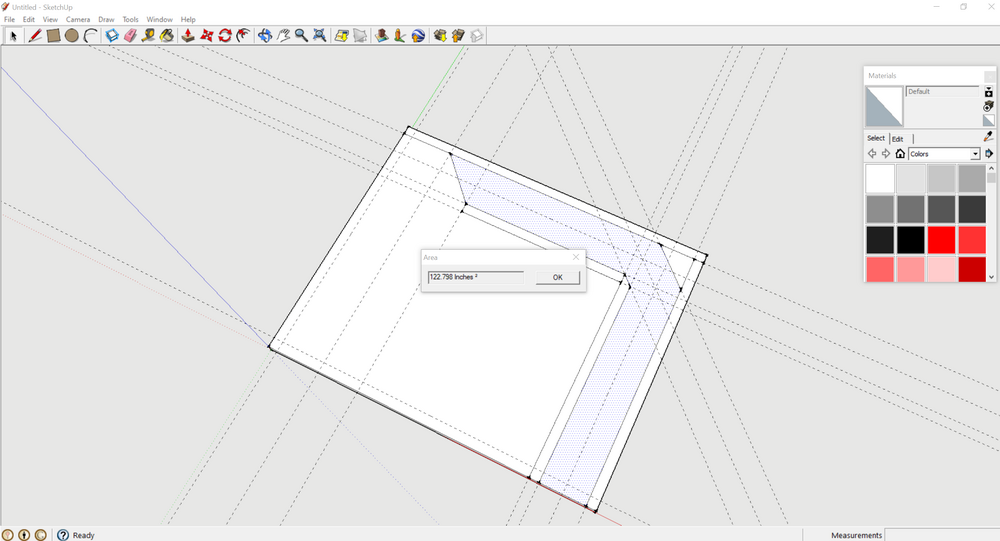

Jessica Posted April 5, 2025 Author Report Posted April 5, 2025 with that port area i would need a 36" long port. thats not too long? Rest in peace, walled 87 accord build log 03' Corolla build with AA Mayhem inside. My super random youtube channel and terrible camera work. Wiring comparison by CaptainzPlanetz Wire and fuse guide by Guest SyKo13
Jessica Posted April 5, 2025 Author Report Posted April 5, 2025 also, would you say that this at 3.5" wide would count as 35" of port length or would you measure differently?ou measure different? Rest in peace, walled 87 accord build log 03' Corolla build with AA Mayhem inside. My super random youtube channel and terrible camera work. Wiring comparison by CaptainzPlanetz Wire and fuse guide by Guest SyKo13

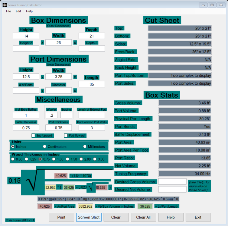

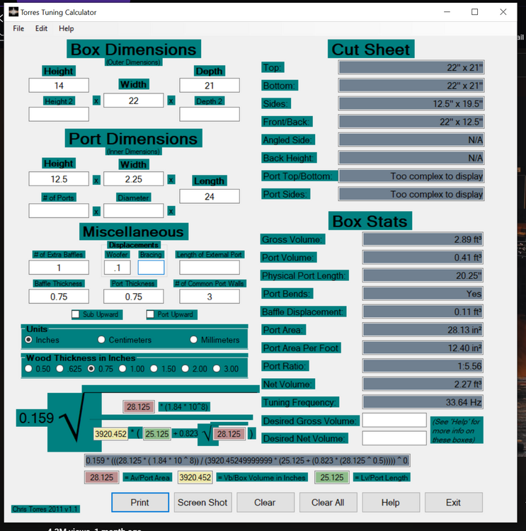

Jessica Posted April 5, 2025 Author Report Posted April 5, 2025 of course torress bugged, ut regardless, new design. think this meets the criteria. thanks joe! Rest in peace, walled 87 accord build log 03' Corolla build with AA Mayhem inside. My super random youtube channel and terrible camera work. Wiring comparison by CaptainzPlanetz Wire and fuse guide by Guest SyKo13
Joe X Posted April 6, 2025 Report Posted April 6, 2025 14 hours ago, Jessica said: with that port area i would need a 36" long port. thats not too long? You don't want to have a port length over 40" to avoid port resonances in your playing frequency range, also when needing a longer port you want to avoid taking a second turn. As for your latest Torres looks petty good.
