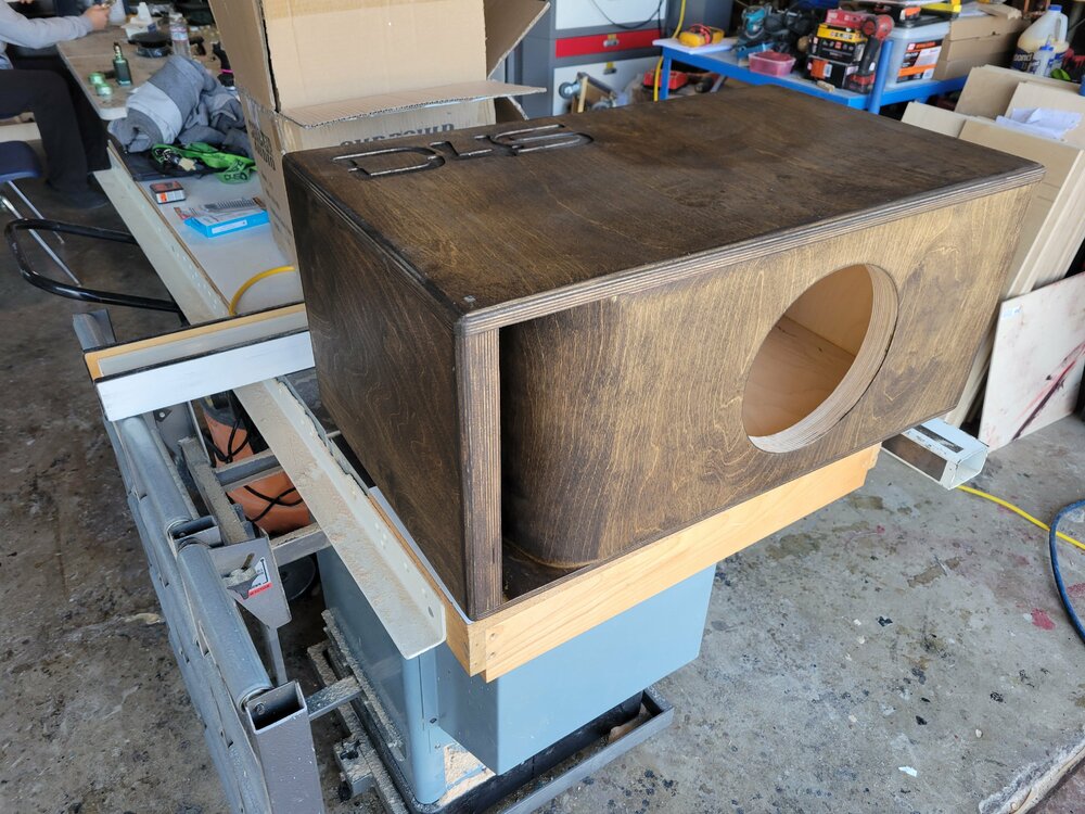

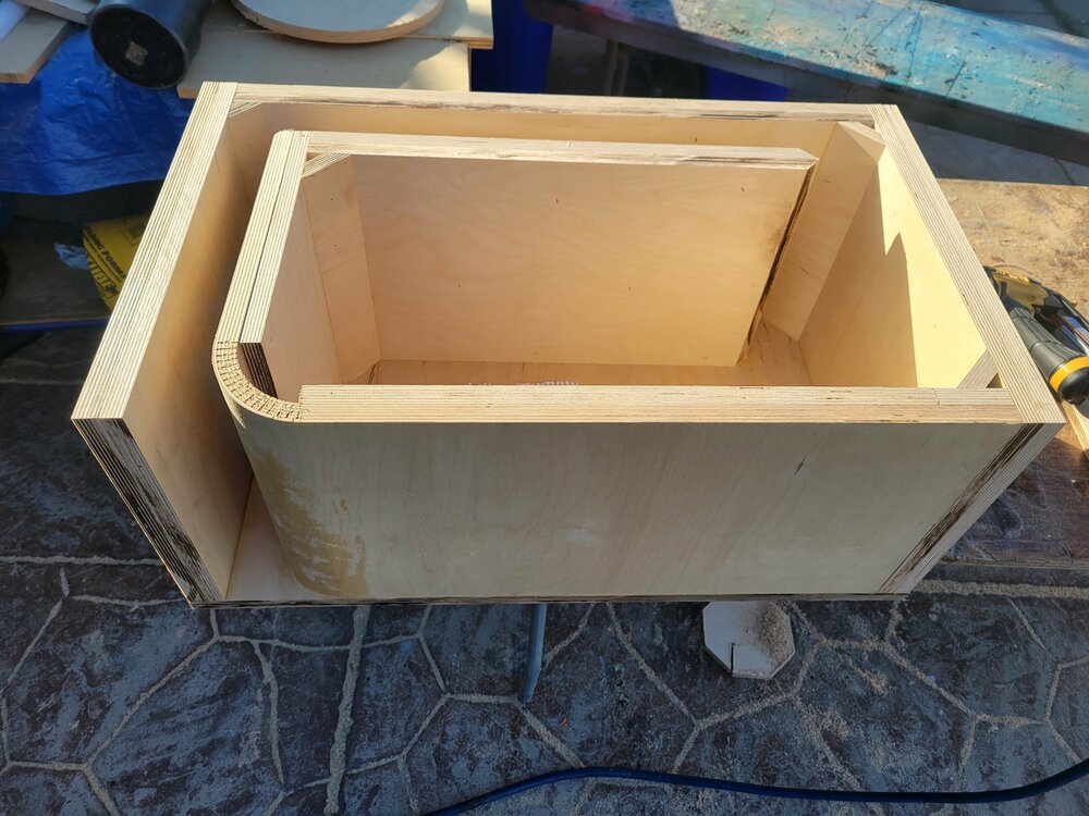

Joe X, thanks for the quick reply! Unfortunately Ive done everything you suggested, many times over. Its not working. there is something wrong with the box.
I discovered that the rear of the magnet is nearly touching the wall of the baffle inside the box. Its due to my design request. which forced D4S to cram the sub space by placing the baffle almost touching it. In fact its got less than a inch of clearance and thats not recommended on any good box.

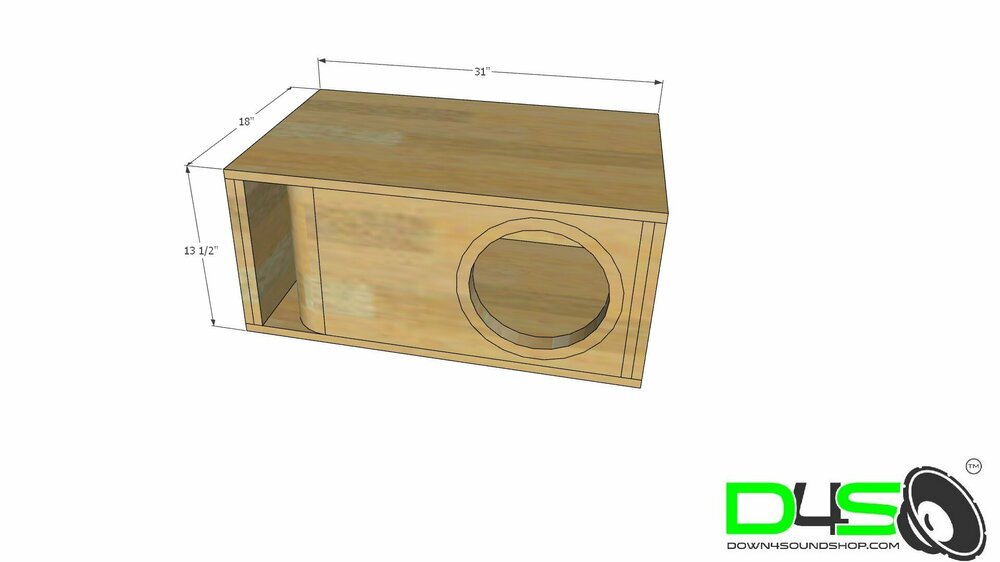

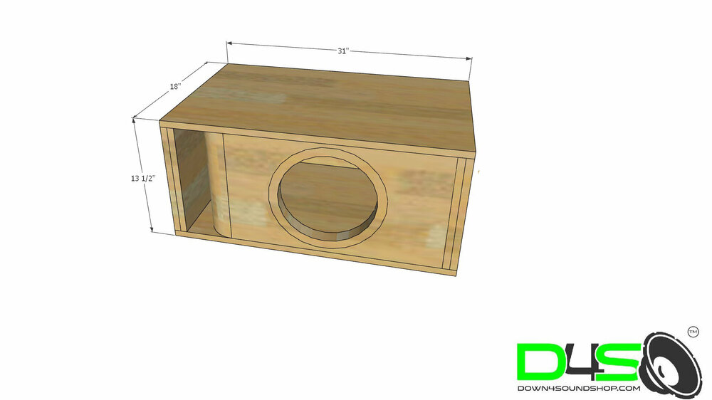

the engineer had his own dimensions and hole cut out and I changed them all to my preference. I admit this was not smart.
As you can see I asked the engineer to move the hole from the right to the left as seen in the rendering photos here. Another guy told me that was also a mistake because the box design required the hole to draw and push from the right where it had computer generated placement in the box. now its literally touching the baffle wall behind it in the middle not drawing equal air and its behaving EXACTLY as if this is the cause.

Try inverting your sub and set phase to 180
30 Hz
LP 65
HP/Subsonic 20
No pillows, try Pollyfill
Try adding another piece of wood to the baffle, just a square, enough to clear the sub and cutout.
