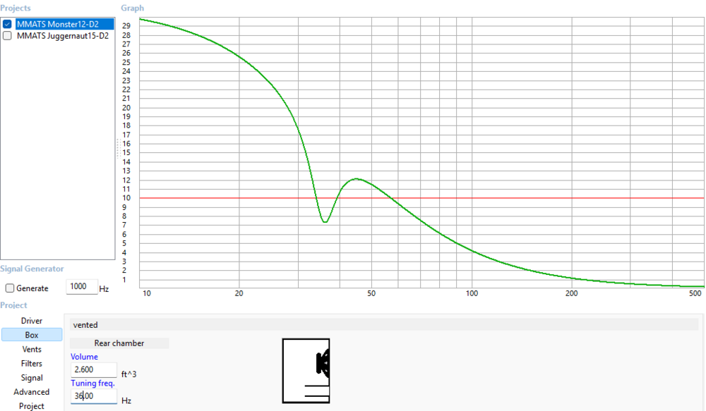

Look at this cone excursion problem throughout the 40's and 50's on the Monster12 @ 36 Hz: (Why for, when Fs is 38.8 Hz, mms is relatively low, and qts is .47? Is it because the 10mm XMAX value is actually halved?)

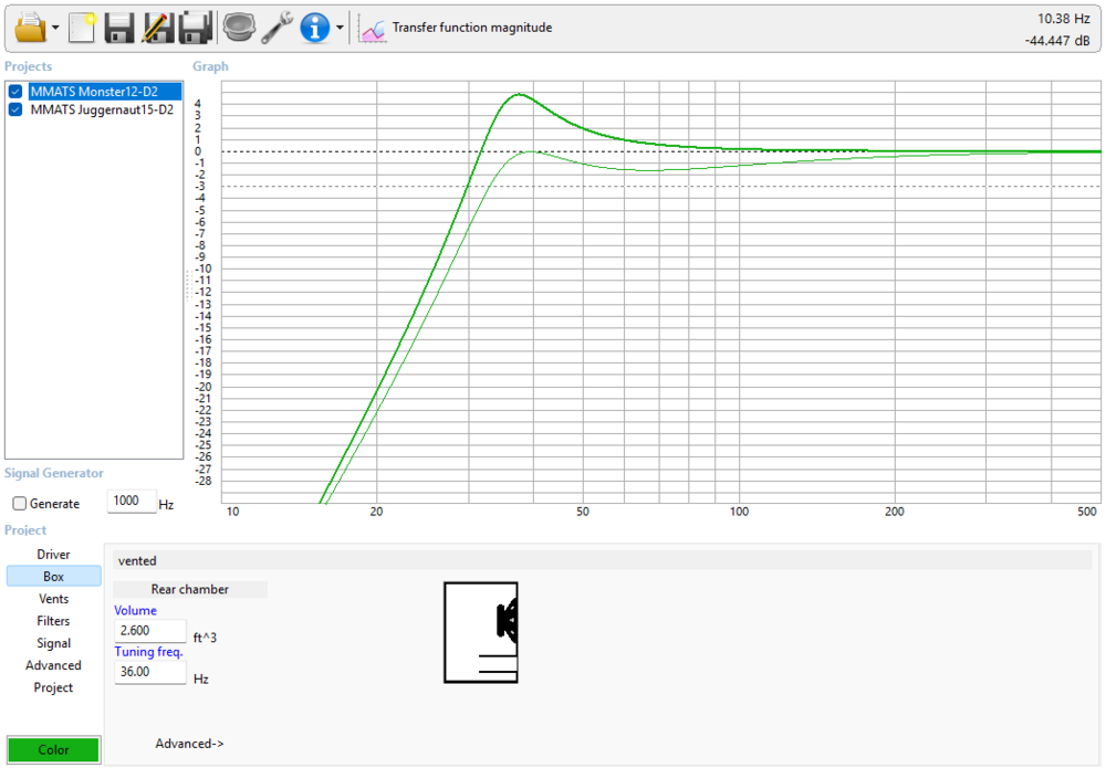

Comparison of the Monster12 in a 2.6^3 and the Juggernaut15 in a 4.5^3: (Can I get some feedback?)

The Juggernaut is 19.8mm Xmax, so take care where you get parameters from, the manufacturers recommended box internal volume is best but if you need lower volume like 4 cubic feet you should be fine, you can use the model you entered and lower the volume to see the effects.
Other than that there are many subs out there if you are not set on that brand, from the parameters looks like the juggernaut is higher efficiency with higher cone area and lower MMS, which means it will get louder for the watt, to that end the larger box will help.
Thanks! XMAX seems low, but I guess you can't argue w/ their numbers. Does the cone excursion plot for that 12" Jugg seem alarming, or just a theory?

The Juggernaut 15D2 which I was looking at is basically 20mm Xmax which is ok for a medium power subwoofer so no problems there.
