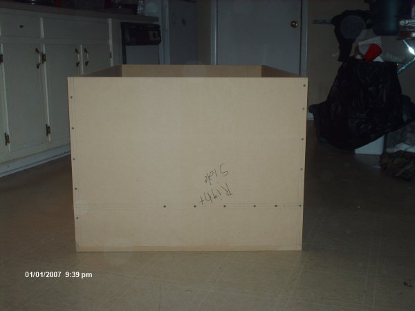

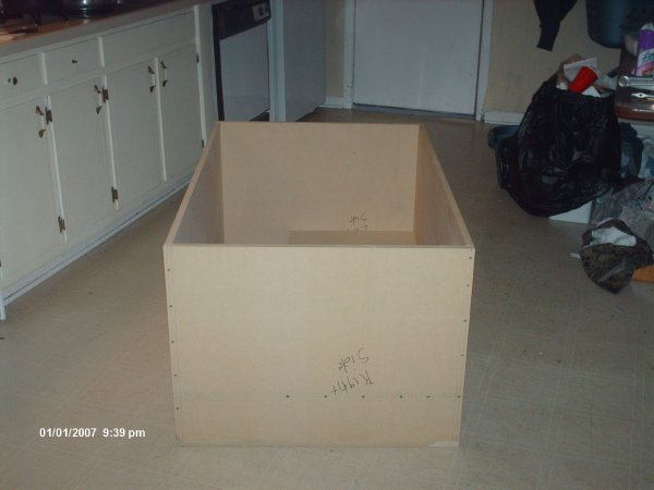

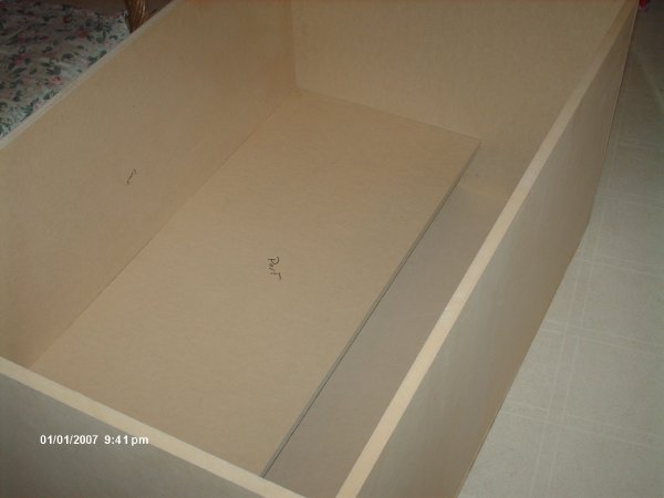

mr_kebo Posted January 2, 2007 Author Report Posted January 2, 2007 Not yet. I dry assembled it before
Ernesto Posted January 2, 2007 Report Posted January 2, 2007 it can never be tuned to low LOW FTW. 32hz is a good tunning. Picks up the lows just fine.

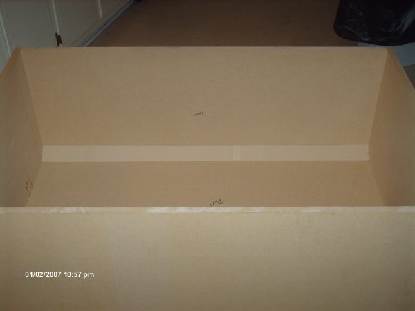

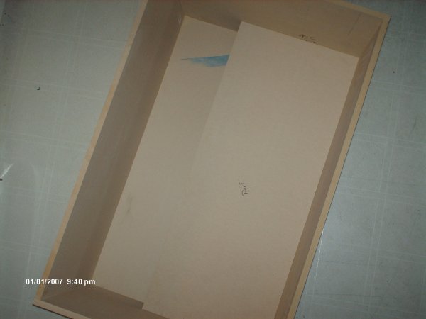

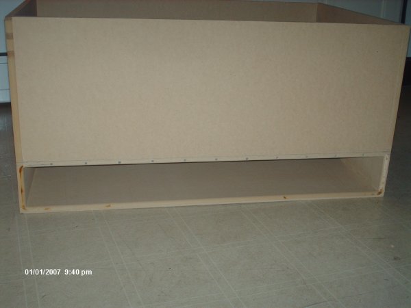

mr_kebo Posted January 2, 2007 Author Report Posted January 2, 2007 Yea its a good tunning but when i start adding some bracing i will drop even more correct? The port is 6" away from the back hatch will that cause any loading issues and tune it lower?
Ernesto Posted January 2, 2007 Report Posted January 2, 2007 Looks good...LOl almost looks like there's no glue (no drips)... Don't forget to throw in some silicone.
David Posted January 2, 2007 Report Posted January 2, 2007 no tuning will go up, but not enough for your ears to notice, unless your using 4x4's and bracing. in that box I would use 2x2's or 1-1/2 solid wood dowls. box looks good, good craftmanship, shoulda glued it from the get go, now ya gotta do it 2x's

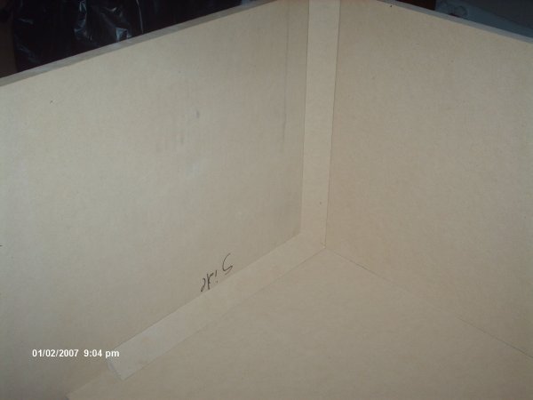

mr_kebo Posted January 2, 2007 Author Report Posted January 2, 2007 i bought me a pretty nice delta table saw today at work Gonna make me some pieces that will get rid of the 90 degree angles in the box. all that i can. I picked up some 2x2 solid wood dowels also to do some bracing.
Dale Posted January 3, 2007 Report Posted January 3, 2007 Good work so far man. I admire your persistence. Post pics when you make progress
mr_kebo Posted January 3, 2007 Author Report Posted January 3, 2007 anyone have any tips on how i need to cut the pieces for the 90s to make the into 45s. this is what ive got so far.
