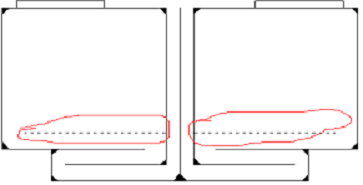

I'm designing a box for 4 12" L7's. I'm trying to tune to 32-35hz and wanted to know if this was a good port style for that tone: I didn't know if I should be doing this port style at all, but in the case I could use it, the part outlines in red is where I had the question, should I give it that extra peice or leave that out? Also, is there a better port design I can use for the range I wanna be in, or is this a goos type to use? Thanks.

Oh, I had to design it that way because of the wheel well. Lol, Yeah, Trailblazers are small in the trunk. I have 18" tall, 33" deep, and 54" wide, which will be about 16.7 cubes, which is more then enough, but thats not included the space the wheel wells take, bracing, fiberglassing the inside, and dividing each chamber (if enough room is available) which should take up close to if not more then 3.5 cubes.
