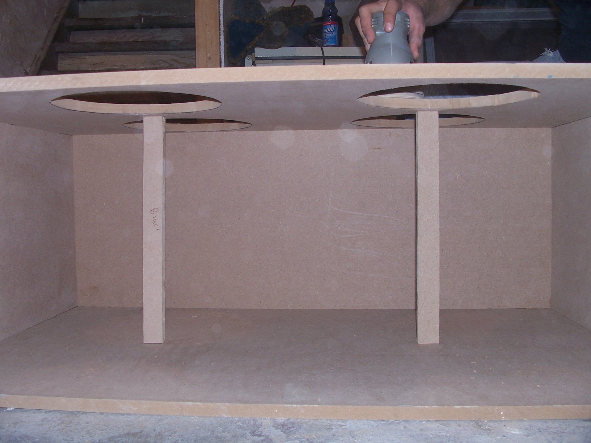

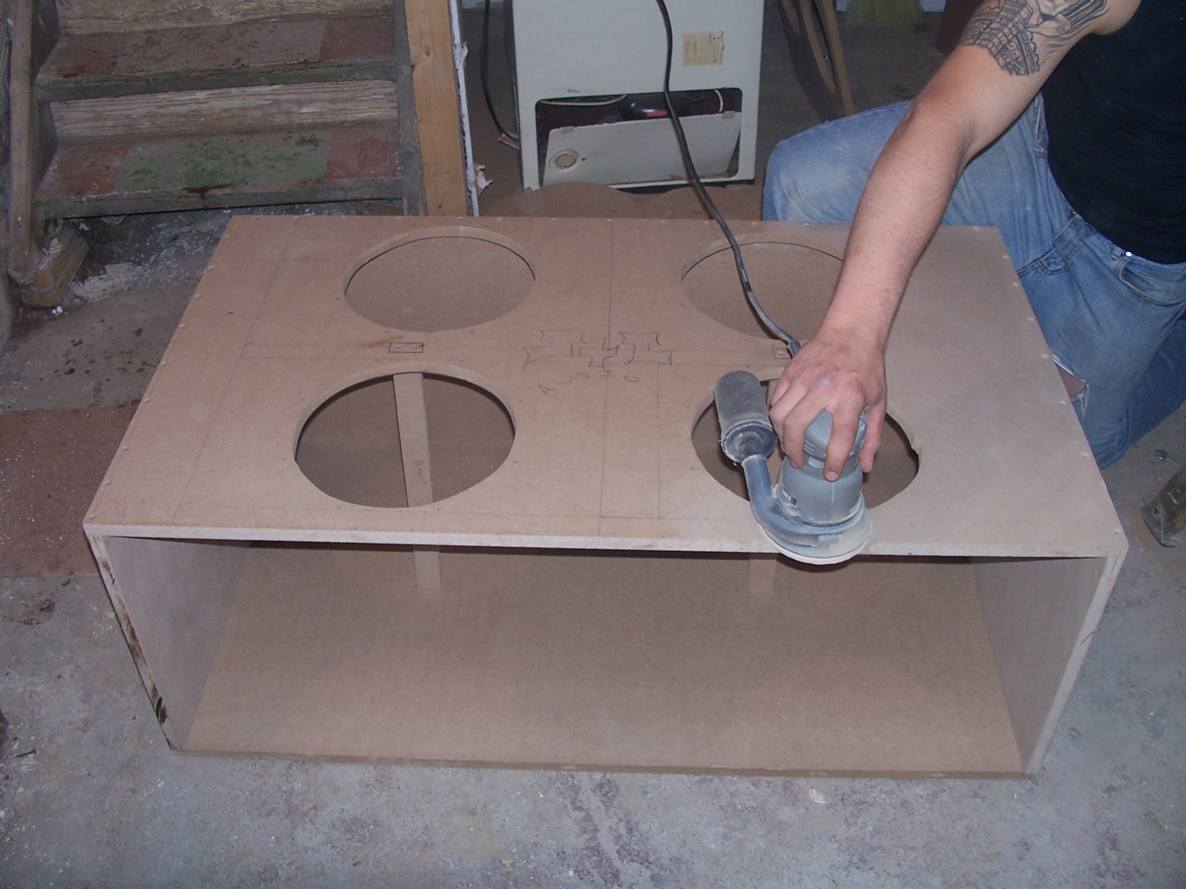

alpine Posted February 18, 2007 Author Report Posted February 18, 2007 More pics. I had to add one more brace from the back to front.Then take ot back apart and glue everything.So i am almost done with the help of myone buddy Joe. BANNED LIKE A MOTHAFUCKA IM BANNED BECAUSE IM A FUCKIN FUCKTARD
ChevyBoy Posted February 18, 2007 Report Posted February 18, 2007 u might wanna use a 2x4 as bracing. that little piece of mdf isnt gonna do anything. and like people said, double baffle.

SPLGEO Posted February 18, 2007 Report Posted February 18, 2007 ok i'll give you some credit for the box sand down the hole so they are smooth and not wavy your tuning is probley around 35 now and I bet teh box will peak at40-45 hz 1995 Geo Prism . FI BTL 12 P chamfer, 3rdmagnet HIXMAX COIL 1/0 big 3 HIFONICS COLOSSUS 1.7 cubs tuned to 60hz in the works 2xTruck battery 1125 cca.
SPLGEO Posted February 18, 2007 Report Posted February 18, 2007 w bracing 39.6hz/ 1.975 cubic feet per sub w/o 35hz + box may destroy itself/ 2 cubic feet per sub 1995 Geo Prism . FI BTL 12 P chamfer, 3rdmagnet HIXMAX COIL 1/0 big 3 HIFONICS COLOSSUS 1.7 cubs tuned to 60hz in the works 2xTruck battery 1125 cca.
alpine Posted February 18, 2007 Author Report Posted February 18, 2007 is 39Hz good BANNED LIKE A MOTHAFUCKA IM BANNED BECAUSE IM A FUCKIN FUCKTARD
