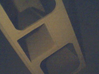

Ernesto Posted September 22, 2006 Author Report Posted September 22, 2006 Do you guys think this is a bit over kill for two 15" L5s?? Im thinking it is but over kill is a good thing I guessStill have lots of sanding to do :-[
