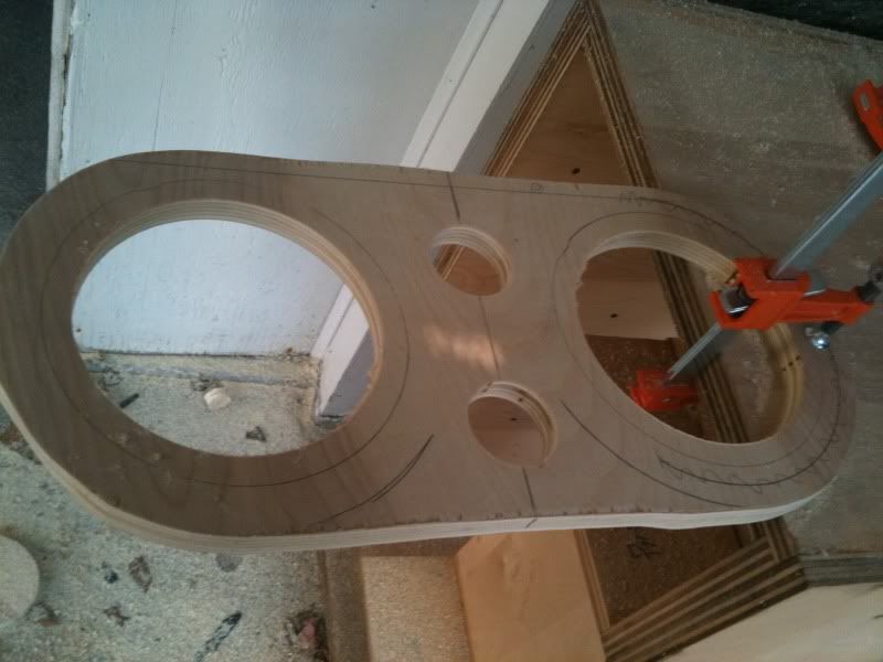

That sucks about the jig, I always lay out my circle on the wood and the make sure the bit is lined up before cutting a bunch. Measure twice, cut once.

Well it took me about an hour two but i cheated lol. Theres no way 4 pairs of speaker wire were fitting in there so I did what seemed like a good idea and it wont even be noticed onced its loomed up. As for the jasper jig I usually do a practice cut on scrap wood to make sure woofers/speakers fit but i didnt this time smh. And yea i wanna use the enclosure coating from second skin on the bottom half of the doors and on the wall. Right now i want music (no bass) playing in my car by next friday (i leave for VA the next day)

Decided not to go to carlisle because I wanna get these doors done. Taking a food break right now. I figured that itd be pretty dumb to scrap the pods because i made the cutouts to small so what i did was ran the router around the inner edge once and it fit like a charm. Hand sanding was taking forever so that idea definitely saved me form some sore ass hands and arms. Once im finished eating I'm CA gluing the pods to the door ... wrapping and then resin.

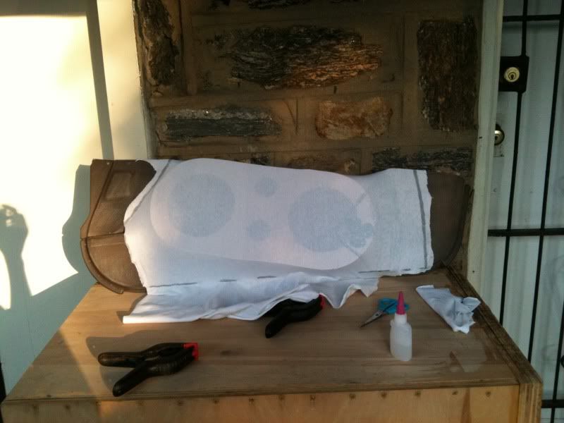

This is where im stuck at right now. I have CA glue, 3m super 90, hot glue and a staple gun that only gets the staples in there halfway. I just cant figure out wtf is the best way to wrap this. I have alot of that orange fleece from my first try but idk :-( I think im scared to mess up again lol. So tonight im looking at tons of door panel builds to try and get a good idea. If anybody has any tips please help me. I was working good all day until this. I dont want to get bummed out again so help a brotha out dammit.
Edit- My best idea right now is to spray the whole piece wit hthe super 90 and the fleece also ... wait until its tacky then put the fleece on it and pull tight while it dries... but will that stay on when i apply the resin?

I used a SUPER OLD shirt per door. DON't cut the shirt, just put it around the pod and pull all the slack to the back side. Then wire the slack tight, once you resin the cloth you can cut all the extra fabric off the back. you don't even have to staple or any thing, just a couple temp chunks of bailing wire.

Did my explanation make sence? did you happen to find the pics in my build? I know it got long.lol.
Edit: I wanted to add that I poured/brushed/sloshed resin in all the inside corners the next day and trimed the fabric off the back the after the inside resin had set up.

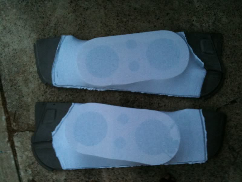

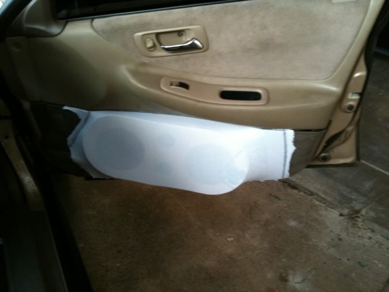

I sorta did your idea in my last pod build and i didnt want to make any of the same mistakes (not saying you did it a bad way) but i just wanted to try something different. Something that wouldnt be "warp prone" like my last pods. So this is what i came up with using some CA glue and tshirts from my job that were gonna get thrown away (3x/4x tees). Tomorrow will be resin and maybe fiberglass if it dries fast enough. Where can i get a roller to get bubbles out of fiberglass chopmat?
Test fit before the fabric
Good clearance
