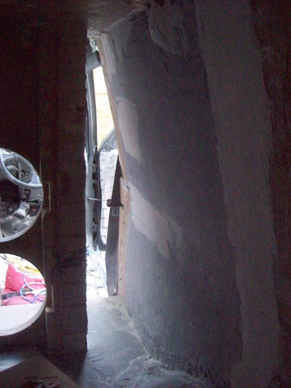

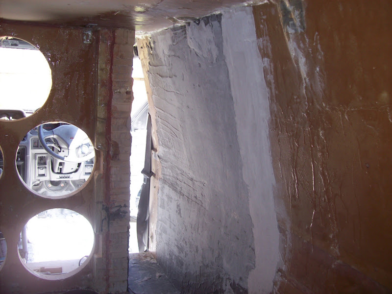

Started by laying down alot of filler on the walls and sanding lots

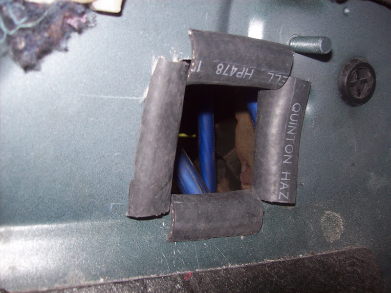

Cut a hole in the firewall to allow signal, speakers and remote cables out and under

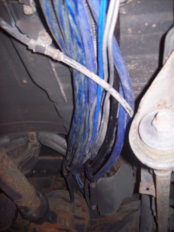

Also also ran the RCA Cables and Speaker cable under the car - a beast of a jobbut finally got it done
Thats was Mondays work - onto Tuesday

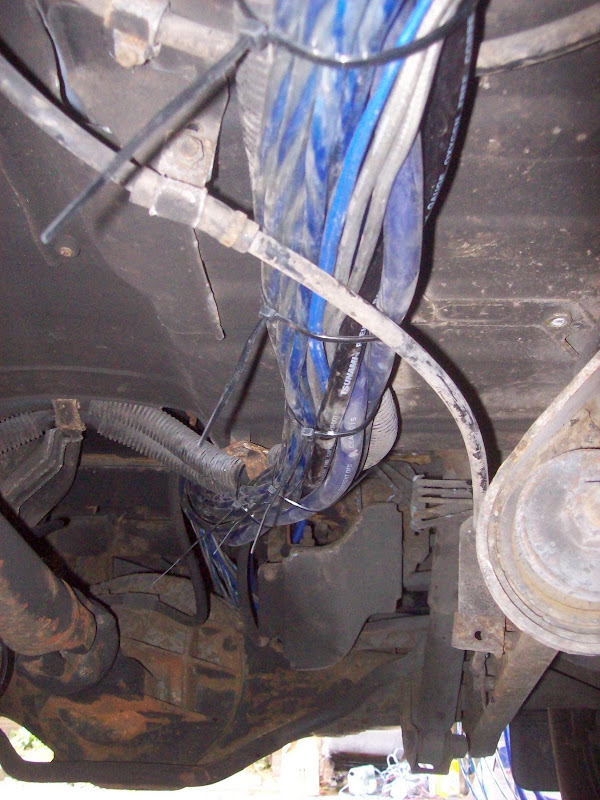

First up I got under the 'gun again and cable tied everything securly

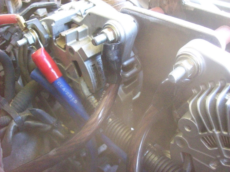

Earth Cables crimped and attached to the Alt mounts - good solid earths

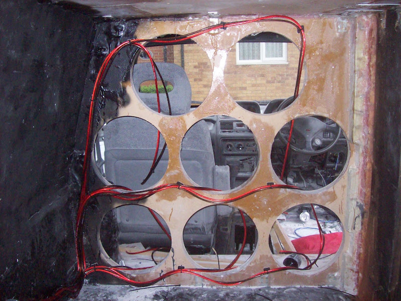

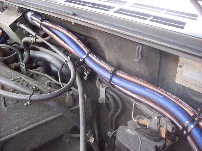

Port went in (on the right) and also ran speaker cable - 8 pairs of 8awg

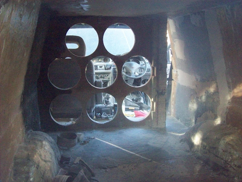

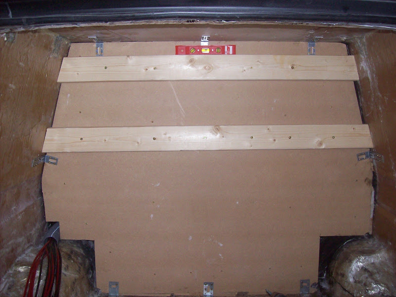

Back of the box in - 50mm thick with some hefty bracing
Still need to add more bracing and wood over the arches to seal it but thats how things stand at the moment - Sunday im off to cdescort to put some metal in the roof over the passenger compartment to strengthen it up then sunday night it goes to Paul @ A1 to have rear amp build done

Nice build, but i wouldn't run my speaker wire next to my power wire... could give some interferences...
Honda Civic EJ2
Stock Audio System! And it does(n't) kick ass!
Its signal wire and power cable you need to be careful of not speaker but I have good earths in the system - it shouldnt be a problem
