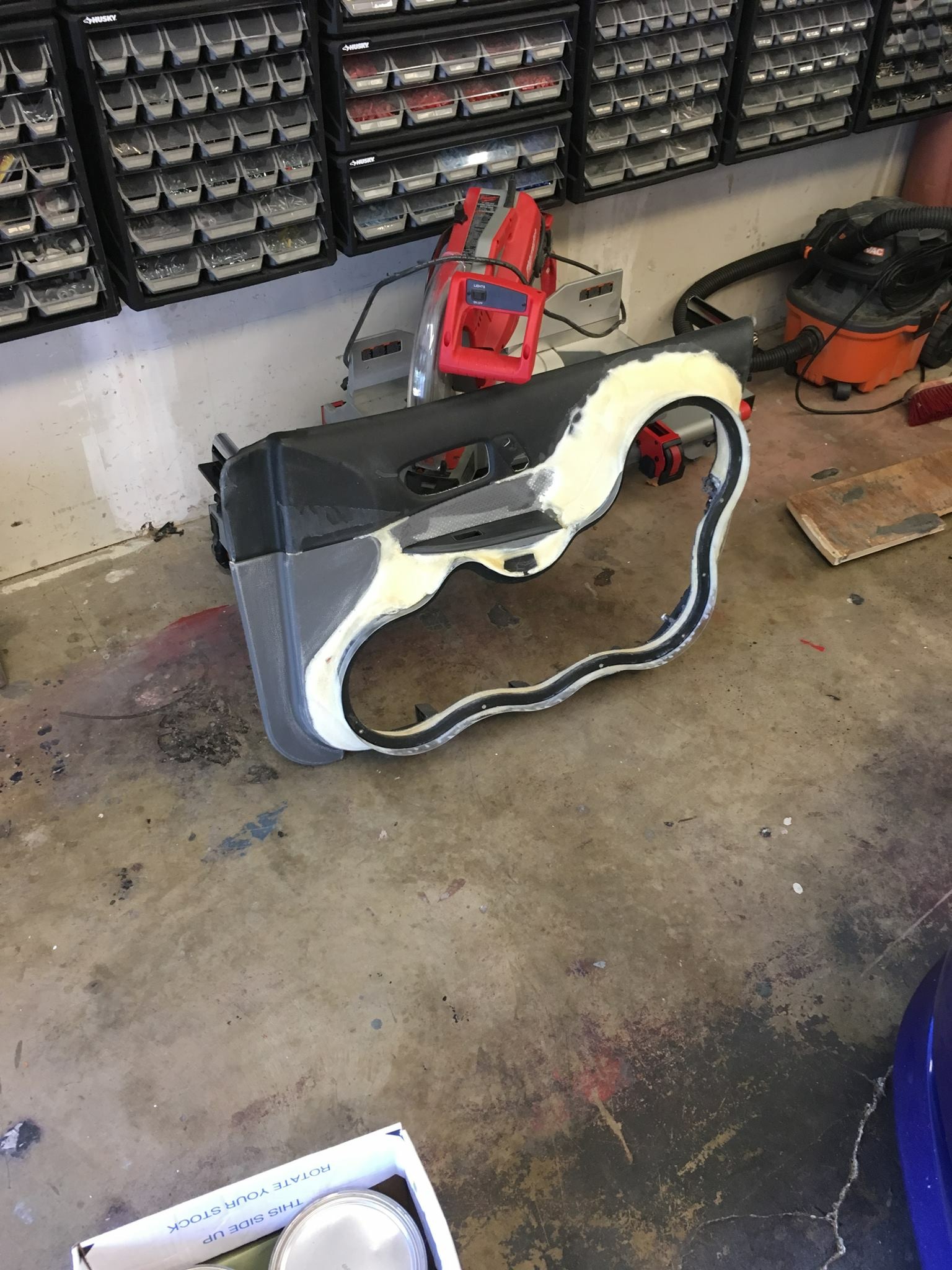

MADVIBES Posted March 4, 2017 Author Report Posted March 4, 2017 I was going to run tests this morning to determine if I can get louder than I currently am, however I picjed up an overtime shift and couldnt say no... soon enough I will try to do different tricks to increase the output. DB DRAG PSYCHLONE PRO 156.3 30 SECOND AVERAGE FO MAX AT 26HZ LEGAL DASH DRIVER DOOR OPEN 158.0@30 HZ MY BEST SO FAR, HOPEFULLY A 160 COME FEBUARY. 156.9@26hz 158.0@30hz

MADVIBES Posted March 15, 2017 Author Report Posted March 15, 2017 I did 4 more rounds of testing, took two subs out of the box and tested, came within .2 db's of all 6 at 26hz. tried porting the sealed side into the ported side via 6th order tuning, tried making the port longer. bottom line.... wasted my time, all of my tests led me to one conclusion. I was loudest with 6 and the original design. So I ordered two more amps and I am adding 10k more worth of power. also adding 4 more batteries. I am not ruling out the possibilites of running only 3 18" subs in a standard ported enclosure with 10k on each one. I will see what this system will do with the additonal power with my current set up which should technically go up .75 db.might crack that 158@26 if I am lucky. I will also start my new door panels and start making my interior a little more rigid. See if I can get over the 160 hump by summer. DB DRAG PSYCHLONE PRO 156.3 30 SECOND AVERAGE FO MAX AT 26HZ LEGAL DASH DRIVER DOOR OPEN 158.0@30 HZ MY BEST SO FAR, HOPEFULLY A 160 COME FEBUARY. 156.9@26hz 158.0@30hz
