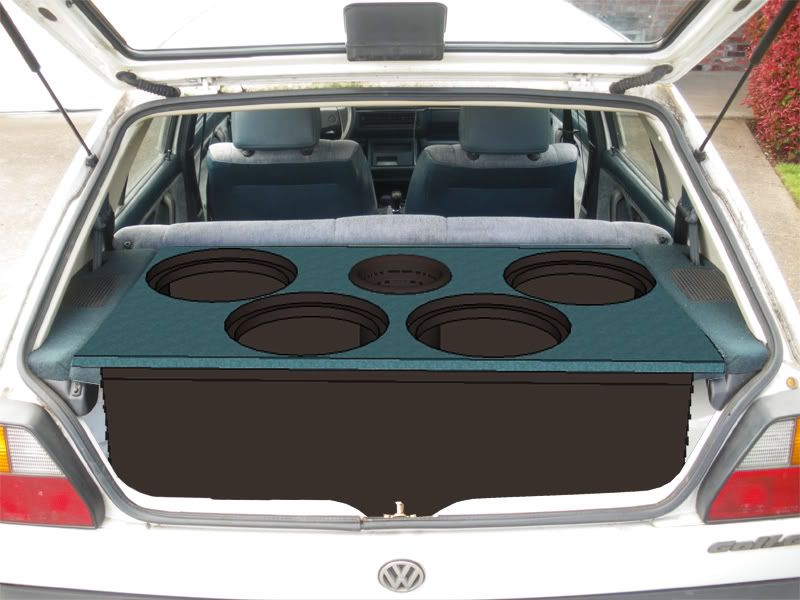

This box design that I came up with was influenced by Steve Meade's and Johnathan Price's boxes. It is designed around a 1988 Volkswagen Golf GL and four 10" Ascendant Audio Chaos Dual 2-ohms with a 6" aero port and are wired in 1-ohm to a Rockford Fosgate T2500-1BD amp. It's six cubic feet loaded (with subwoofers and port installed) and is tuned to 34hz. I'm mainly creating this topic to get input to make this box perform better. I know some of you will suggest a slot port, but to allow the box to visually "flow" better, I prefer a aero port. So, if you have any thoughts that will allow for better, even amounts of SQ and SPL, reply away!

Needs alot more port area, that size port would be good for like 2 cubes.

Six cubic feet with every thing installed.
So you think I should add two more ports in the front two corners?

x2. three cubes at most. so at least add another 6" aero.

Or add 2 3" ports to the back corners so that its more appealing to the eye.

Something like this?
Yep. Thats exactly what I was thinkin. If thats not though port still then you may need 4 inchers.

without doing the math, i think you need 4" ports if you do this. with flared ports you want around 9sq in of port area per cu ft (give or take)
