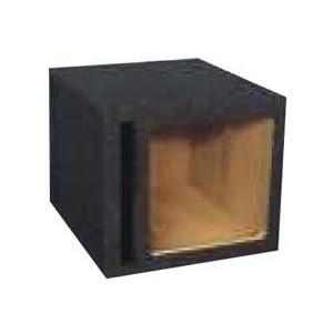

MurphyGTP Posted October 16, 2010 Author Report Posted October 16, 2010 Thanks for the quick response's guys. My box looks like this: And it sits up against the back of my seats, facing the rear. Any more suggestions, maybe on the amp frequency issue, that i can try after I get a new ground wire tomorrow? Quote Memphis PR 12's Kicker zx750.1 Memphis PR 6x9's Pioneer 5.25's Planet Audio 3004 Kenwood KDC345
big dee Posted October 16, 2010 Report Posted October 16, 2010 the box is to small i think it should be 2 times that size from what i can see . prob why you dont have low notes too Quote
big dee Posted October 16, 2010 Report Posted October 16, 2010 move the box closer to the back of the trunk and that should help too Quote
MurphyGTP Posted October 16, 2010 Author Report Posted October 16, 2010 Hey can I get the demisions of your box I just bought the same set up zx750 and l5 15" if that's no problem for you I'd thank you alot I bought it off a buddy of mine, he ordered it online. It's similar to this, but not the same as in the port tunnel inside the box: Dimensions (W x H x D): 22.5" x 17" x 16.25" I honestly don't have enough spare time/tools to build a box, but is there any good ones out there that could fit in my trunk (grand prix) that i could maybe order online? Quote Memphis PR 12's Kicker zx750.1 Memphis PR 6x9's Pioneer 5.25's Planet Audio 3004 Kenwood KDC345
