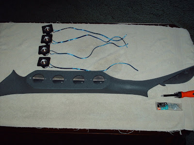

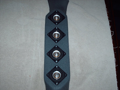

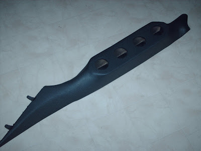

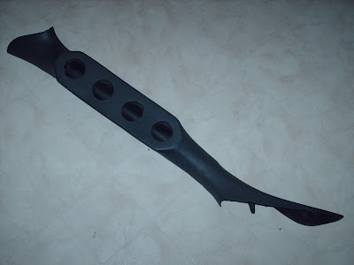

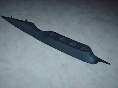

thanks for the votes guys, and keep the m coming !! Here are some pics of the drivers A-pillar completed with the same textured paint i used on my door pods, this color matches great in my interior and covers alot of small imperfections !! Get some pics up soon with Tang Bands installed !!
Used the wifes 5mp camera so i could get some better pics to you !!!

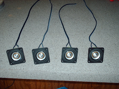

Look what came in today !!! Now i can finish my drivers A-pillar and get onto the next one !!!
These have such small connections that i decided to just solder all of them !!

im curious as to how those sound. those are the full range drivers correct?
Parts-Express describes them as :
Tang Band W2-803SM 2" Driver
A small 2" drive unit useable as a mid-tweeter or extended-range midbass. Features include a silver poly cone, ABS basket, solid aluminum phase plug, shielded neodymium motor, s-shaped surround, and venting under the spider. Great for A/V, multimedia, automotive, or multi-driver hi-fi use. Specifications: *Power Handling: 10 watts RMS/20 watts max *VCdia: 3/4" *Impedance: 4 ohms *Re: 3.6 ohms *Frequency range: 160-20,000 Hz *Fs: 160 Hz *SPL: 85 dB 1W/1m *Vas: .01 cu.ft. *Qms: 3.56 *Qes: .46 *Qts: .40 *Xmax: 1mm *Dimensions: A: 2.25", B: 2.04", C: 1.35".
How did you decide Whig ones to run? Also interested in how these will sound. Need to upgrade my front stage BAD!!!
Did alot of research on them and had a couple of friends online that used these and where very happy with them, in fact i got the idea for this design off of a friends eclipse, shout out to Jacob Morris and Mike Singer !! I liked the daytons really well but they where just too big for my application .
