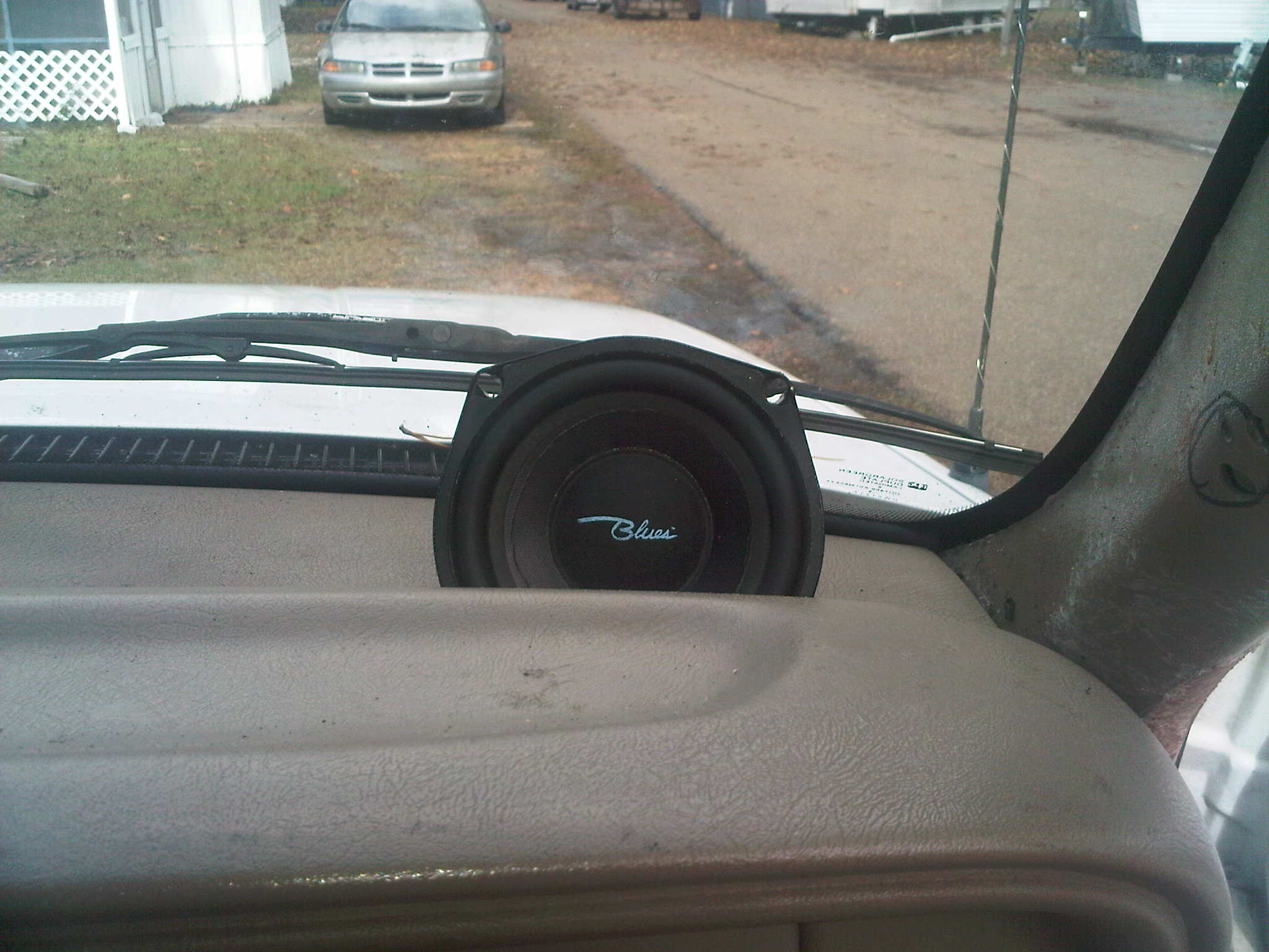

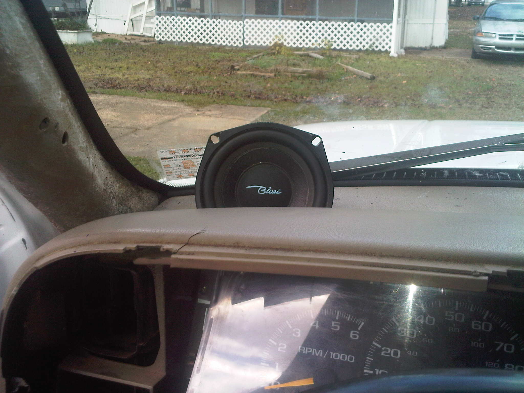

White Lightning Posted January 26, 2013 Author Report Posted January 26, 2013 Where are they going on the dash or did I miss you say that part? Far left and right corners of the dash ... for maximum channel separation, stage depth and width, and a center WAY out on the hood without the use of a center channel ... Kenwood / HELIX / Linear Power (For The Love Of Music) / Brutal Sounds / OverKill Electric Co Questions About Sound Quality ?? Try Here ... Sound Quality, What does it REALLY mean ?? SMD SOTM Winner "White Lightning" 1997 GMT400 Chevy Silverado "The Green Dickle" 1994 GMT400 Chevy "Phantom Dually" Randal's 2007 Chevy Avalanche (we haven't named this one yet) Dylan's "Brutal" 17 Chevy Cruze RS Hatch
White Lightning Posted January 30, 2013 Author Report Posted January 30, 2013 The 5.25" drivers ... we cut a hole on each side of the dash to "recess" each driver to fit between the glass and the dash and stand almost "up right" with the dash line defroster vents ... Also matched the pods up with the hood lines too, hope it turns out the way I planned ... The tweeters will be mounted to the outsides of each midbass driver closer to the A-pillars aiming almost the same direction as the midbass drivers ... Kenwood / HELIX / Linear Power (For The Love Of Music) / Brutal Sounds / OverKill Electric Co Questions About Sound Quality ?? Try Here ... Sound Quality, What does it REALLY mean ?? SMD SOTM Winner "White Lightning" 1997 GMT400 Chevy Silverado "The Green Dickle" 1994 GMT400 Chevy "Phantom Dually" Randal's 2007 Chevy Avalanche (we haven't named this one yet) Dylan's "Brutal" 17 Chevy Cruze RS Hatch
