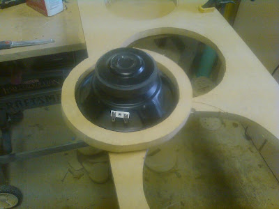

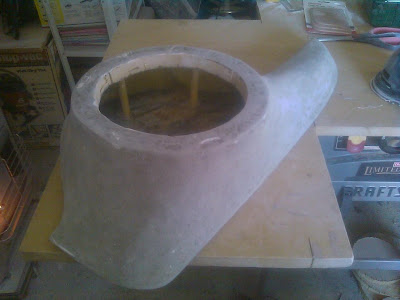

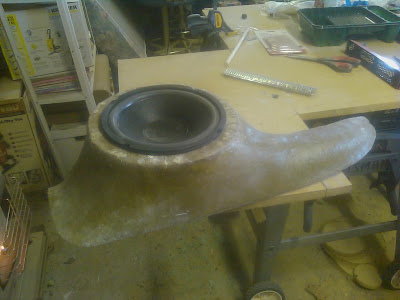

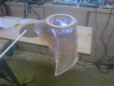

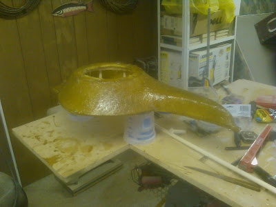

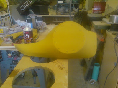

anthonyott99 Posted January 13, 2011 Author Report Posted January 13, 2011 Finally got back to sanding the 'glass today and got most of the back done and went for a test fit ! Its a horrible pic but its getting close !!!

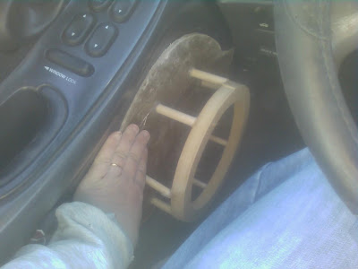

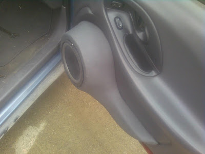

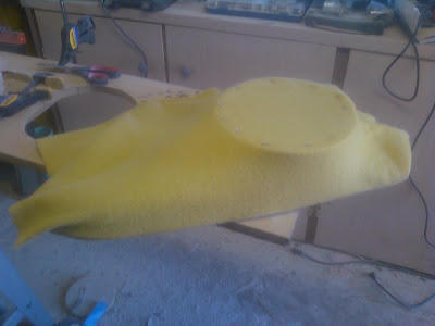

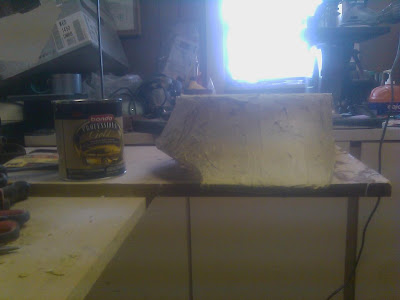

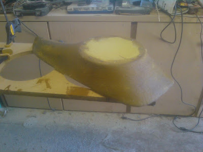

anthonyott99 Posted January 13, 2011 Author Report Posted January 13, 2011 more sanding done, this is the final pics for today, filler and sanding tomorrow should have mounted in a day or so ! Then with all i learned with this one, the drivers side should only take a weekend to do and while im doing it will be mocking up my A-pillars !!!

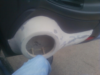

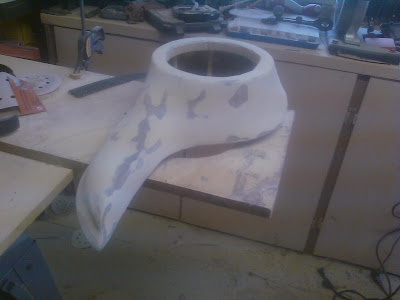

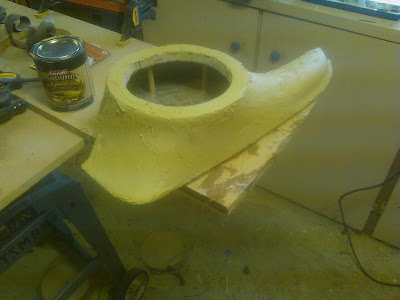

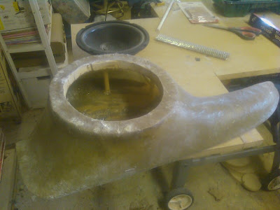

anthonyott99 Posted January 14, 2011 Author Report Posted January 14, 2011 First layer of filler on ! Didnt need much so maybe only do 1 coat, not sure if i am painting of covering so we will see after sanding this coat ! Sorry for bad quality pics !

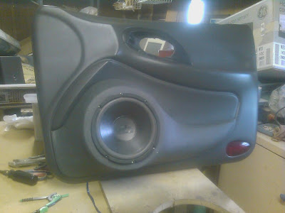

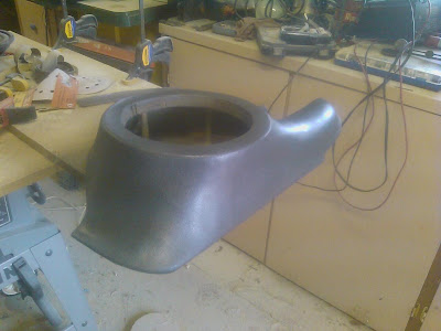

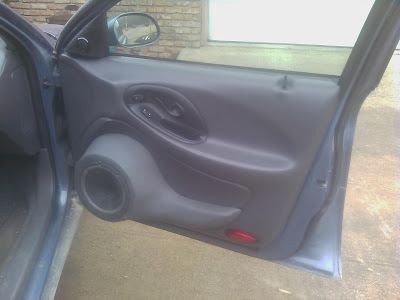

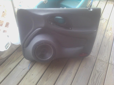

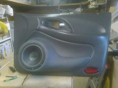

anthonyott99 Posted January 15, 2011 Author Report Posted January 15, 2011 Sanding has begun !! Another test fit Decide to go with the fleckstone type paint cuz it helps hide little imperfections and matches my interior well. Finally ready to assemble !! Well there it is, i am fairly pleased with it, only problem is actually with the sub and that is that it has a very small lip, maybe a quarter of an inch or even less to mount with so it is very hard to mount with out stripping out of splitting wood !! Next will make mirror image of this one and then start on my a-pillars !!!!!!!
SlamDUNKmyJUNK Posted January 15, 2011 Report Posted January 15, 2011 Super clean looking man. Great job.
anthonyott99 Posted January 15, 2011 Author Report Posted January 15, 2011 Super clean looking man. Great job. Thanks ! Cant wait to get the other one started , learned alot of what not to do with this one ! The other will be a breeze ! Then be working on my a-pillars also ! Cant Wait !!!
akustoms Posted January 19, 2011 Report Posted January 19, 2011 noob question lol how do you secure the pod to the door? 15"AA havoc, AQ1200d. T3 audio 6.5 2 way componet set on rockford p400.4
anthonyott99 Posted January 23, 2011 Author Report Posted January 23, 2011 noob question lol how do you secure the pod to the door? Pre-drilled holes and use small bolts and nuts with large washers so not to worry bout cracking the 'glass

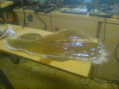

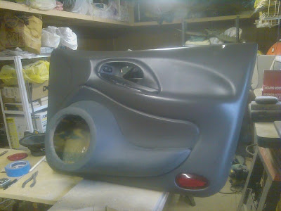

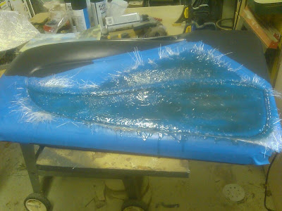

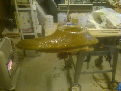

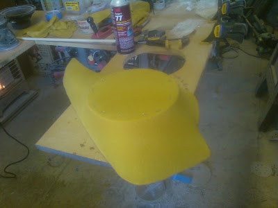

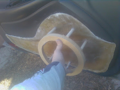

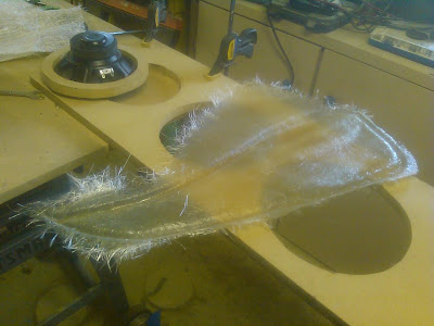

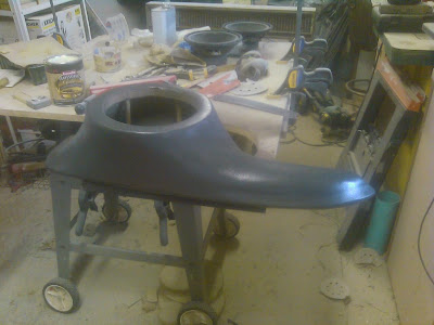

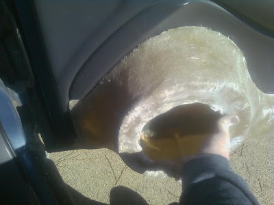

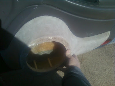

anthonyott99 Posted January 23, 2011 Author Report Posted January 23, 2011 Started on drivers door ! Mocking up speaker and bafffle, going to bring this one in slightly closer to the door, lots of test fitting !!! Second one is alot easier than the first !!!! Decided to try fleece this time , couple of dollars and was alot stretchier !!! First layers of resin Now the chop mat and resin, 3 layers :
Sir-Lancelot Posted January 23, 2011 Report Posted January 23, 2011 Great job man. They have a really nice flow on the door. 2001 Yukon XL Sitting on 35 x 12.50 x 20, XD Monsters Headunit: Clarion DXZ785USB Front: B&C 10NW64 10" Neodymium Woofer, Crescendo XST2 Rear: B&C 8NDL51 8" Neodymium Woofer, Crescendo XST2 Mids & Highs Amps: MB Quart DSC 4125, MB Quart DSC 480 Subs: 4 18" SSA ZCONS Sub Amps: 4 GP3K Pro Electrical: Iraggi 260a, 3 tejcurrent 240a, tejcurrent quad bracket Kinetik - 6 HC2400 My Build Log
