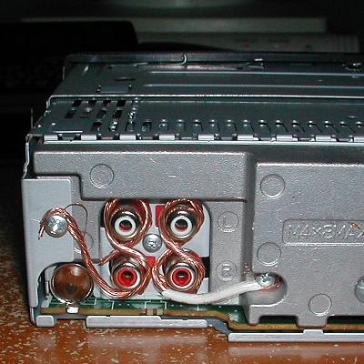

Really shouldn't have to do that though.... but it'll work... lol
