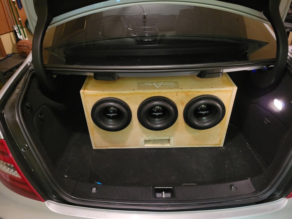

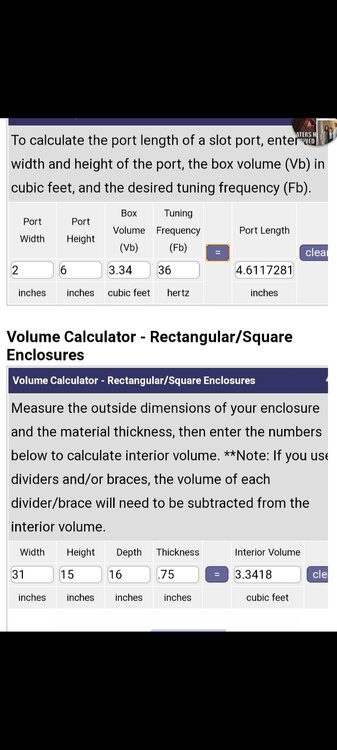

  2. Needing some advice. I have 3 skar audio evl8d2 in a ported box. Single chamber. Ran calculations through 12volt for tuning to 36hz. They said port needed to be 2x6x4.6. I have a funny feeling that that is no where big enough. Can someone with a little more experience look at the measurements and tell me what the proper port size should be? Box size is 31x15x16 with 3/4 birch.
