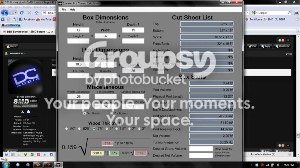

And the enclosure design(Anyone on here good with sketch up that can sketch up and make a cut list for me?
Also anyone know where to get some mossy oak or realtree fabric to wrap the box?
