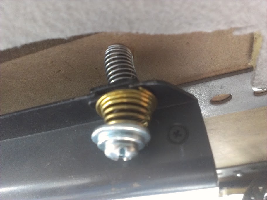

yea I did that for the gains on the eq, some electrical tape, but I am going to have to spring mount it to the celing, cause a direct mount like it is is going to destroy them, they are moving easily .5inches to 1 inch from the flex, and its beating the shit out of them, so if I put some springs in there, it should help dampen the hard hits from them

So Kicker Sent me a new crossover, and I decided to mount them with some shock absorbtion, since the ceiling was flexing so bad that it was beating the shit out of the eq and crossover. it works perfect btw, the eq and crossover just float while the bass hits, the springs keep them centered without any extra vibration, and it takes all the energy out.
I will get a video up soon of it working. This should also help with them overheating in the summer with the extra space between the ceiling, since it gets really hot in this car with all the deadening. I plan to build a fiberglass piece to cover them and put fans in them that may run 24/7, with a very low amperage pull, just to keep them from getting hot, at least in the summer
