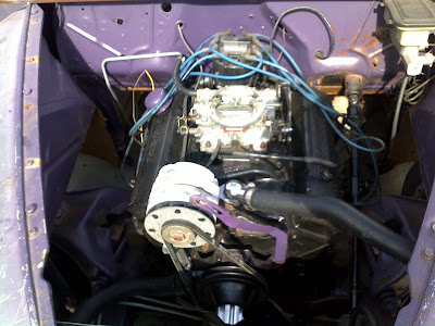

6berry Posted December 3, 2011 Author Report Posted December 3, 2011 sorry its not letting me put up a lot of the pics that were on another forum SLAMMED. you can kinda see in these pictures, the rocker panel was completely rusted out so i replace it with a 2x4 angle iron driveshaft hump some might hate that its a mopar with a chevy engine but i was 15 when i started this project and my neighbor offered me a free sbc and tranny so i took it. more work to the floor front bags. that cut is horribly ugly but it came like that on the frame. i shouldve fixed it before i put the body on but oh well ill fix it evertually. horrible picture but pretty weld 1999 Audi A4 1.8T::: 4 - DC Level 3 10's in a 4th order Rockford P6002 on Subs for now (3-3.5k coming eventually) MB Quart ONX4.60 for Mids and Highs Boston S50 Components in Front Boston S65 Coaxials in Rear 40 Sq Ft of Second Skin Damplifier Build Thread UBL 1948 Plymouth

6berry Posted December 3, 2011 Author Report Posted December 3, 2011 s10 steering column and brake pedal assembly and custom gas pedal front end pulled off. you can see the custom radiator mount and the radiator that goes to who knows what car that my neighbor also gave me front end lifted up my the bags my first time ever bending brake lines and steering shaft that i extended interior rear bags inflated the engine all running. and my custom alternator bracket (almost better than CJ's) 1999 Audi A4 1.8T::: 4 - DC Level 3 10's in a 4th order Rockford P6002 on Subs for now (3-3.5k coming eventually) MB Quart ONX4.60 for Mids and Highs Boston S50 Components in Front Boston S65 Coaxials in Rear 40 Sq Ft of Second Skin Damplifier Build Thread UBL 1948 Plymouth
