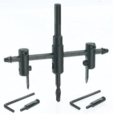

3.) If i do a PVC port a dude on youtube used a tool like this- 41ZoskACZ7L._SX385_.jpg and i wanna know can you use this tool with a drill like this- 31JqekWsXuL.jpg?

3)ive only seen those used on drill presses do u have a jig saw?
