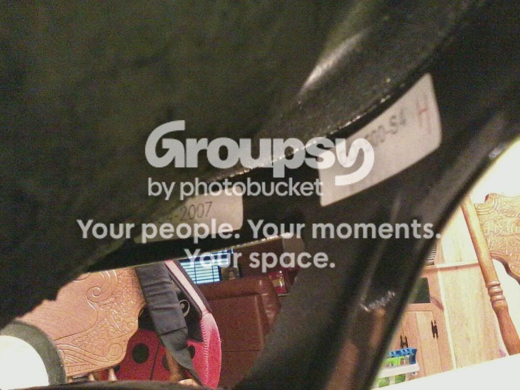

randyman78596 Posted July 31, 2013 Author Report Posted July 31, 2013 my buddy told me that it was a 2500 model and it takes 600 but i looked at the other stickers under the basket and it says its a 1500 series...my bud was confused.. [/url]">http://http://s1349.photobucket.com/user/Randy_Robles/media/DDPIC_zpsefa8724a.jpg.html'>
Bump4life Posted July 31, 2013 Report Posted July 31, 2013 yea I didnt think that they made the 2500 series in SVC either way, same specs. maybe bring down NET to 1.5-1.75, all other specs the same Buyer/Seller Feedback Thread: http://www.stevemead...5015-bump4life/ MB C220 153 Trunk Car Build Log: http://www.stevemead...d/#entry1840136 MB C280 Ipad Dash SQ Build Log: http://www.stevemeadedesigns.com/board/topic/194484-bump4lifes-new-benz-tony-c-relay-kit-pictures-ce-electric-audison-front-stage-installed/ My SPL Log: http://www.stevemead...__fromsearch__1 BMW M340 xDrive Stock, for now. Corner Load 10" maybe soon. But does 10s in the 1/4... Best Scores out of a trunk 153.0 sealed legal full tilt clamped 5524 @ 42 hz 154+ windows down, 155+ kick
