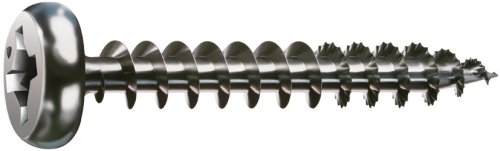

If you want something that grips better for screwing in the subs, I'd reccomend spax screws, best screws I've used so far, and not more than the other brands at home depot.

I used T-nuts and #8-32 by 1 1/2" screws, it's just that they came loose, the T-nuts are fine.
