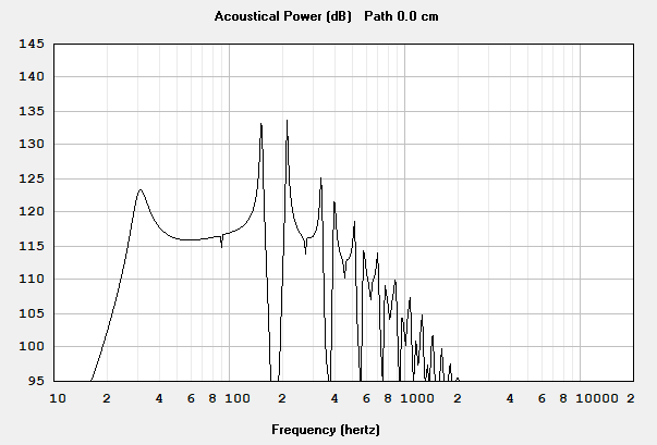

My suggestion for an enclosure would be about 62 sq in of line area tuned to around 30 Hz (~108" total line length) with the sub placed 1/3 from the closed end.  Here is the raw frequency response:
Making the line 62 sq in instead of something larger reduces the peak in output around tuning.  There is still a significant peak, but you can dial that down by putting some polyfill in the line and adjusting it until you get the sound you want.  Its better to error a bit on the high side and not eliminate the peak completely by reducing line area because you can always add polyfill to take the peak down, but you can't do anything if you made the line area too small.
By placing the sub 1/3 down the line you eliminate the big peak that would be at 90 Hz and subsequent dip that would be right around 120 Hz.  As such you should get good output to well over 100 Hz if you so desire.

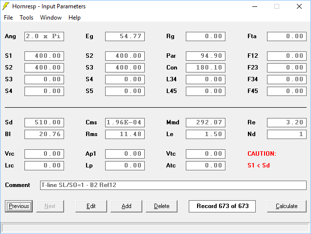

Just in case you want to play around with HornResp, here is the inputs I used:

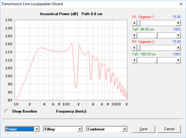

It does look peaky, but my experience is those peaks aren't as pronounced as HornResp makes them look.  A little polyfil will tone that peak down significantly.  Here is how the frequency response looks with just 4 oz of polyfil added, and you could certainly add more:
