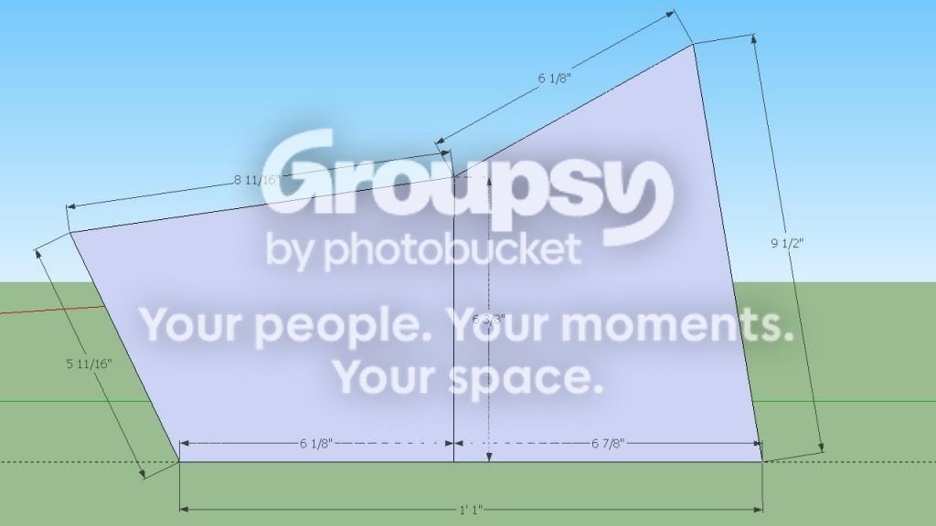

Robert8252 Posted June 28, 2014 Report Posted June 28, 2014 Good news kind of, atleast not what I was expecting. The skeleton I made fits perfect under the seat, does not require it to be lifted at all. By the time you make a box with 1/2" or 3/4" mdf and leave atleast 1.5" for downfiring if not around 2 you have right around 4" mounting depth which limits back to most shallow subs not including Sundown's SD line which are closer to 5". What I didn't expect was that by slightly angling the front like I did which flow with the seats angle I'm 90% sure you can front fire any 8" you want. Here's pics of a 2012 DC M2 8" behind the skeleton. Downfiring, just remember you need to subtract atleast 2-3"s for wood and baffle clearance. But what I didn't expect 2013 F150 Crew Cab Old Build Log Feedback 2013 F150 Equipment - Some Awesome Stereo Sound Making Stuff

Robert8252 Posted June 29, 2014 Report Posted June 29, 2014 Here's actual dimensions and the second pic has the dimensions you will need to get the angles right. 2013 F150 Crew Cab Old Build Log Feedback 2013 F150 Equipment - Some Awesome Stereo Sound Making Stuff

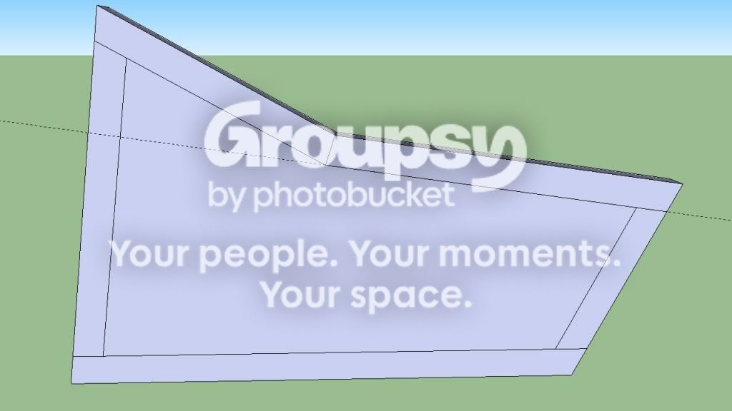

Robert8252 Posted June 29, 2014 Report Posted June 29, 2014 Even better to save you math. If you build it exactly like the dimensions out of 3/4" and miter as shown in this pic the area of airspace is 62.71 inches. Simply multiply your box inner box width for cubic inches. I have a full box design for sketchup for a single 8 inch with 1 cube net and a 4" aero tuned to 37. Tuning can be changed without effecting much, a 3" aero will tune lower easier. I'll upload it tomorrow. Can I share files from dropbox? 2013 F150 Crew Cab Old Build Log Feedback 2013 F150 Equipment - Some Awesome Stereo Sound Making Stuff
