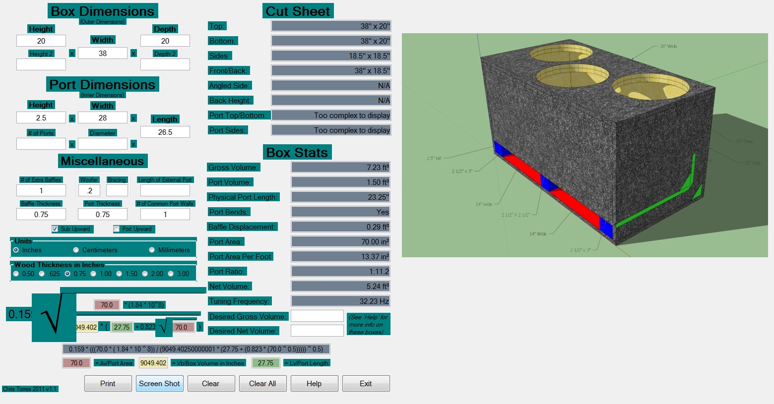

Here is my current box with the torres info... It is loaded with 3 level 4 12's and looking to swap the baffle out and load the box with a pair of XL 15's... Building a new box might be out of the question do to lack of resources at my current location... The box is made out of 3/4 ply and is braced on all major corners with a 45 block to reinforce the box the best we could... It plays rather well now but just want to make sure it will be usable with the new 15's... Thanks for your time.. and here is the pic...

Running on my 5k Will... right now the 3 level 4's are doing just fine...
