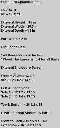

I'm looking for a ported box with 1.55cf-1.75cf and tuned for 35hz.

So here is a suggestion, power: to sub rated, amp subsonic filter to 30Hz, minimum port clearance 2", figure is just an assembly guide:
NOTE: If building outside you need to build a cardboard dummy box to test fit in it's way inside.
