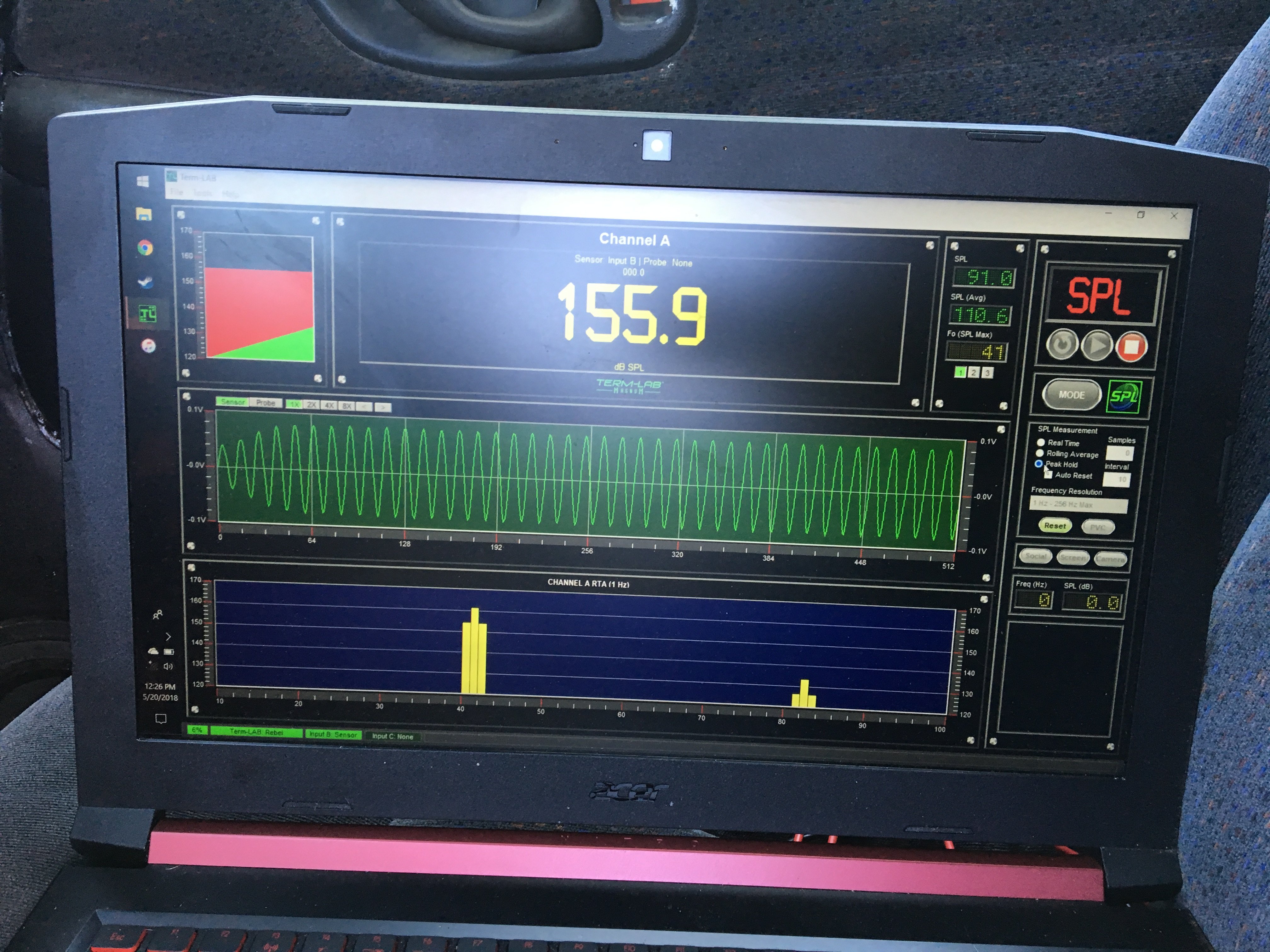

Well, come to find out one of my amps isn’t putting out any power. So this whole time One of my subs has only been playing on one coil. So I hooked up just two amps for now. Each 3500 wired at .35 ohm to each sub. Gained over a db by writing up the two amps! Does over a 155 now!  I’ll have to pull the amp and take a look. Hope its an easy fix.

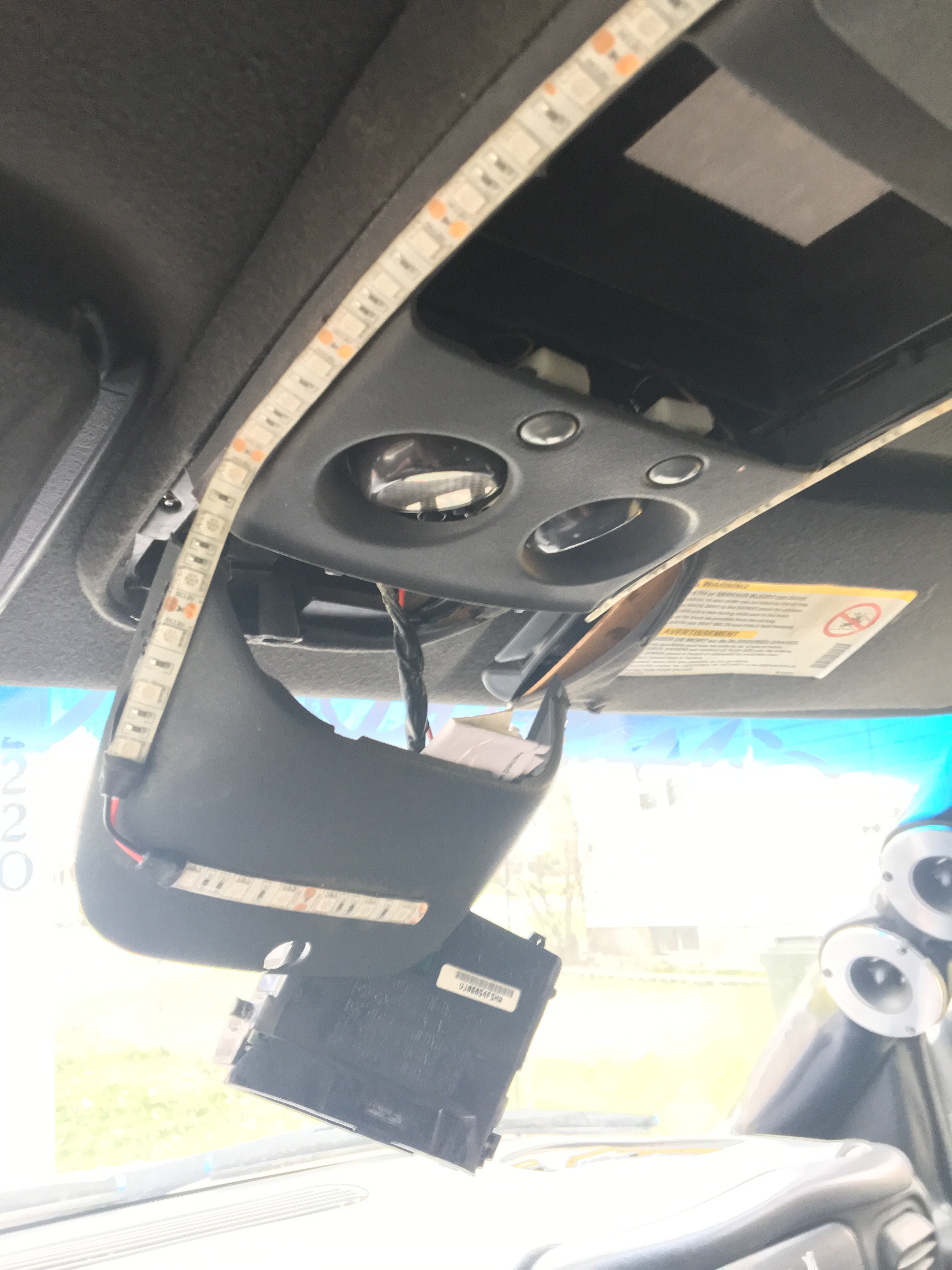

Overhead console doesn’t like the wall too much. Lol

I took a look at the 3500 I didn’t think was working, and wouldn’t you know it. It works now! Lol. Hooked up all 4 and did some testing. Didn’t gain much. Got sooooo close to 156, but could only pull off a 155.9. They get a lot warmer much faster with an amp per coil and not much louder on the meter, so I just went back to running a 3500 at .35 each.
Hammered on them all day at automotion and even had a couple tapouts. Got subs so hot you could almost burn yourself on the dust cap, but didn’t smell them at all, and they just kept taking it. :)

your loss of gain with adding additional power could be because box is too big for the additional power you added.  I ran into that exact same issue before.  With a recalculated box from before and the additional power they do ok now.
:ninja:
Think shrinking the box a bit would help? It’s 12 cubes net after all displacement right now
for the additional power i think it would.. u have 2 18's currently correct>?
