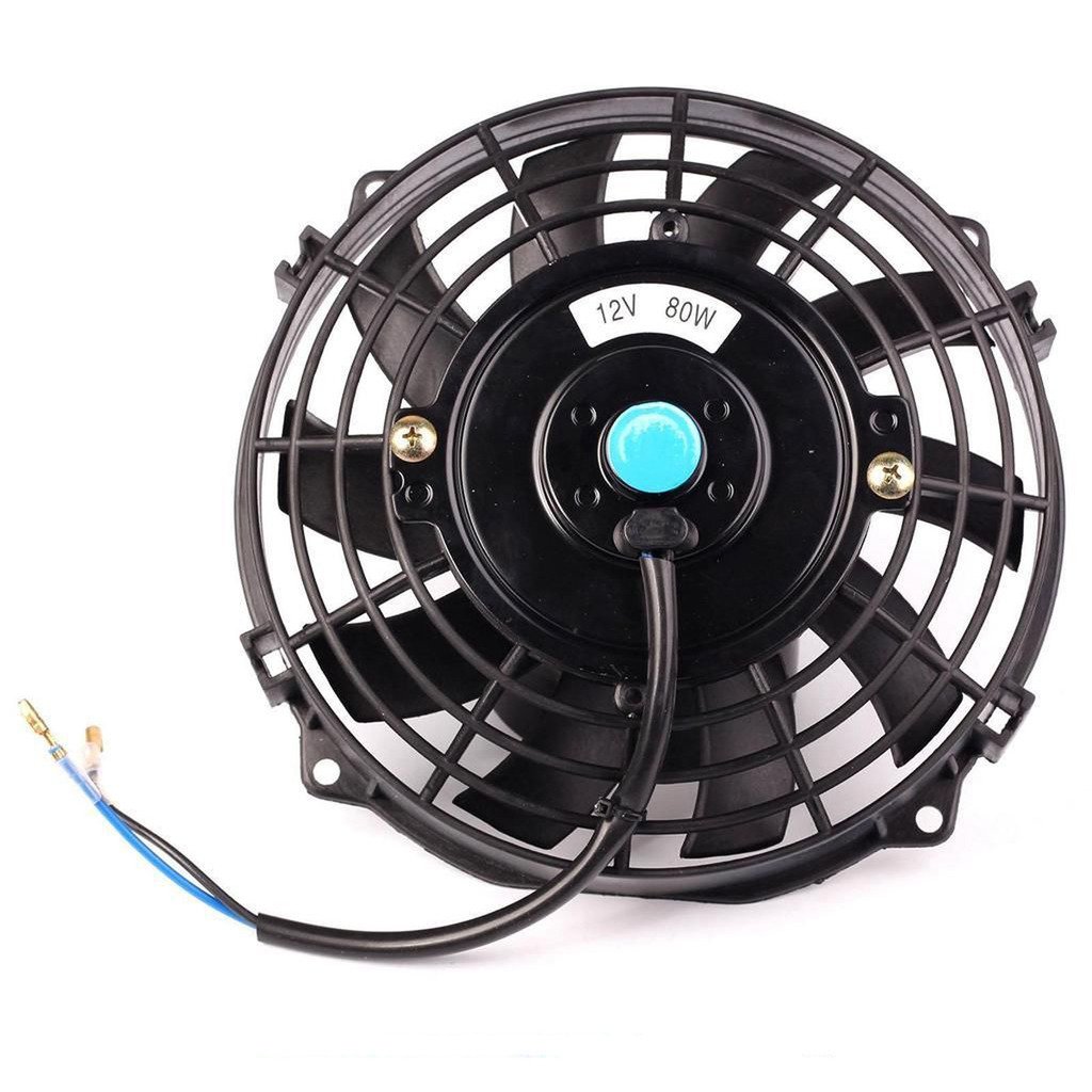

Smoove Posted April 25, 2016 Report Posted April 25, 2016 How do setup a fan speed controller on 2 of these fans? 1 fan on the left side of my battery box front panel will be pushing and 1 fan on the right side side of my battery box will be pulling. I will be making a new panel on to be used during the PHX summer heat. The goal is to setup that fans and keep the batteries cool while demoing this summer. Story behind the cooling. These is based on from when I noticed the issue. We had a couple bass meets last year when it was like 107 degrees at 7pm. Mechman charge voltage didnt drop below like 14.3v the 3 batteries closest to my front to back runs vented and of course corrosion appeared between the post and my terminals. what does this mean, I was charging to high for the tempature the batteries were at. And no the plexiglass cover wasnt on while I was demoing. other things learned last summer. when it's a sunny day and 105 out. the tonneau cover is like 180 the batteries are like 128 and the terminals are like 140. <-- this was resting, no charging No this issue didnt happen to just me last year. there was a couple of us. Batteries are still good and I wanna keep them that way http://www.amazon.com/Electric-Radiator-Cooling-Mount-Unversal/dp/B014KK7M06/ref=sr_1_20?s=pc&ie=UTF8&qid=1460401028&sr=8-20&keywords=10%22+inch+Black+Slim+Fan+Push+Pull+Electric+Radiator+Cooling 2 Team Fi 15's v1 2 DD M5's 970amps of Alt 6th order blowthroughThe truck Blowthrough build : http://www.stevemeadedesigns.com/board/topic/155555-smooves-1996-chevy-ext-cab-c1500-slow-build/The 350z build : http://www.stevemeadedesigns.com/board/topic/170694-smooves-2003-nissan-350z/ My FB page https://www.facebook.com/pages/Smooves-Car-Audio-and-performance/719746144805343 Team Fi Audio http://www.ficaraudio.com/
rockFord_Expedition Posted April 25, 2016 Report Posted April 25, 2016 Hey bro, I know that you know what youre doing, but since you posted, I will toss in my $.02 I would just wire the fans to come on either a) when you start the truck or when you turn on the system. I say that because it's not like the draw from those fans is going to kill your voltage, for like 9 months out of the year theyd be on all the time anyways, even with a temp sensor switch, and last but not least, it's less work. If you really want to do it, I would just get a TM-1 from the man. Old School/New School RF Build March 2015 SOTM Winner How to crimp large wire

Smoove Posted April 25, 2016 Author Report Posted April 25, 2016 Didn't steve use one of his temp meters on one of those fans for the shop pony Hey bro, I know that you know what youre doing, but since you posted, I will toss in my $.02 I would just wire the fans to come on either a) when you start the truck or when you turn on the system. I say that because it's not like the draw from those fans is going to kill your voltage, for like 9 months out of the year theyd be on all the time anyways, even with a temp sensor switch, and last but not least, it's less work. If you really want to do it, I would just get a TM-1 from the man. And the TM-1 is a good idea. UGH!!!!! 9months out of the just sucks. Didn't steve use one of his temp meters on one of those fans for the shop pony I forgot about that he did that setup because of noise. I am just hoping to not have them run full tilt until needed. Since the truck is not my daily, I also like to have them run about half speed when the truck is parked. 2 Team Fi 15's v1 2 DD M5's 970amps of Alt 6th order blowthroughThe truck Blowthrough build : http://www.stevemeadedesigns.com/board/topic/155555-smooves-1996-chevy-ext-cab-c1500-slow-build/The 350z build : http://www.stevemeadedesigns.com/board/topic/170694-smooves-2003-nissan-350z/ My FB page https://www.facebook.com/pages/Smooves-Car-Audio-and-performance/719746144805343 Team Fi Audio http://www.ficaraudio.com/
Clownrock95 Posted April 25, 2016 Report Posted April 25, 2016 Didn't steve use one of his temp meters on one of those fans for the shop pony Hey bro, I know that you know what youre doing, but since you posted, I will toss in my $.02 I would just wire the fans to come on either a) when you start the truck or when you turn on the system. I say that because it's not like the draw from those fans is going to kill your voltage, for like 9 months out of the year theyd be on all the time anyways, even with a temp sensor switch, and last but not least, it's less work. If you really want to do it, I would just get a TM-1 from the man. And the TM-1 is a good idea. UGH!!!!! 9months out of the just sucks. Didn't steve use one of his temp meters on one of those fans for the shop pony I forgot about that he did that setup because of noise. I am just hoping to not have them run full tilt until needed. Since the truck is not my daily, I also like to have them run about half speed when the truck is parked. iirc in the shop pony vid he has them set to 3 stages off medium and high
