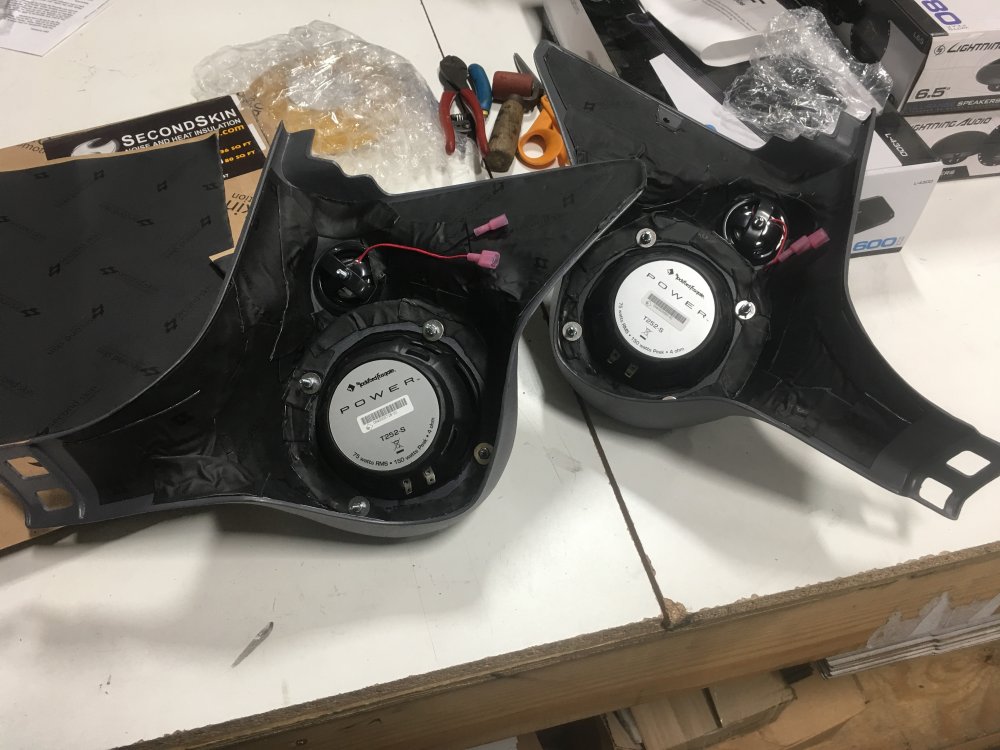

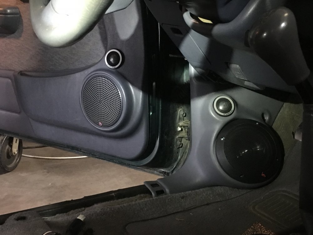

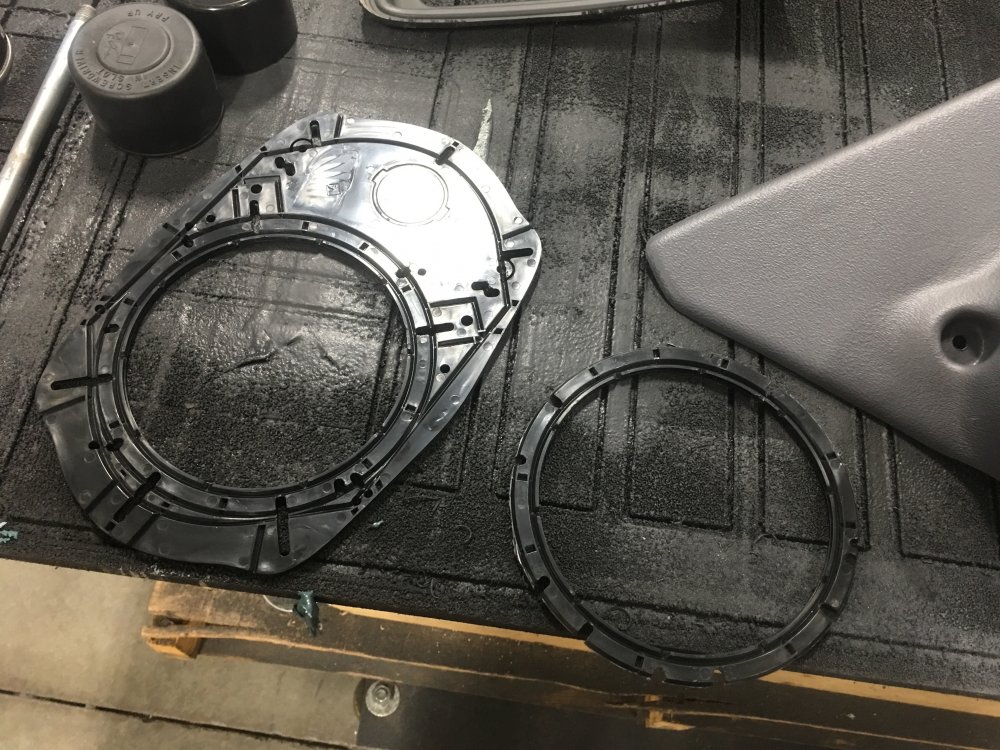

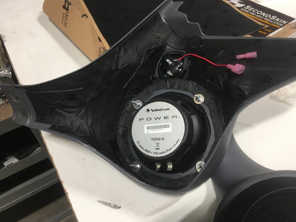

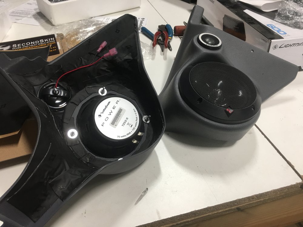

We finally got to his mids/highs...amp was hooked up the entire time but nothing was on it. His old amp under the seat used to run his old coaxials. I busted him out some custom made CNC door adapters sealed with Second Skin Audio Damp-Rope and Damplifier Pro. They sound great! check out the video

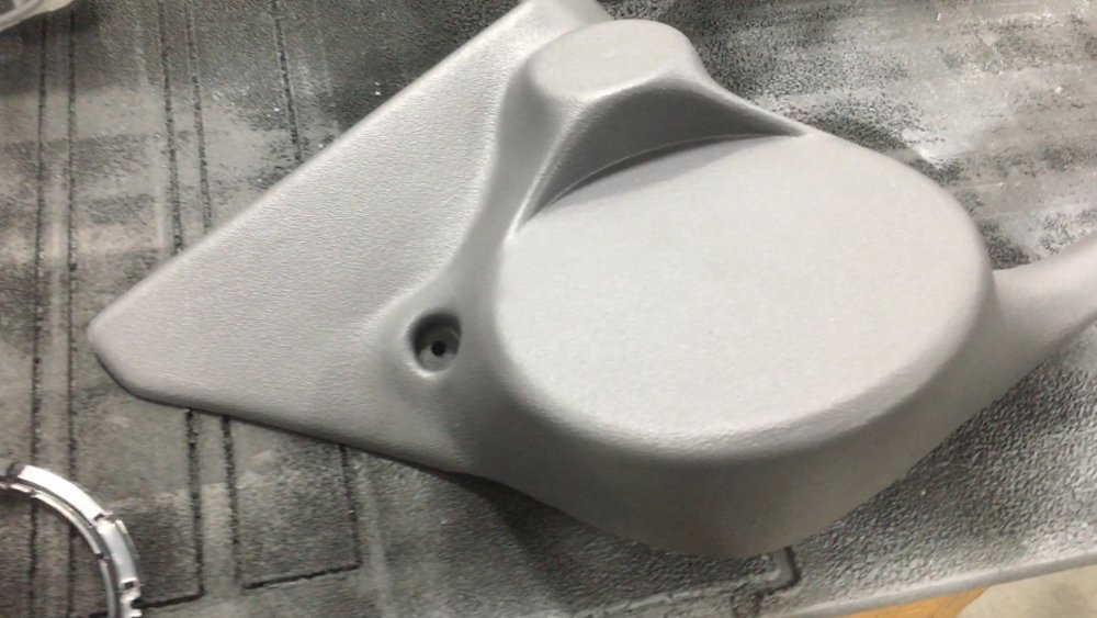

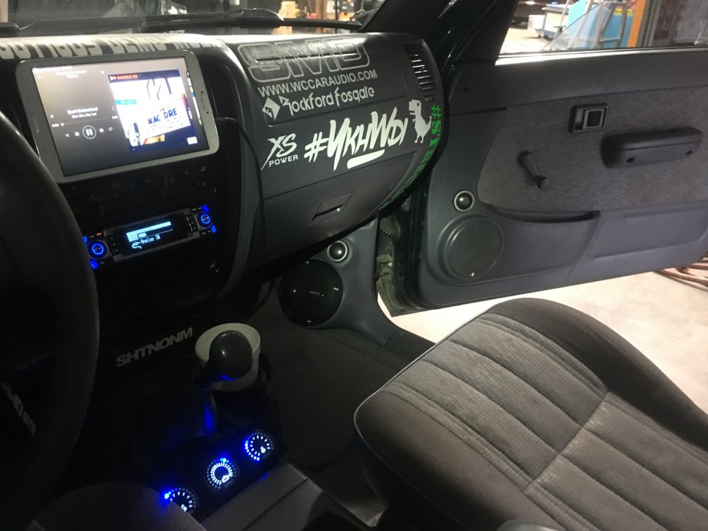

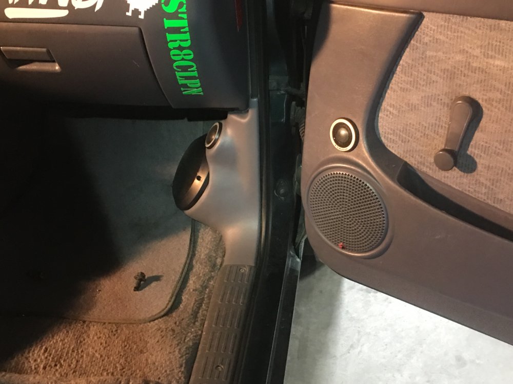

hey steve how far out does the drivers pod stick? Any chance you could take a pic please?

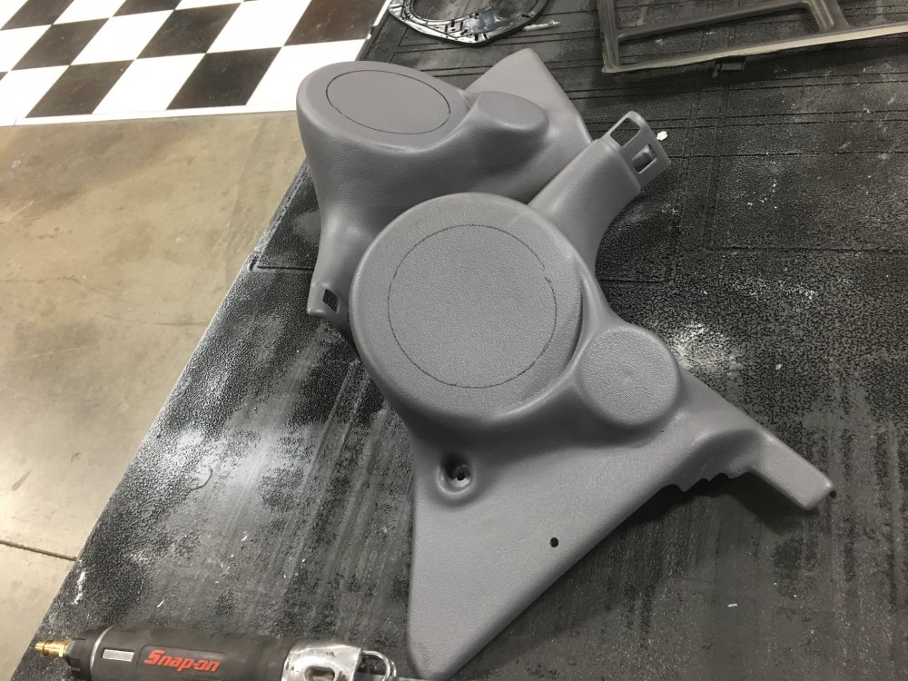

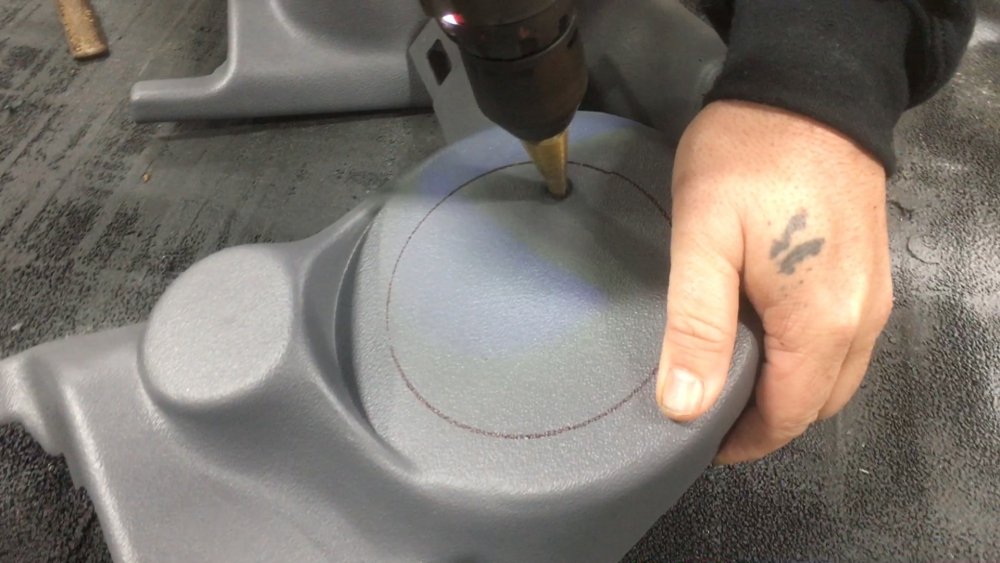

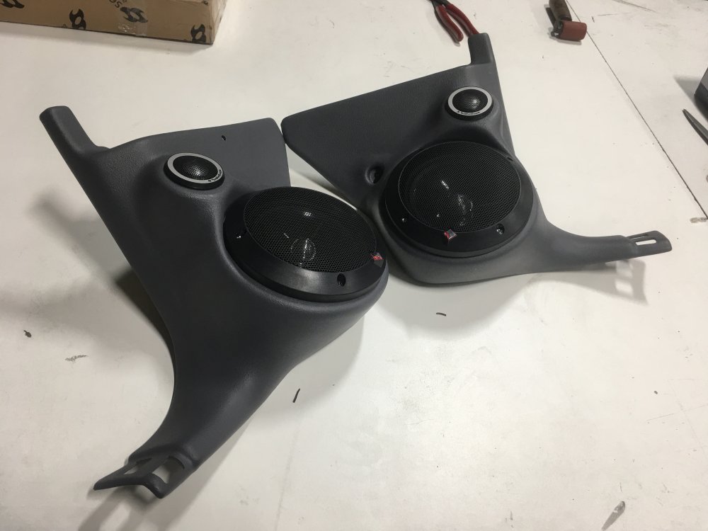

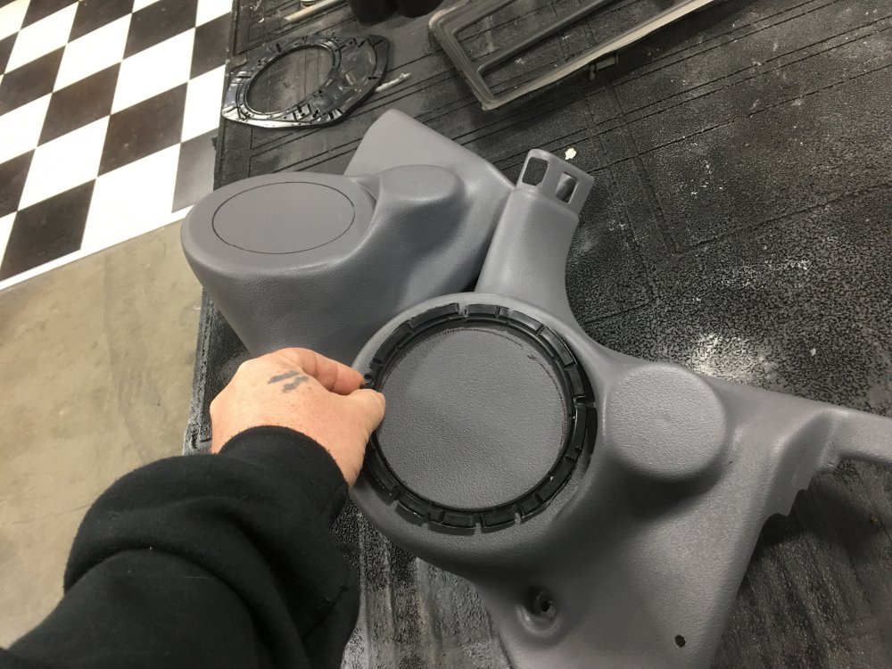

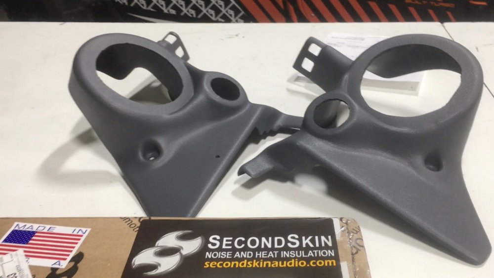

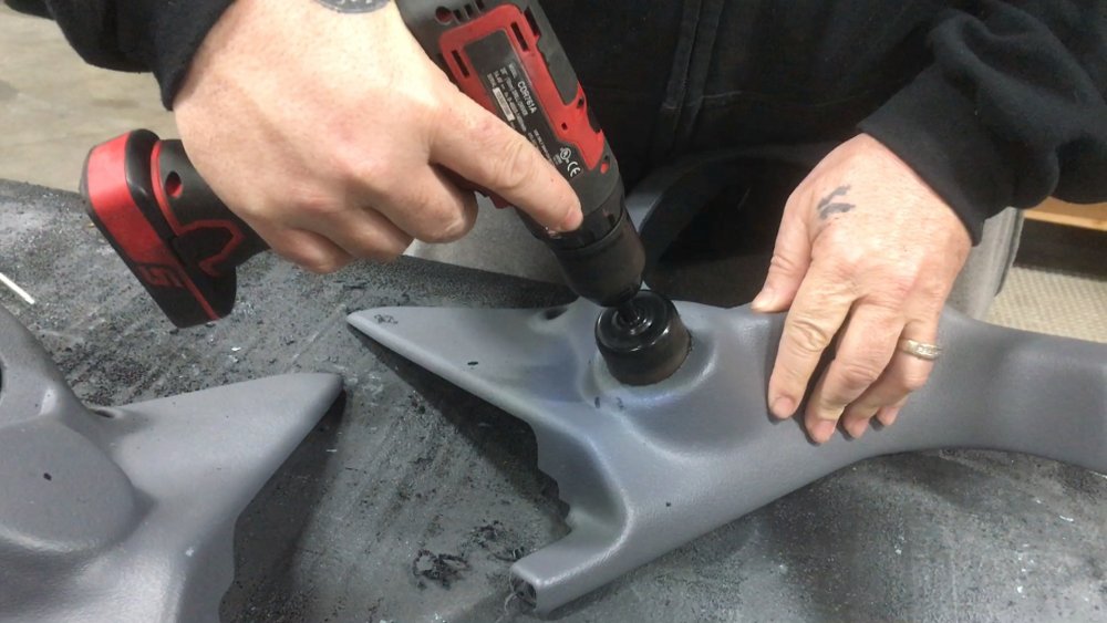

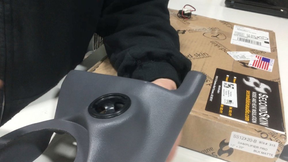

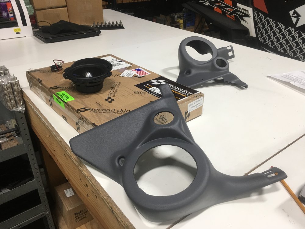

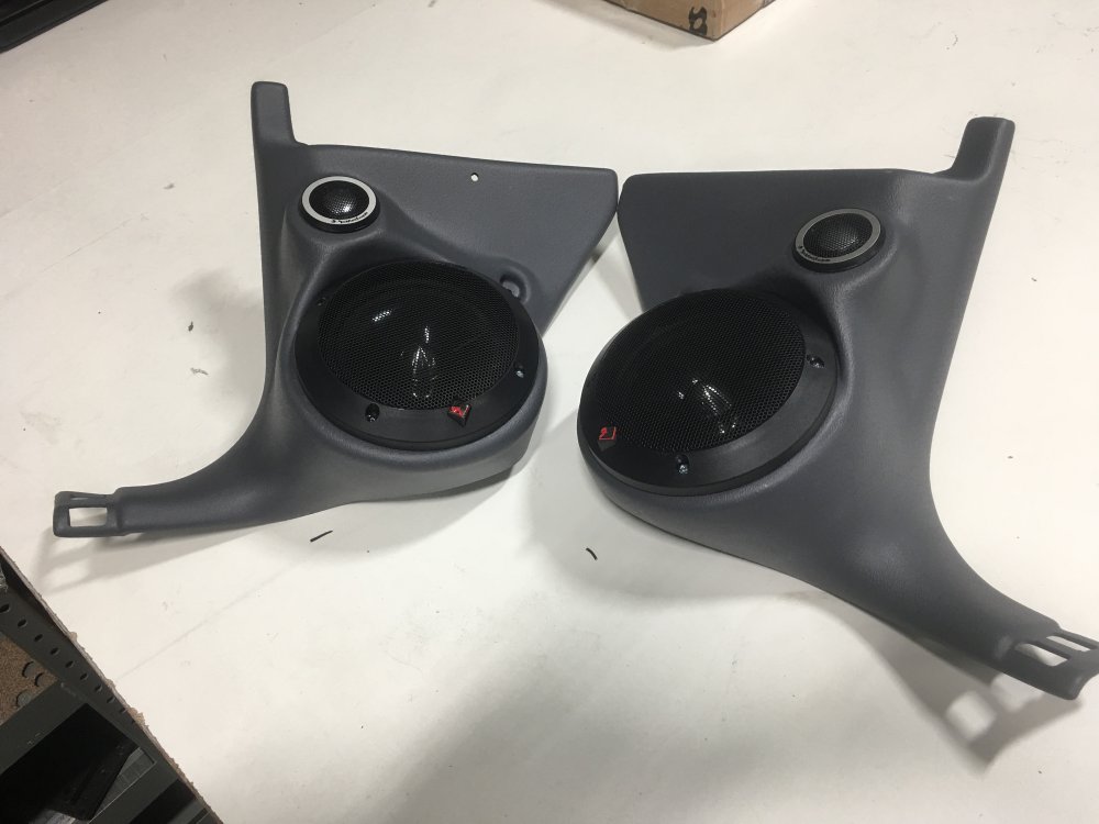

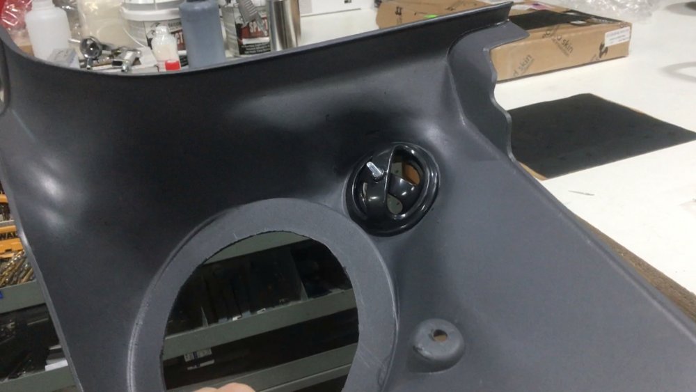

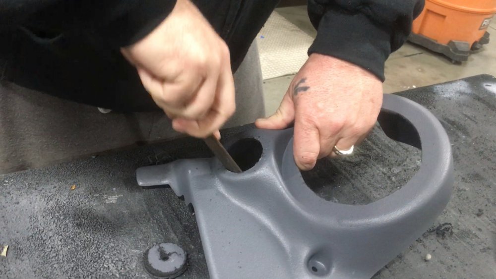

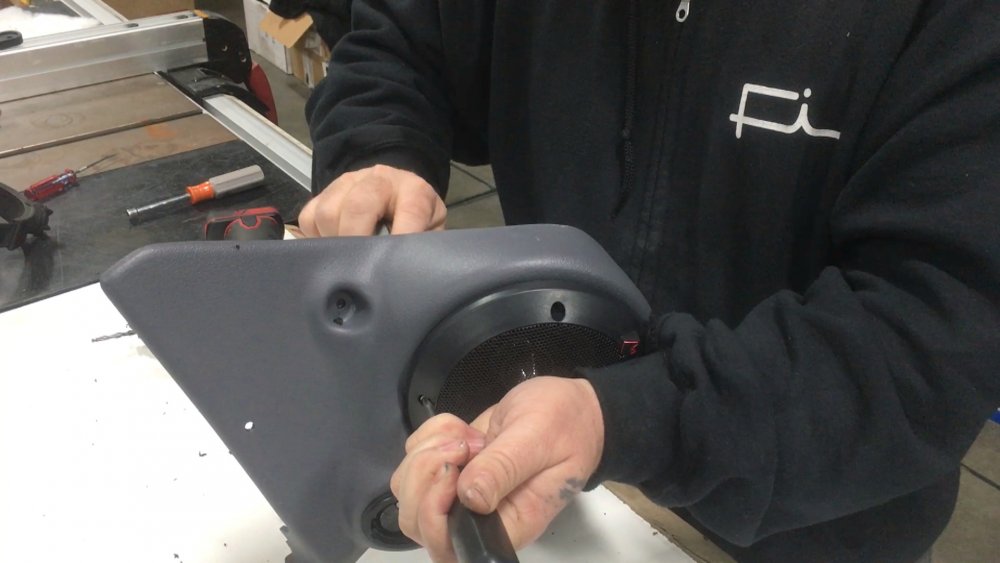

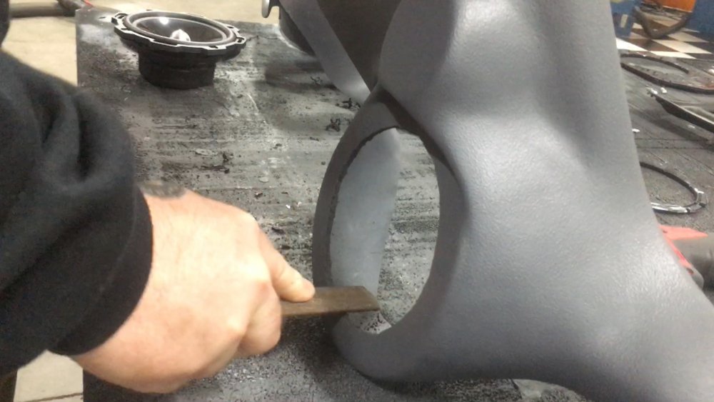

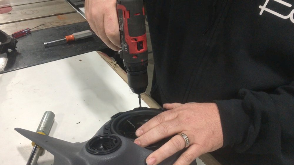

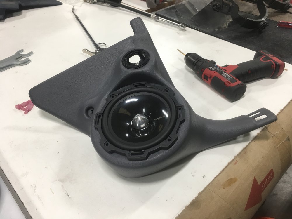

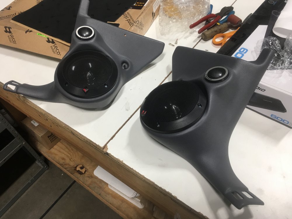

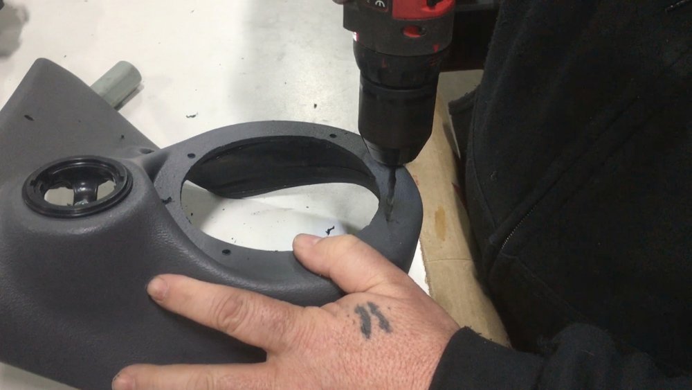

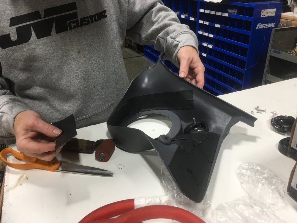

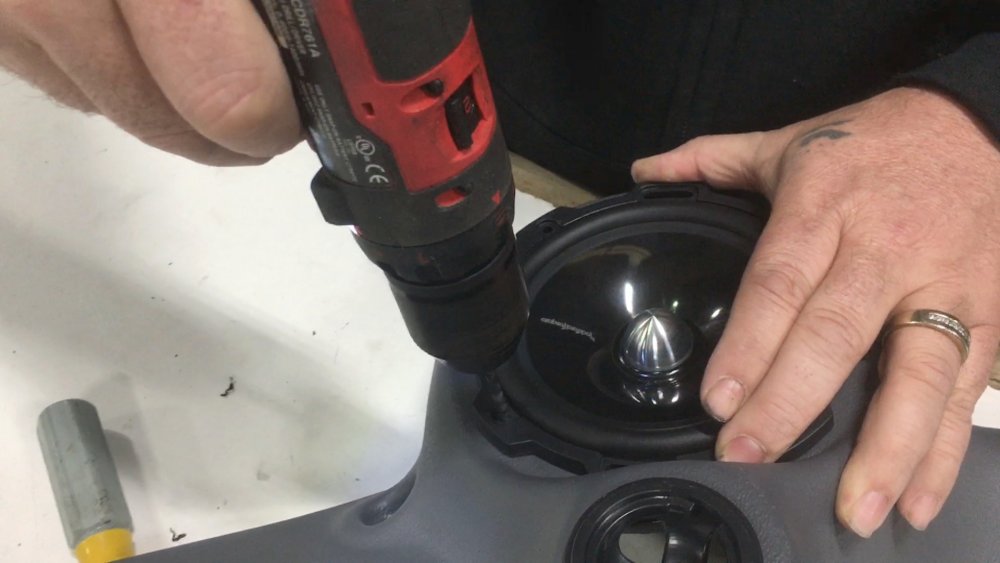

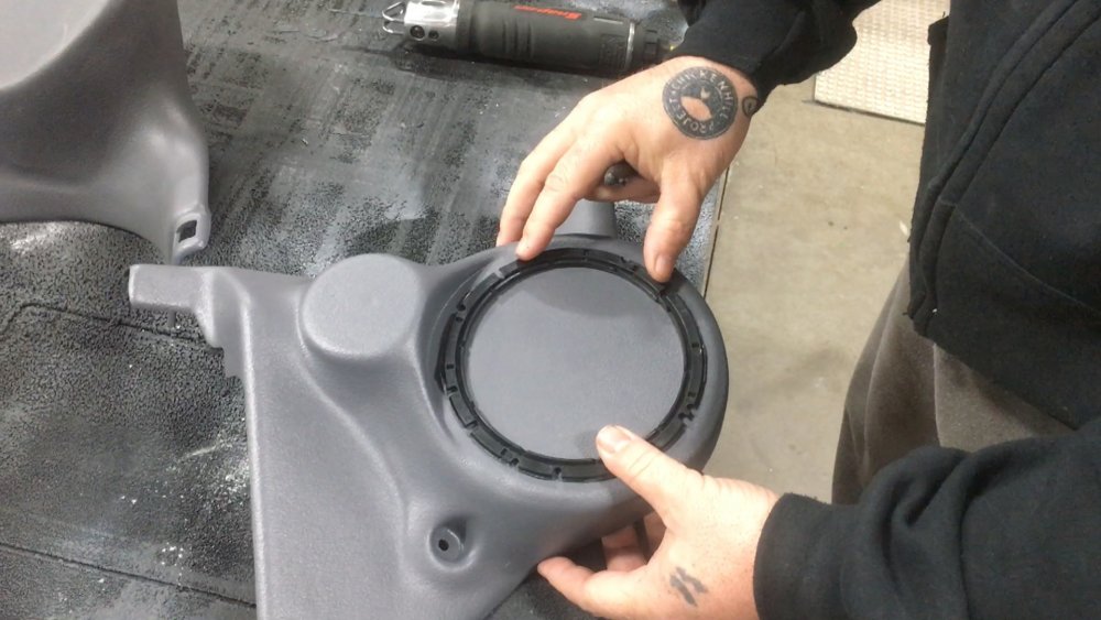

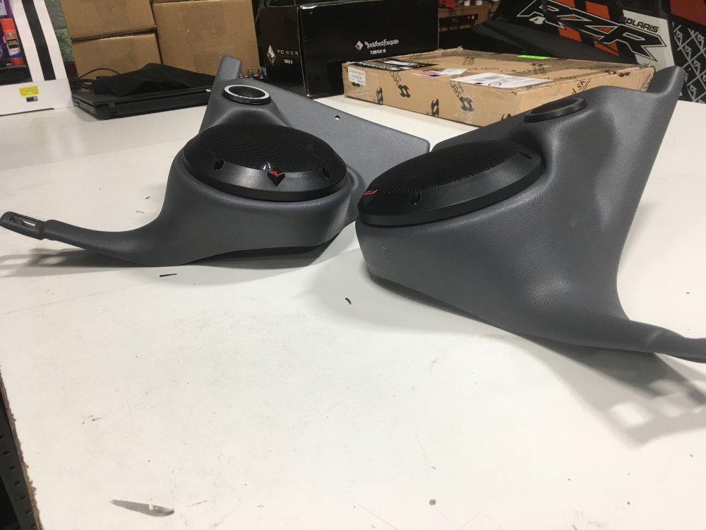

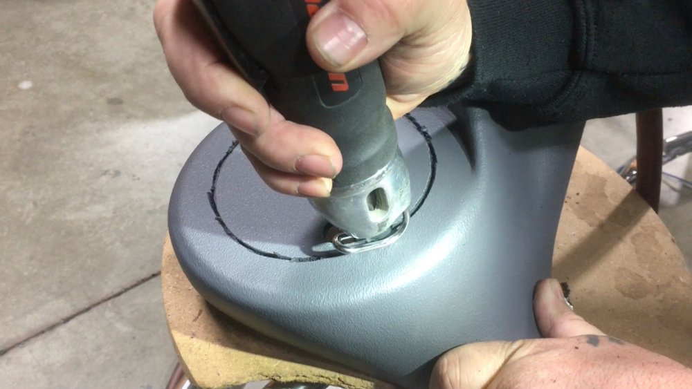

these kick panels were supposedly made for 6.5" speakers but there is no fucking way.  Unless you don't mind them sticking over the edge over an inch. UGLY.  We got him some 5.25's and called it done.  They fit great!

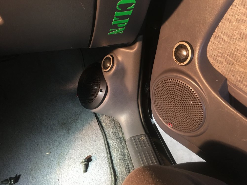

not far at all.  The pics you see are the pics i have for now.  I am gonna start a video here in a minute.
