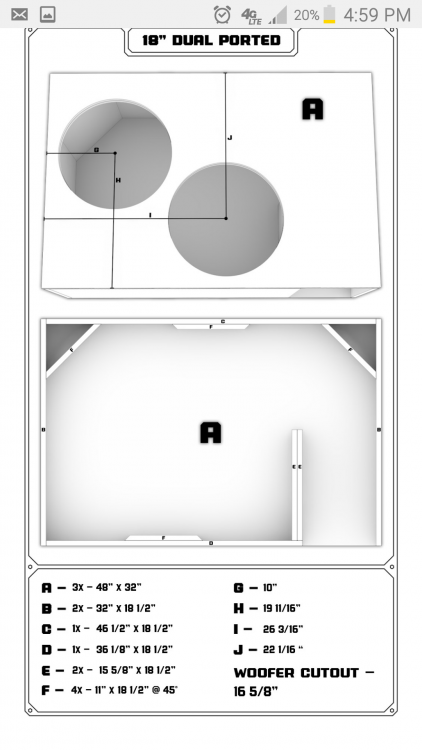

Blake21 Posted March 11, 2017 Author Report Posted March 11, 2017 Well gonna gut the truck tomorrow, I am thinking I will build this box I've posted as a temporary box because I plan to buy 2 more hdc3 18s in a month or 2 and then I'll work on the wall. Ive been reading up and did not realize how much work it is and I don't think I need it for 2 18s

Blake21 Posted March 11, 2017 Author Report Posted March 11, 2017 What mistake? It's 53.5" at the top, need to know if I should wall it or build the box I've posted a drawing of, I think a wall would get louder because it'll seal the entire rear of the truck but I have no idea about how to get started on a wall
Blake21 Posted March 11, 2017 Author Report Posted March 11, 2017 If I build the wall, could I just frame it up and then use mdf sheets to fill that in and create a box, but then it's just a huge box I want know the tuning or any of that

ShadeTreeMechanic Posted March 11, 2017 Report Posted March 11, 2017 15 hours ago, Blake21 said: Will this box work? It's on the soundqubed website last time I checked that out, It seems to me that the tuning was kind of high for me like 45hz or something. I would rather have 32hz or 34hz. 91 C350 Centurion conversion ( Four Door One Ton Bronco) 250A Alternator (Second Alternator Coming Soon) G65 AGM Up Front / Two G31 AGM in Back Pioneer 80PRS CT Sounds AT125.2 / CT Sounds 6.5 Strato Pro component Front Stage CT Sounds AT125.2 / Lanzar Pro 8" coax w/compression horn tweeter Rear Fill FSD 5000D 1/2 ohm (SoundQubed 7k Coming Soon) Two HDS315 Four Qubes Each 34hz (Two HDC3.118 and New Box Coming Soon)
ShadeTreeMechanic Posted March 11, 2017 Report Posted March 11, 2017 Maybe some one could put up some good links for winsd and Torres? These two programs will enable you to figure out what the box volume and port size need to be. Do a search here for some wall builds to see what it takes to build a wall. The walls usually need to be several layers thick because of the long unsupported sides that it takes to make a box that big. This eats up box volume and will need to be accounted for. We can help you with a box very easily but a wall is a different animal. So do some research and planning and ask us lots of questions. 91 C350 Centurion conversion ( Four Door One Ton Bronco) 250A Alternator (Second Alternator Coming Soon) G65 AGM Up Front / Two G31 AGM in Back Pioneer 80PRS CT Sounds AT125.2 / CT Sounds 6.5 Strato Pro component Front Stage CT Sounds AT125.2 / Lanzar Pro 8" coax w/compression horn tweeter Rear Fill FSD 5000D 1/2 ohm (SoundQubed 7k Coming Soon) Two HDS315 Four Qubes Each 34hz (Two HDC3.118 and New Box Coming Soon)
Blake21 Posted March 11, 2017 Author Report Posted March 11, 2017 Yea I'm hoping to tune around 32 but don't know what I would need to change on this box to get that
