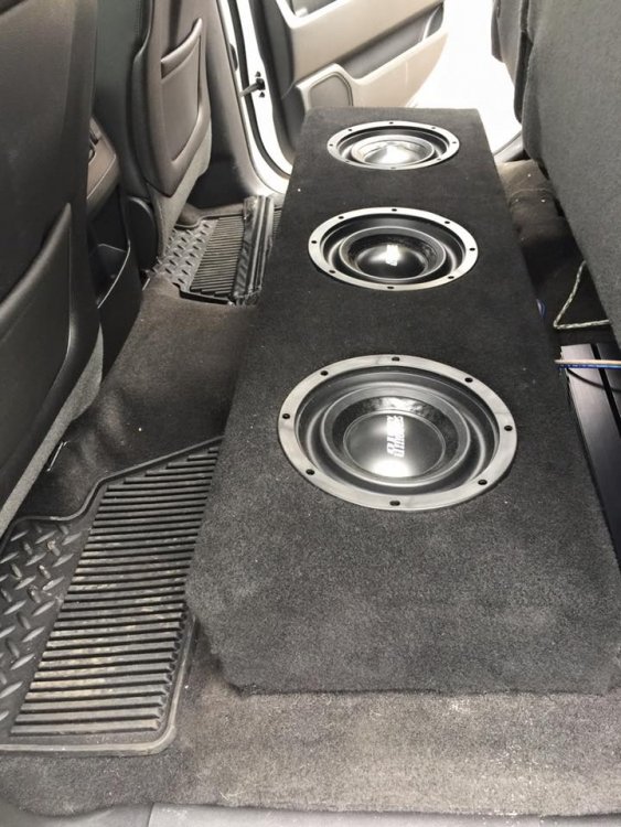

I put 3 10s in a co-workers 15 silverado double cab, sundown SD310 shallows on a SCV2000, shit slammed pretty good, where are you located? he sold the truck and is selling them..
BTW we did raise the seat with 3/4" mdf spacer on each stud
i dont have a ton of pics, i built and installed it for him, now its out in his garage- picked up a yukon cause he got the itch for more bass..
the bottom of the box was flat.. now i know there is a very slight bump in the floor like a "trans tunnel" which i stomped flat too make the box sit flat
