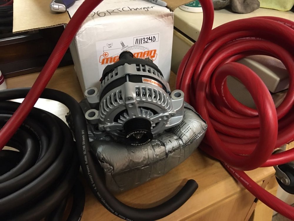

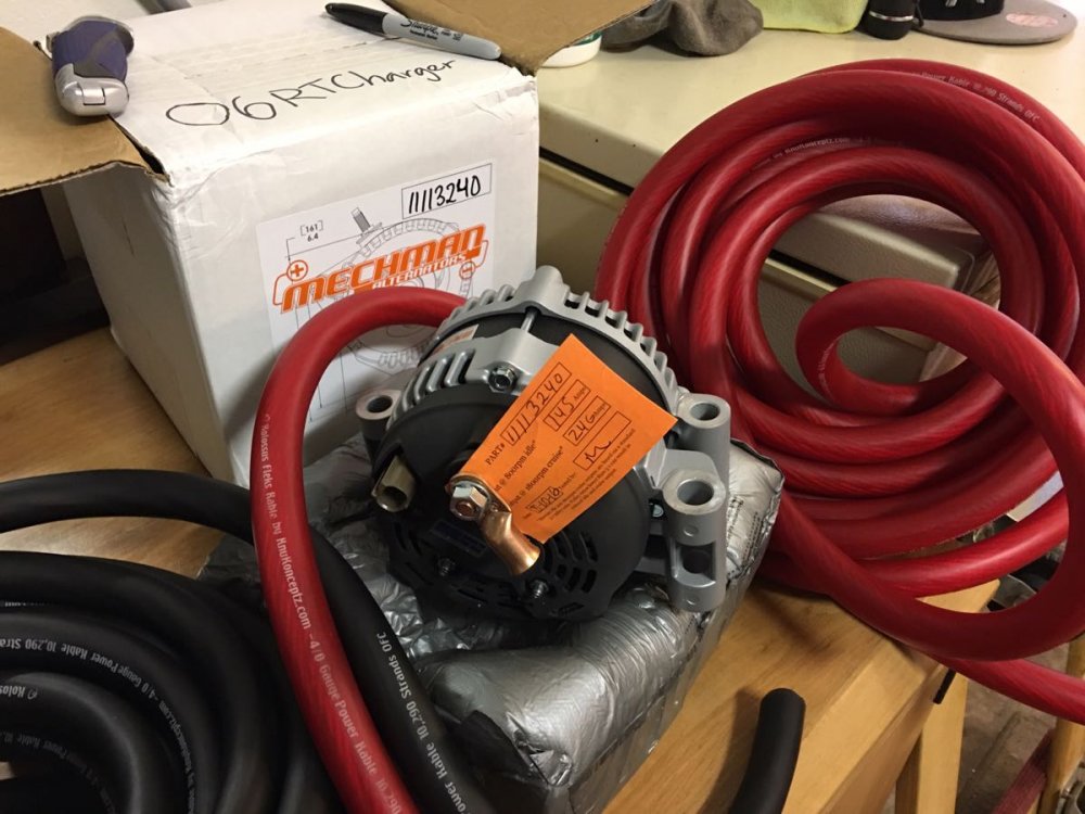

Theres my Mechman 240 alt with my Knu 4/0 (0000aught), ill be running 4/0 for big 3-4 and for front to back run to stock location rear battery.

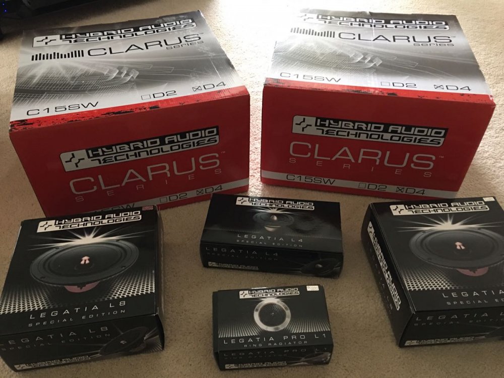

Heres what ill be installing eventually, didnt know how long this shit takes. Doesnt help i dont know what im doing most the time.

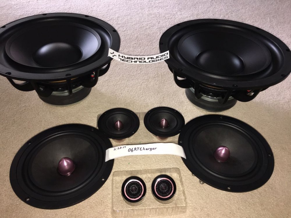

Subs- Two Clarus C15SW dual 4ohm
Midbass-Legatia L8SE
Midrange-Legatia L4SE
Highs-Legatia L1ProR2 tweeters

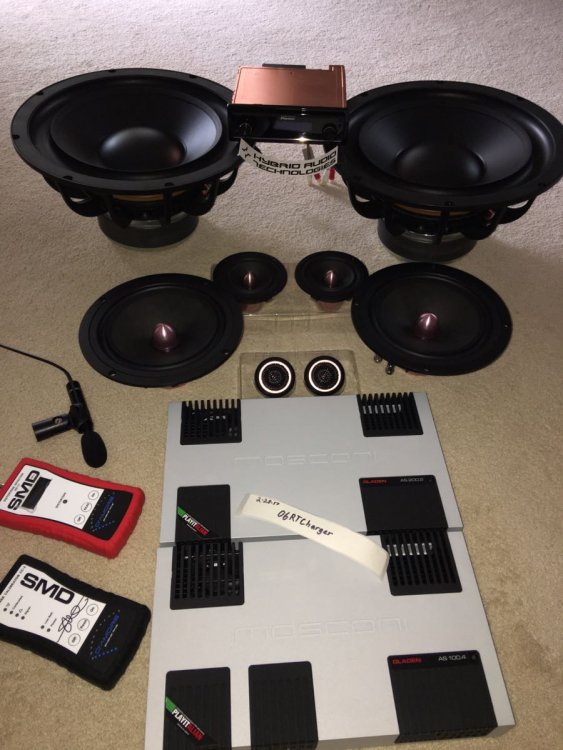

Amps so far
Midbass 2 channel amp- Mosconi AS200.2
Midrange and highs 4 channel amp- Mosconi AS100.4

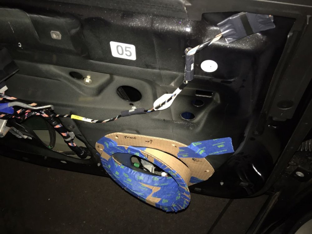

RenderedContent-B5C30B69-912F-449D-B9AE-F9F3379B729B.thumb.JPG.433d35083dc8acdaf2e283b716ec1ac0.JPGI
all HAT speakers

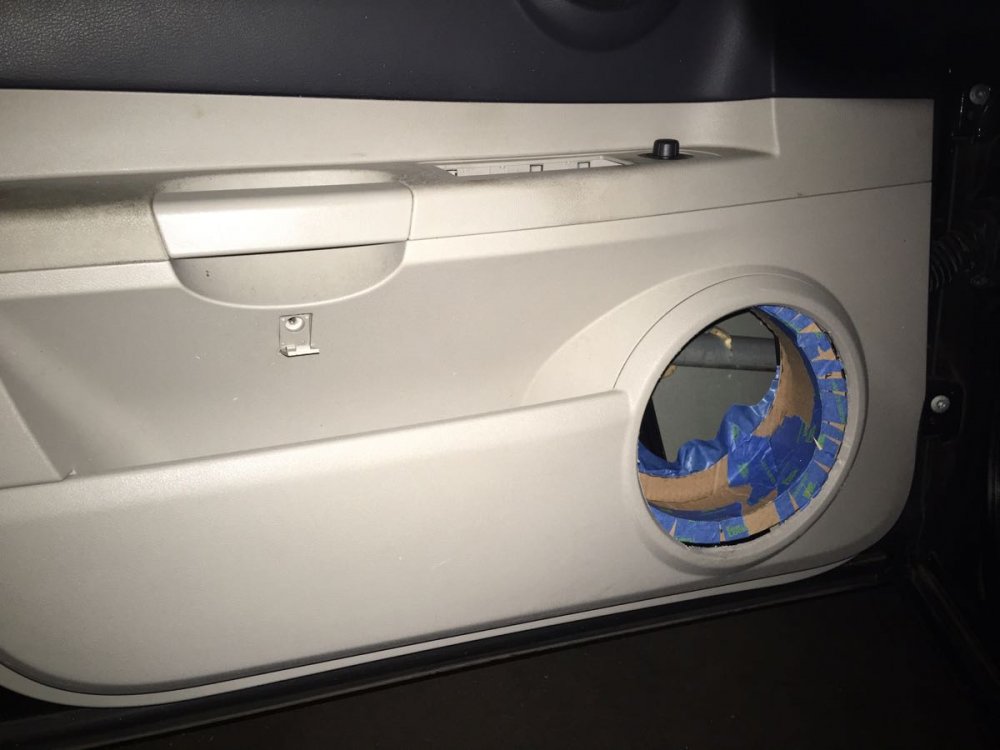

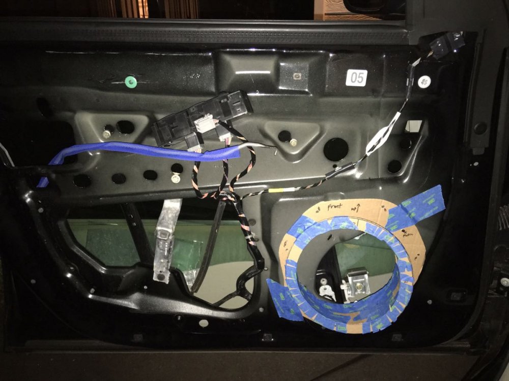

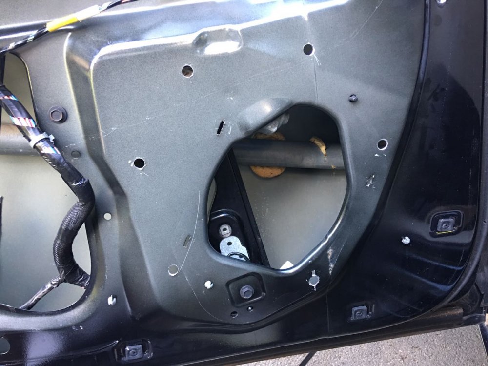

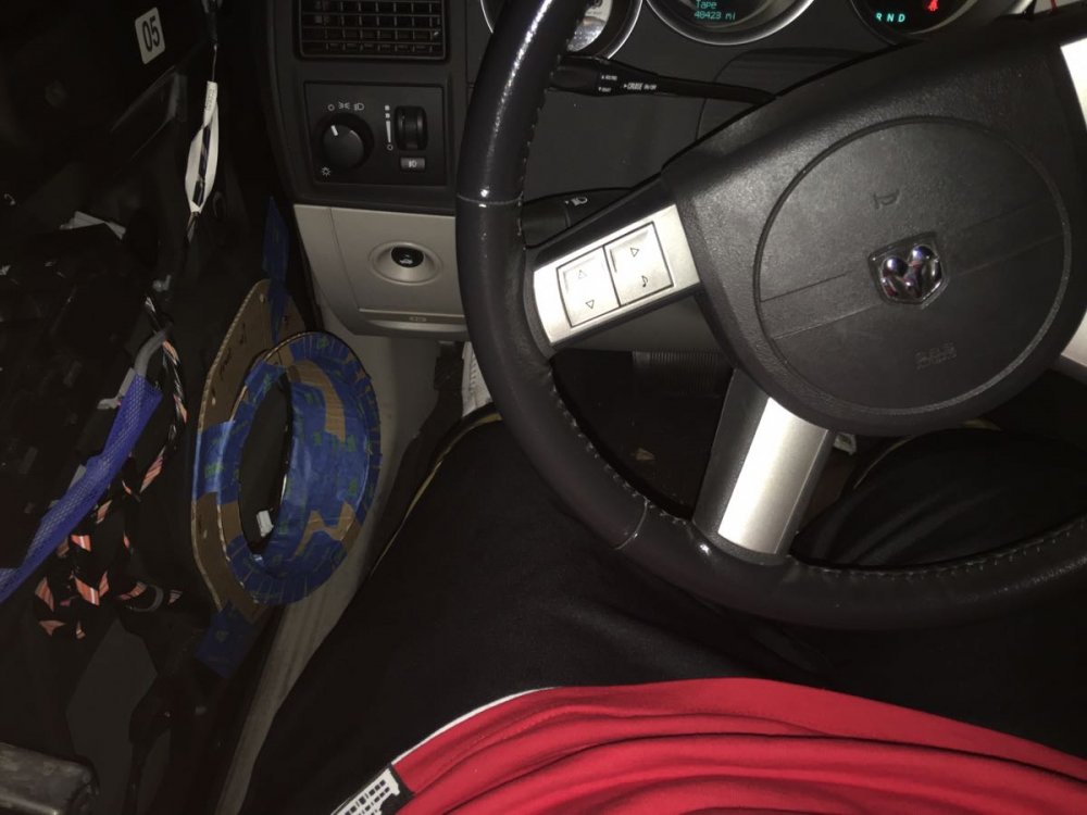

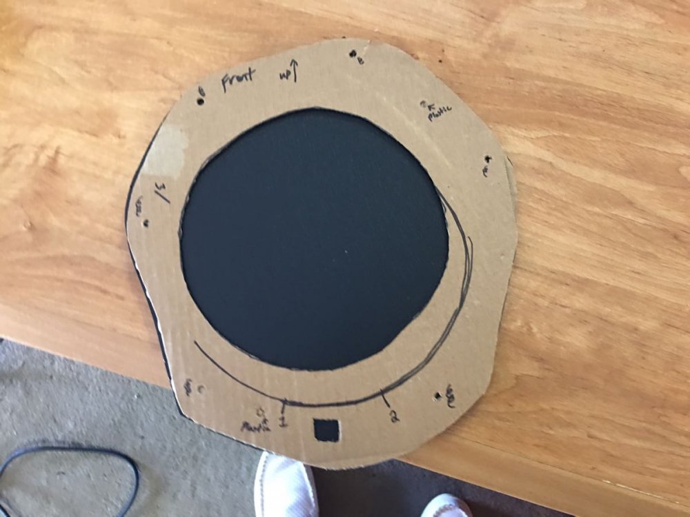

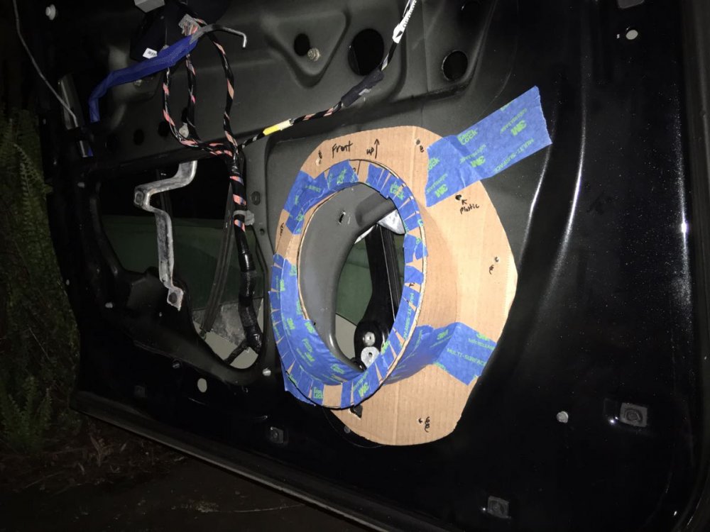

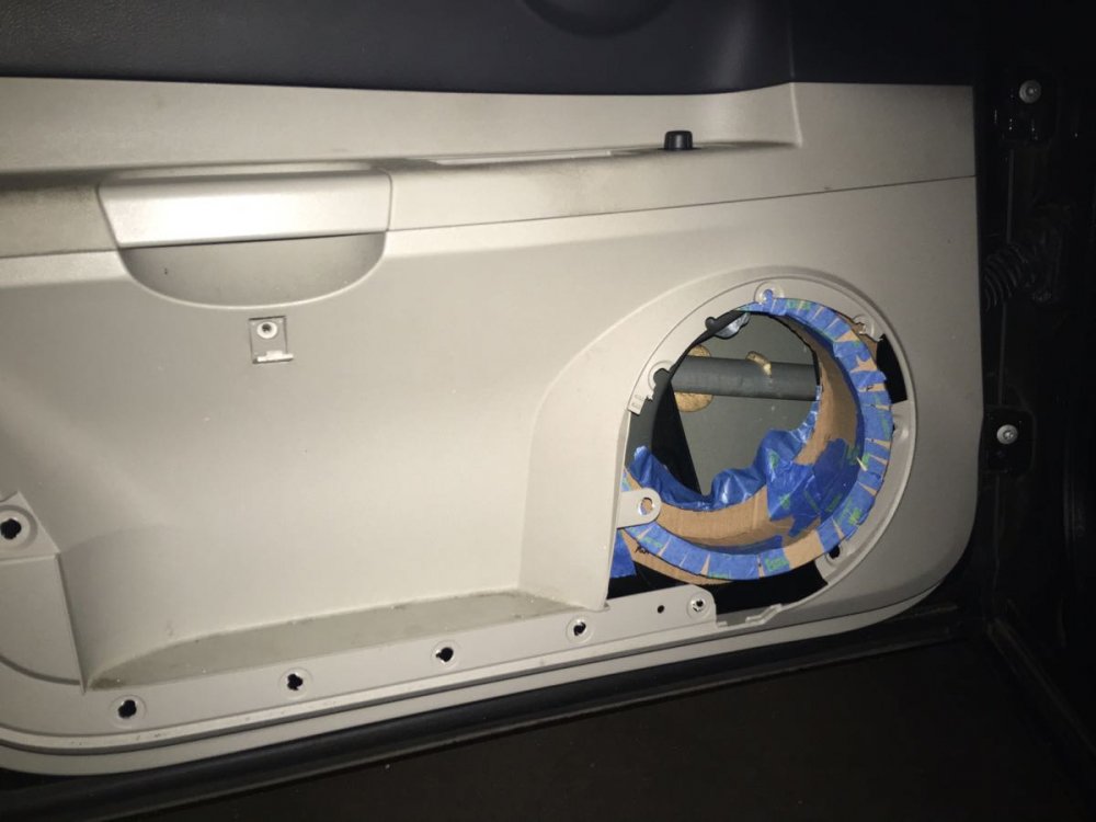

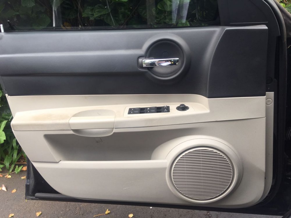

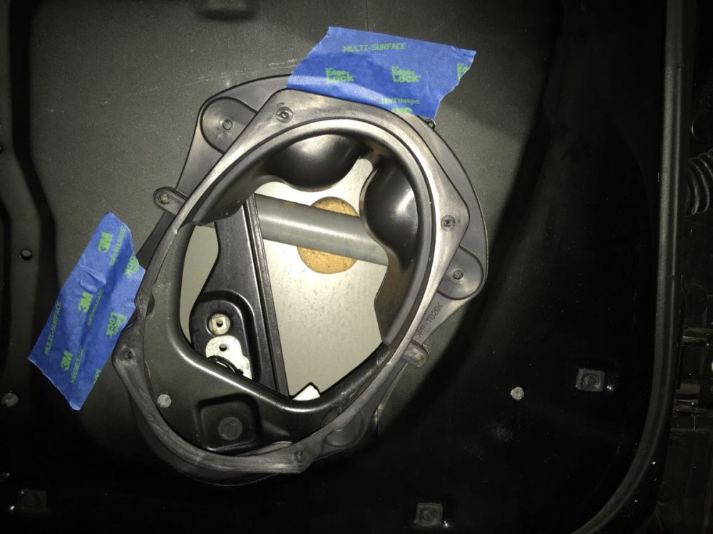

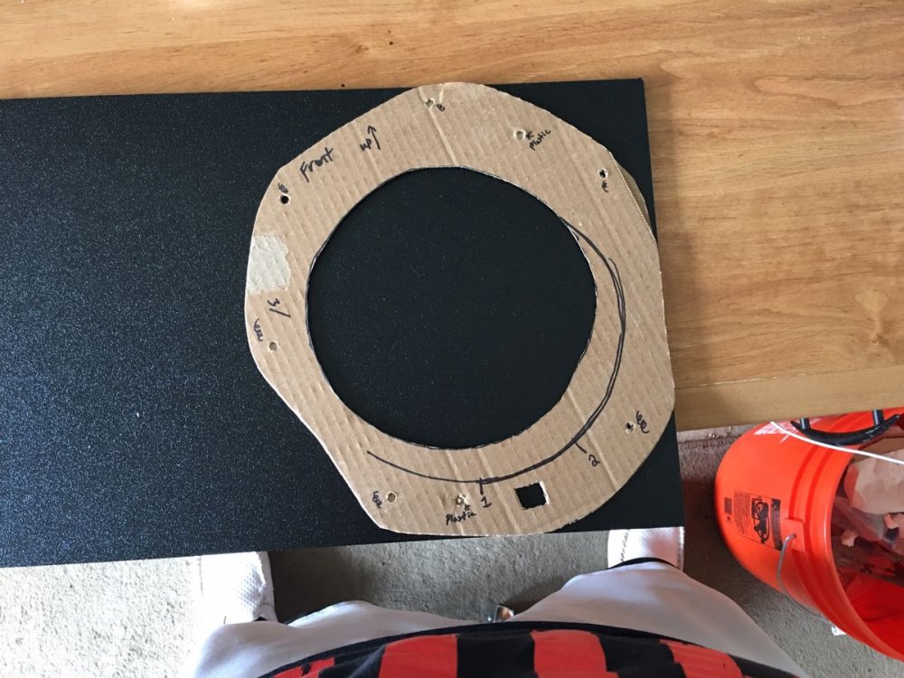

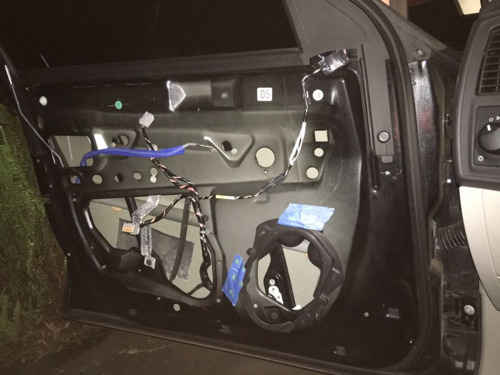

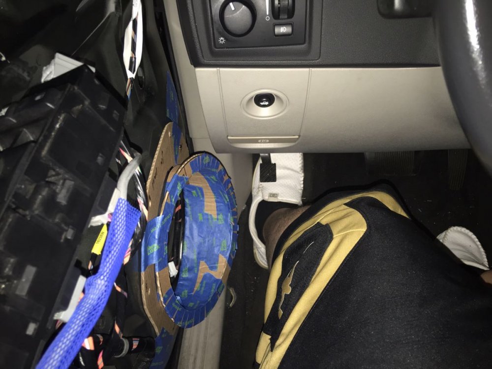

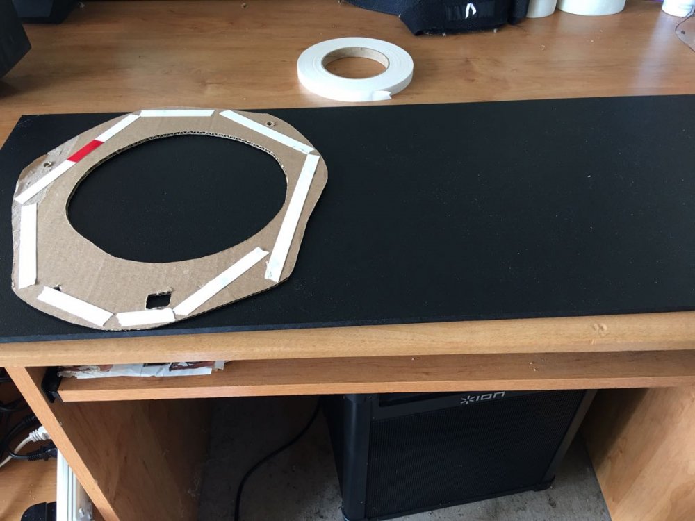

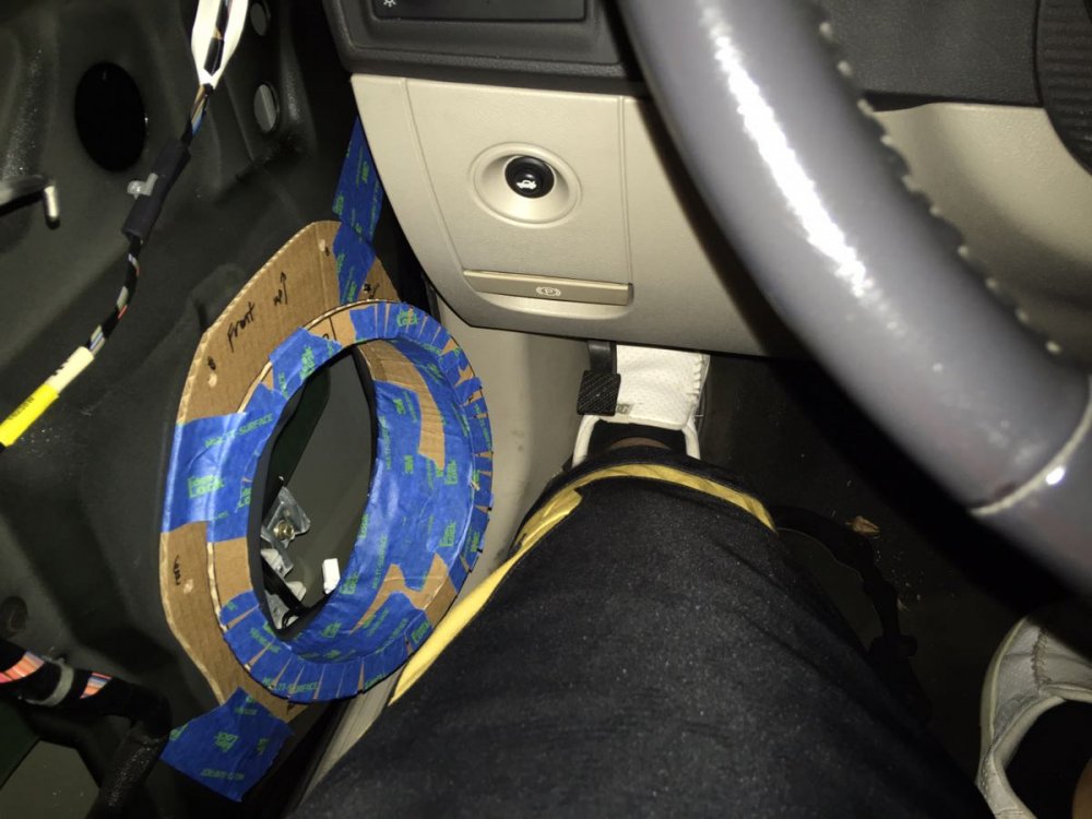

I will be fiberglassing the doors to have a clear path from the speaker. Right now the plastic door panel will block half the speaker. I angled the adapter to have a lil more of an on axis aim.

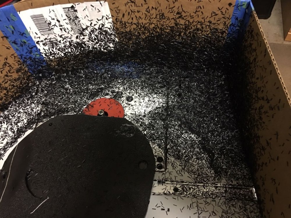

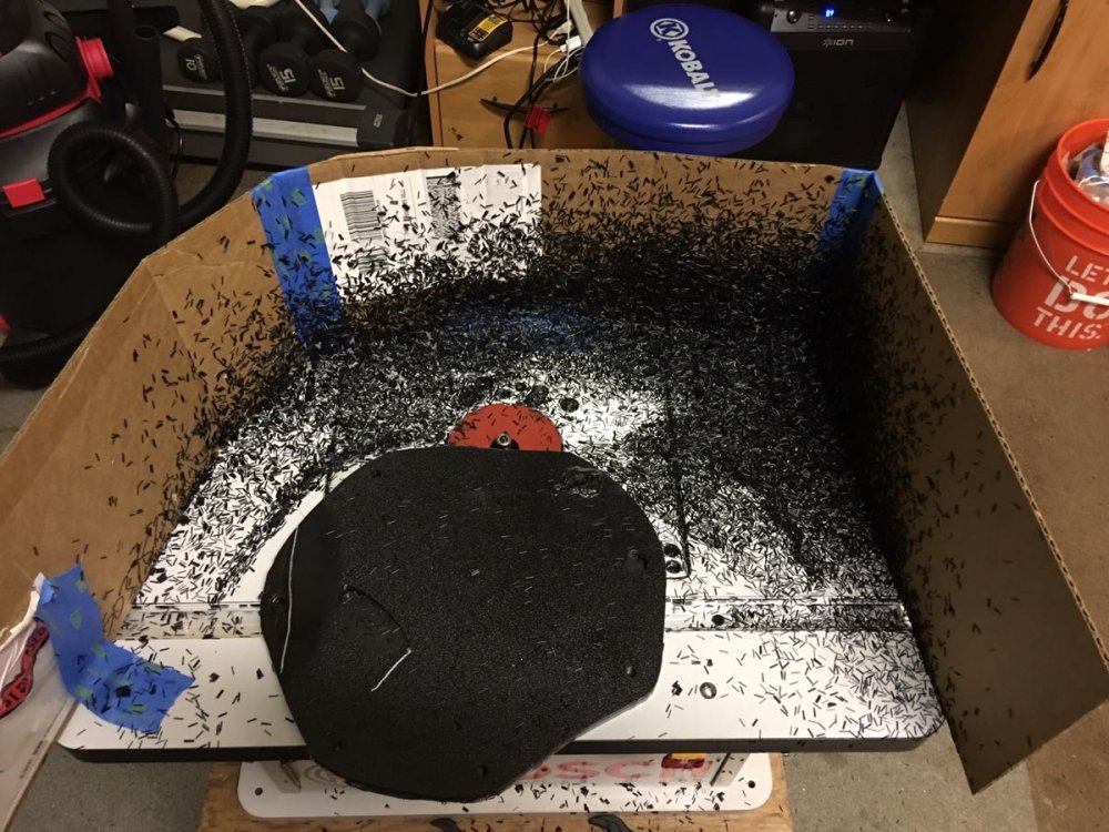

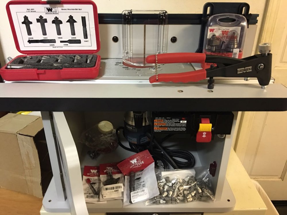

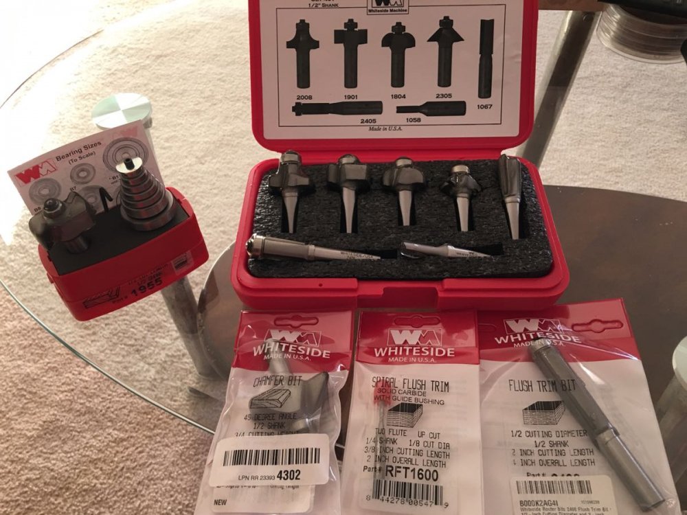

First attempt using a router. Heres my router and table and some bits. So glad i decided to make a cardboard barrier around the edges of the table to confine the mess, for anyone who does this kind of stuff in a multi-use garage, that barrier helps A LOT. Keeps the clean up area very small. If you have a fab shop, disregaurd lol.
