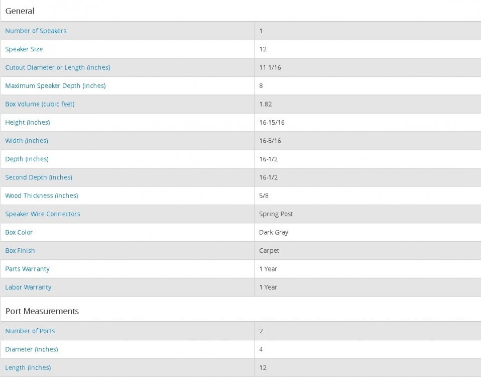

TechnoBass Posted June 5, 2017 Author Report Posted June 5, 2017 Here is the box and the only info I can find from Crutchfield. I would definitely still like recommendations either way on both builds if you could. I've also been thinking about moving up to dual 15's of this same series but first I wanted to try to see what I can do with this single 12 and some other type of box just for kicks. (no pun intended) Thanks for the help.
Triticum Agricolam Posted June 5, 2017 Report Posted June 5, 2017 I missed the part in your first post where you said the box you have now is a bandpass. I assumed it was ported. The only thing worse than a prefab ported box is a prefab bandpass. A well designed and built ported box will almost surely stomp all over that. "Nothing prevents people from knowing the truth more than the belief they already know it.""Making bass is easy, making music is the hard part."Builds:
