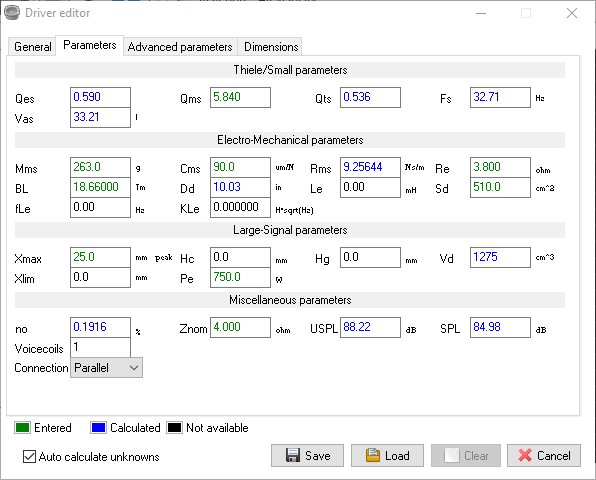

So I replicated the test you did, for the Mayhem 12 I get exactly the same results as you do.  But for the ISIS I do not.  I usually get right around 31 m/sec for the slot port minimum, and right around 23 m/sec for the optimal port area.
I wonder what's different between our two tests?  Is it possible you didn't change the port from round to rectangular in WinISD?
Builds:
I was definitely on square port. Maybe it's the parameters of the sub? I could've put them in wrong. Could you screen shot the parameters you have for the sub in WinIsd?
Sure can.
Builds:
I'm not sure what happened. The only thing really different is my Re and number of voicecoils. The IS12 has 2 voice coils and I used the dual 2 ohm version but besides that everything else is the same. I actually just noticed my Vas is twice what yours is for some reason. I manually entered the Qes as .59 but the Vas goes to 66.42. If I let the Qes autocalculate it goes to .295 and Vas goes to 33.21.
