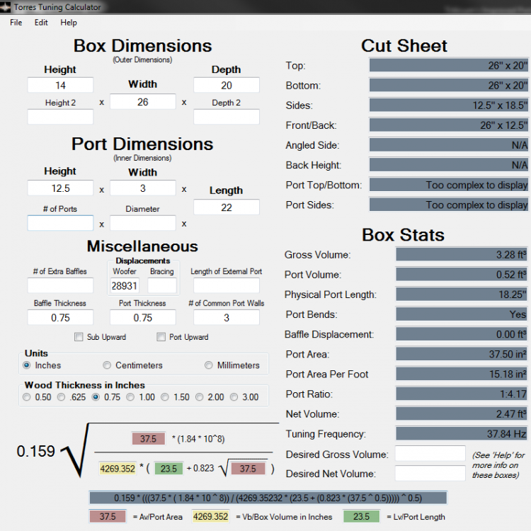

IKnowImLost224 Posted July 14, 2017 Report Posted July 14, 2017 Lol this sounds dumb after I just said it should be stickied, but just so I know for sure. When I'm looking at the Optimal Port Area Required, is that equal to the Port Volume on Torres? And if I went by Optimal Port Area per Cu Ft, would I be looking at Port Area Per Foot on Torres?

IKnowImLost224 Posted July 14, 2017 Report Posted July 14, 2017 I guess maybe because on Torres it's in inches squared, not cubed so my numbers weren't matching up.
Jessica Posted July 14, 2017 Report Posted July 14, 2017 Port volume is cubed. Not area. Rest in peace, walled 87 accord build log 03' Corolla build with AA Mayhem inside. My super random youtube channel and terrible camera work. Wiring comparison by CaptainzPlanetz Wire and fuse guide by Guest SyKo13
Jessica Posted July 14, 2017 Report Posted July 14, 2017 Torres has a field labeled "port area" Rest in peace, walled 87 accord build log 03' Corolla build with AA Mayhem inside. My super random youtube channel and terrible camera work. Wiring comparison by CaptainzPlanetz Wire and fuse guide by Guest SyKo13
reedal Posted July 14, 2017 Report Posted July 14, 2017 1 hour ago, IKnowImLost224 said: Lol this sounds dumb after I just said it should be stickied, but just so I know for sure. When I'm looking at the Optimal Port Area Required, is that equal to the Port Volume on Torres? And if I went by Optimal Port Area per Cu Ft, would I be looking at Port Area Per Foot on Torres? Optimal port area required is not equal to Torres port volume. Volume and area are two different things. Yes to your second question. Triticums optimal port area required is what his calculator is recommending for the optimal amount of port area. More is better, but less will be less than optimal for the power to and size of the enclosure. SMD Tool Map https://www.stevemeadedesigns.com/board/topic/193176-smd-tool-map-new-november-2014/ Build log https://www.stevemeadedesigns.com/board/topic/197217-reeds-03-tahoe-hat-sqaq-singer-xs-shca-cockbox-80prs/?page=32
Triticum Agricolam Posted July 14, 2017 Author Report Posted July 14, 2017 In Torres "Port Volume" is how much space the port is taking up inside the box. It an interesting piece of information to have, but it isn't relevant to how much port area you need, or tuning frequency. Based on the box size, input power, and tuning frequency you have you are going to want at least 57 sq in of port area, and 77 sq in would be better. You are putting quite a bit of power into that size of box and your tuning frequency is on the higher end of things. Both of these attributes increase the amount of port area you need (compared to a lower power, lower tuned box), and this is why the "port area per cube" recommendations are significantly higher than the "12-16 sq in" we often see folks suggesting. "Nothing prevents people from knowing the truth more than the belief they already know it.""Making bass is easy, making music is the hard part."Builds:
