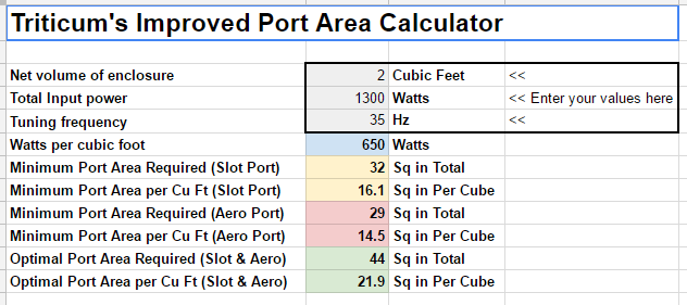

You could get away with as small as a 2.0 cu ft net box.  I guess it depends on how much space your friend has available.  It will take a moderately large size port, but it should still be manageable.  Here is an example:
