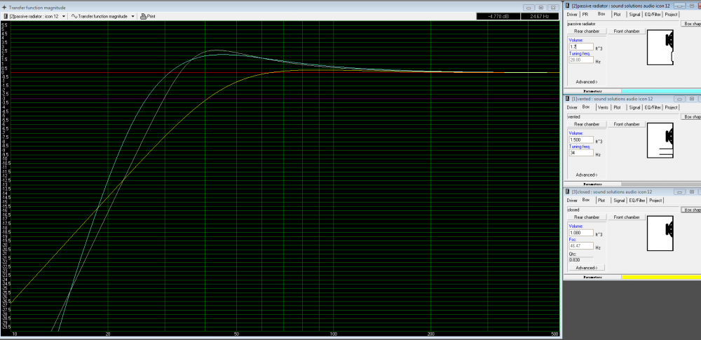

I built a small sealed box for my SSA ICON 12, and have been running them for around 8 months, till recently my SSA ICON shit the bed... AZ HEAT i think. Anyways, I've been talking to PSI a lil, and I'm planning on getting a nice PSI recone for my icon and a high excursion 15 passive radiator from them. I modeled 2 12in prs, and the 15 modeled better, plus cheaper.  https://psicaraudio.com/product/15-high-excursion-passive-radiator/

I used WINisd to model between my old sealed box, a vented box that could possibly be shoved in ma trunk, and a pr box that has a lot mor 20-30hz output and is less peaky. I love them lows, and if I wanna tune it lower, I just need to add more weight to the pr - I modeled the pr and found I like 550 grams extra mass to the cone. 1.7-1.8 ft3 net. At 1.7 ft3 the box tuning is 28.8 hz and the pr tuning is 10hz. Looks like I'm going to have a 7ish db increase, with the old icon specs before the recone. It's running on a us acoustics mike 1500 rms, but I'm thinking of getting the SSA 2200rms monoblock.

5951b5813d3cf_prandsealedandportedboxgraph.thumb.png.35cd93605a01fc7761ce97ea2c79b82a.png
Tuned in to see how this turns out.  If you actually get a response like is plotted above, then thats a big boost on the lows.

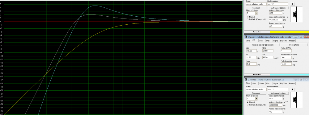

If you ran the PR with less mass, does the plot still look favorable?  Im wondering if 550g is a bit much to add to a PR?  ...But no one really runs PRs in car audio, so Im interested.

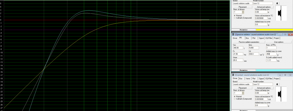

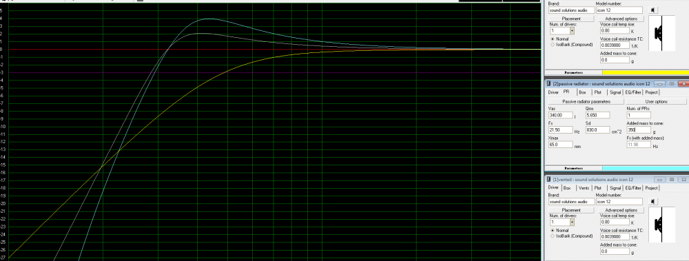

I think I can live with 450g, if 550 doesn't work out, haha. Idk about anything less tho, my hopes are set pretty high, lol. I can make the box a little bigger too, I'd probably have to sacrifice a lil bracing, or wood width, but np.
5951c828b4a06_450G.thumb.png.479d2e236b4d18d9faa57db46ff4e531.png450g350G.thumb.png.83ea3b4e928c7f14776810d2e14af262.png350g300.thumb.png.90a2ea1fb1cfa80e4073c9719e486596.png300g
