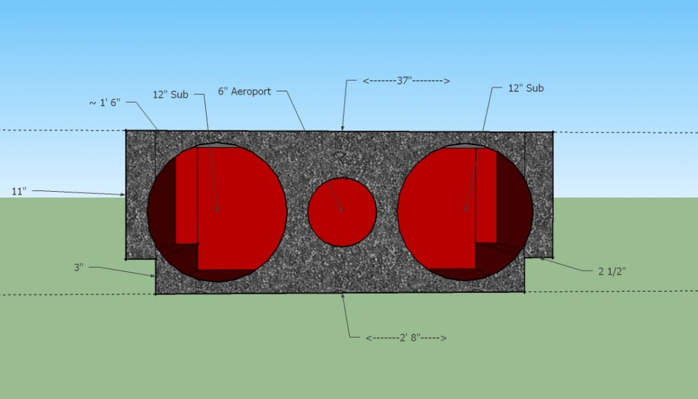

Justin_1990 Posted July 7, 2017 Author Report Posted July 7, 2017 This is the layout I had currently. The shape of the box is extremely important because of my cars trunk floor. It has weird humps on the sides for some unknown reason (dodge charger)
Joe X Posted July 7, 2017 Report Posted July 7, 2017 From your pic I have this: I would just need to make sure what's ypur box depth.
Justin_1990 Posted July 7, 2017 Author Report Posted July 7, 2017 18" outside diameter 16.5 I.d. for depth. Everything else looks spot on.
Joe X Posted July 7, 2017 Report Posted July 7, 2017 For sealed you would do as follows, it's basically cutting you parts in such a way that you get a total external depth of 10": Box Specs: 2.0 cubic feet net, 1 1/4" cross brace front to back.
Joe X Posted July 7, 2017 Report Posted July 7, 2017 For a ported box you would do as follows with the materials you already have, I have used 16.5" as internal depth: Box Specs: 3.1 cubic feet net tuned to 34 Hz. It's a smaller box but still well within Alpine recommendations, pretty sure you will be fine with it and for the most part a better option than the sealed alternative.
Justin_1990 Posted July 7, 2017 Author Report Posted July 7, 2017 Joe that is awesome! Appreciate the help man. I'll go the ported route I still have half a sheet of birch left so don't even need to spend more money.
